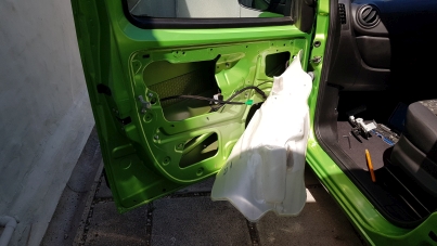

Hi,
I replaced the window regulator this afternoon.
I used a genuine part. The part number is 136331080. Cost about £170 locally(South Africa) :eek:
Not too difficult a job, took me about 30mins...

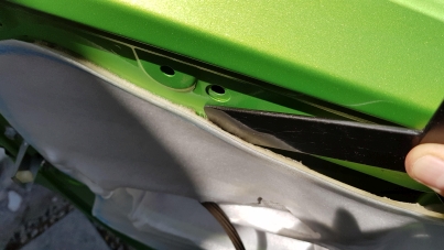

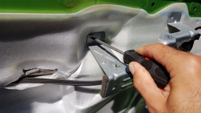

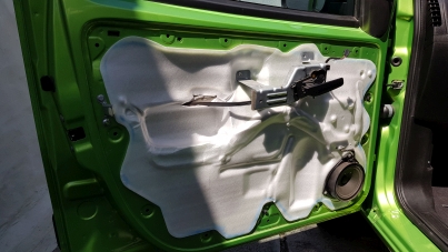

5) Remove the dust barrier. Go slowly, I used my Aeropress plastic stirring paddle.
The “adhesive” seemed to remain sticky enough to be reused, I suppose on older models
you may need to use another method to refit it.
attachment.php
attachment.php

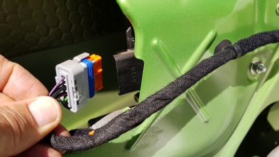

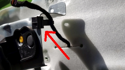

6)Remove the electrical clip from the motor.
attachment.php

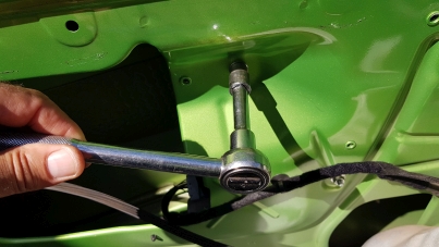

7) Undo the 3 nuts securing the regulator to the door frame…10mm socket.
attachment.php

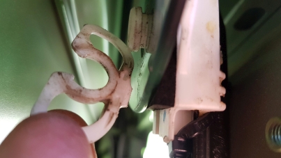

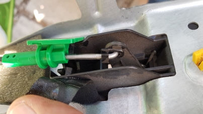

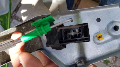

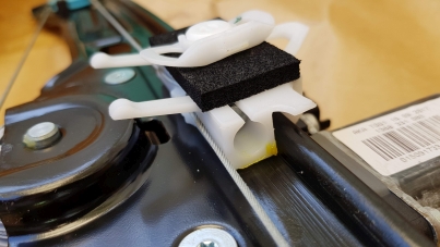

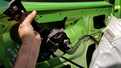

8) Slide the bracket holding the glass to a position where you can access the clip.
Pull down on the ”butterfly” clip and it will slide off. The replacement unit comes with a new clip.
The glass has a hole into which the bracket fits. Remove the glass and push it up to the closed
position. Mine stayed there, you may need to secure it with tape so it doesn’t fall down.
Remove the regulator from the door.
attachment.php
attachment.php

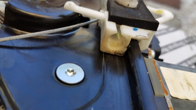

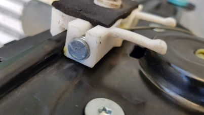

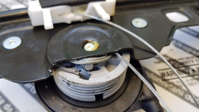

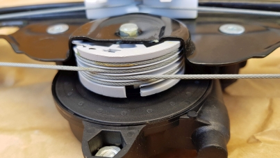

9) Here are some pics of my old and damaged regulator. Cable had popped off one side
and become entangled.
attachment.php
attachment.php
attachment.php

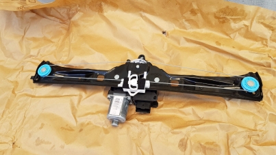

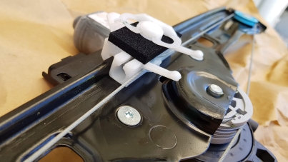

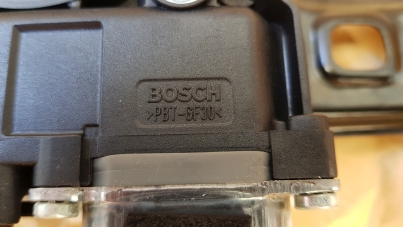

10) Here are pics of the new unit. Installation is pretty straightforward.
Basically the reverse of the removal...
attachment.php
attachment.php
attachment.php
attachment.php
attachment.php
