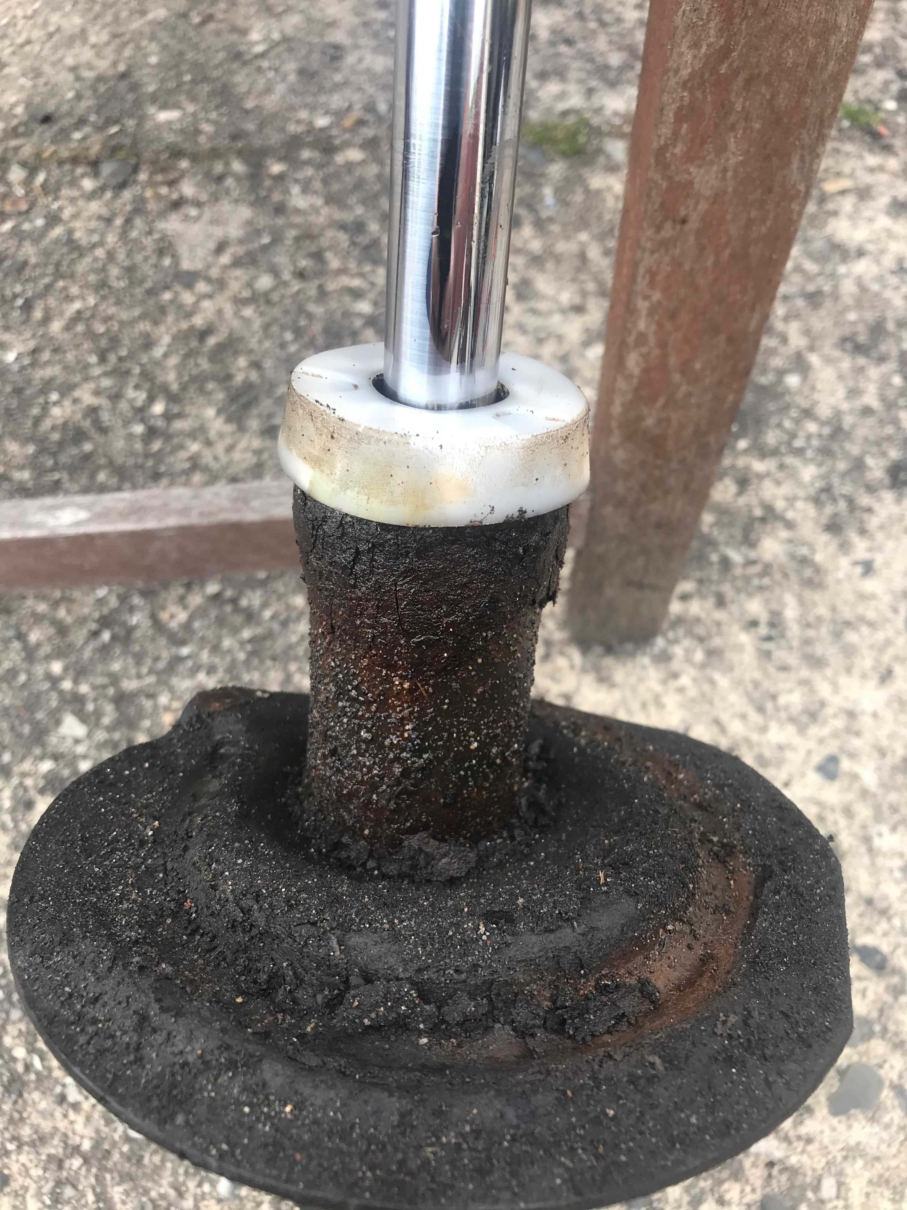

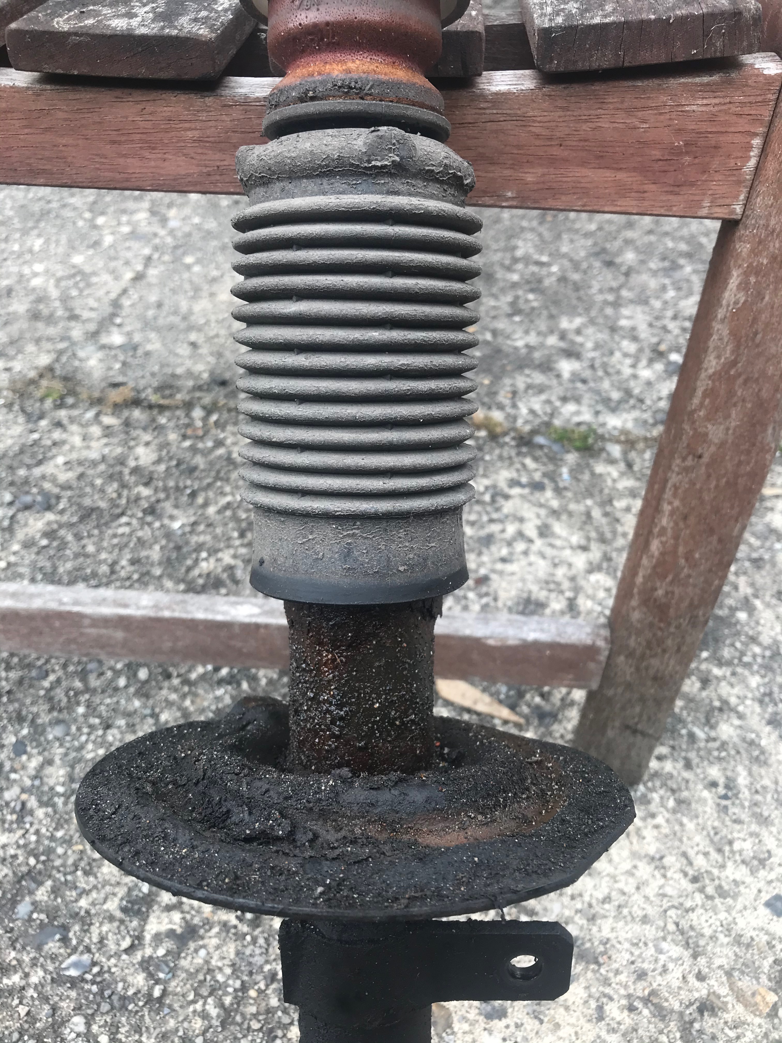

Mrs Dave's suspension feels ok to drive, but nearside strut leaking oil. A pair of Sachs units ordered and job done.
The oil leak was not the seal. Both tops were badly rusted. Perhaps I should have painted the new struts.

thats a lot of oil for a shock ??? Its quite thin oil ???
Everyone I have done front or rear has always leaked down one side not evenly around.
its almost like it was sprayed it with engine oil to stop corrosion by a previous owner

The other side was dry but almost as badly corroded. I have not seen that before. It leaked due to corrosion around the top of the shock the seal is actually ok. Amazingly the shock damping was hardly any worse that the other side.

Mine had rotted around the top below - the seals were fine. I can only assume it was the rather stiff cover bellows rubbing the paint off the shock top. Clipped on rubber bellows seals would be better if anyone can find something suitable.
