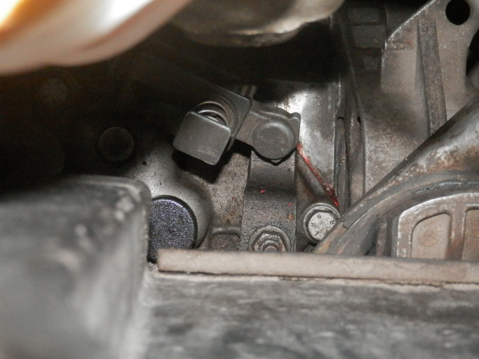

1. If you remove the gear cables you can select the gears quite easily by moving the levers on the gearbox.
But
2. With the cables connected reverse gear is only possible if the plastic piece under the knob is raised before you try to move the gear knob back into reverse.
If you move the gear knob left to right in neutral it feels like there is an equal amount of movement from left to right compared to the middle position where you are not fighting the spring. There is a hard knocking stop on the right. If you then lift the plastic piece under the lever there is much more movement to the right and you don't get that hard knocking stop on the right. The hard knocking stop is caused by the mechanism just under the gear knob.

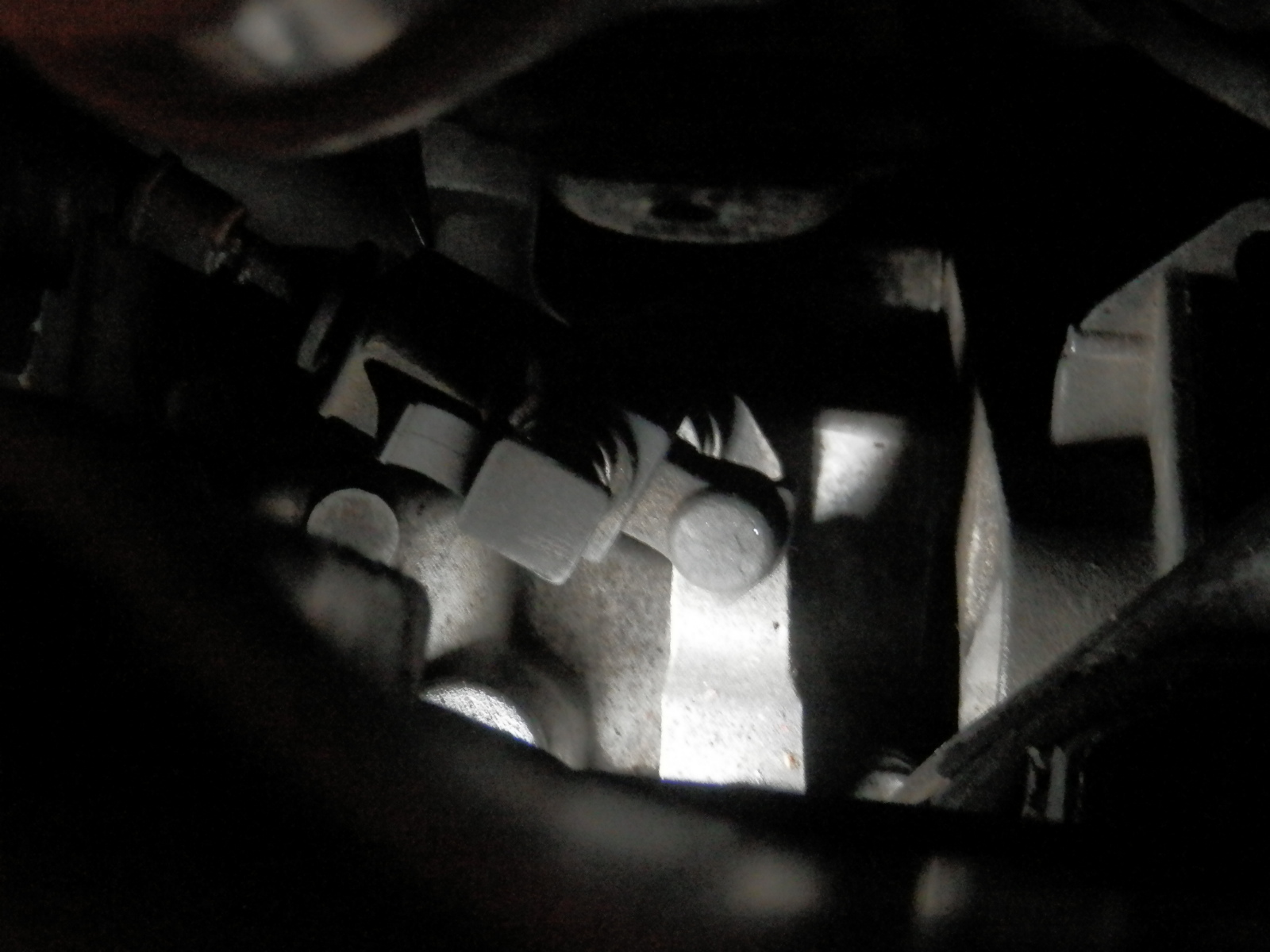

I have photographed the position of the levers for reverse gear.
The top lever gives you the left right position of the gear knob inside the car.

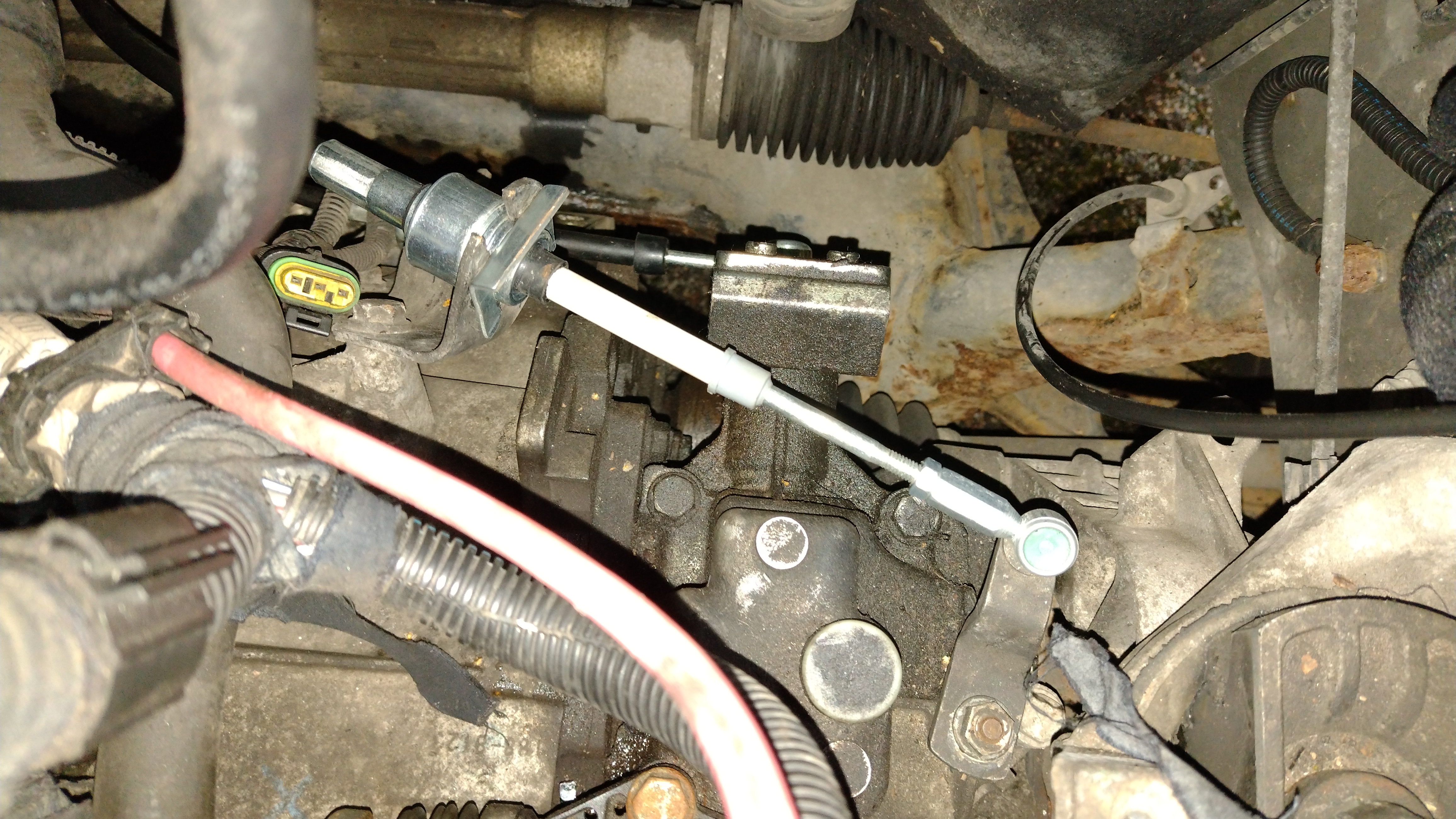

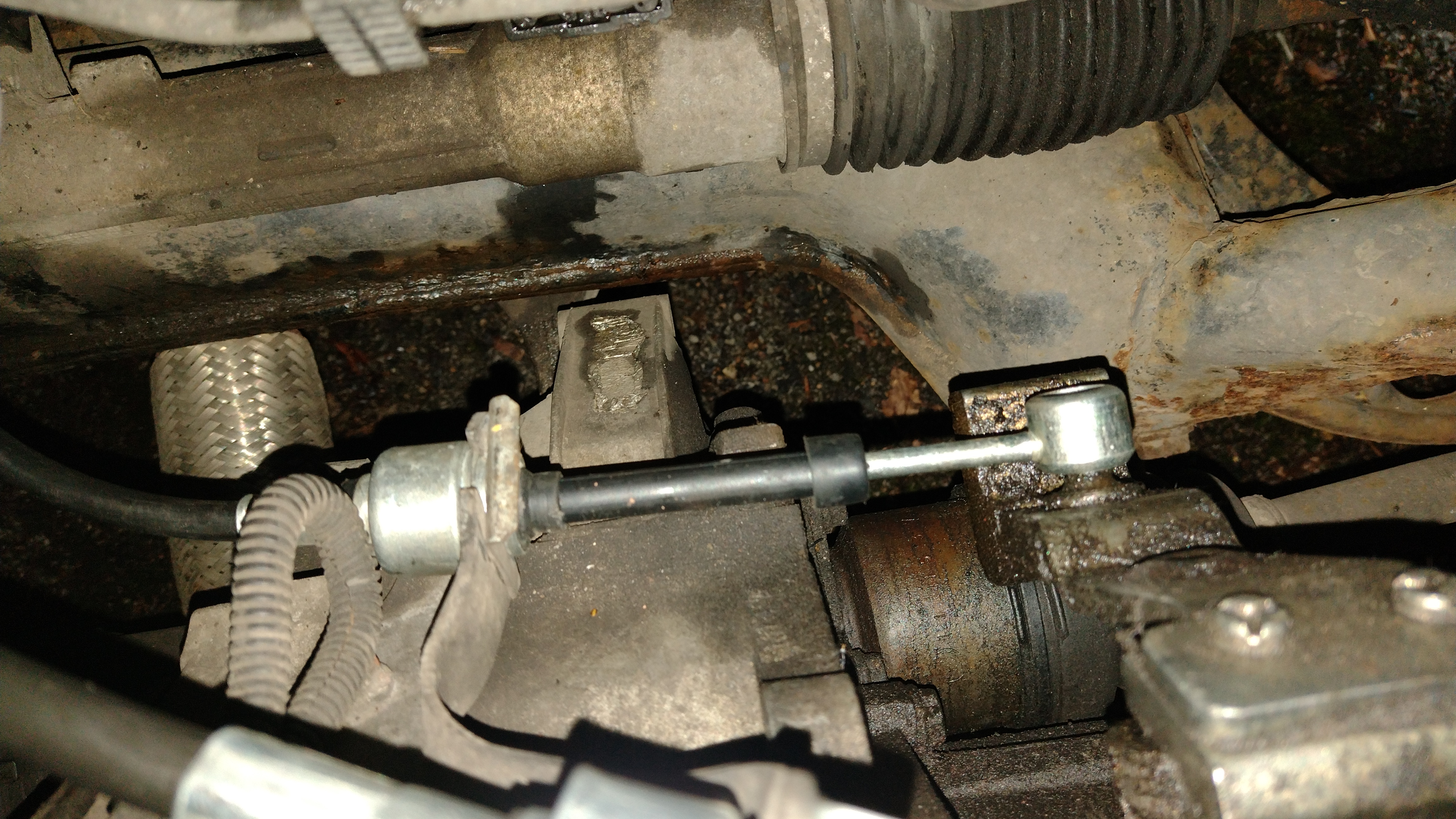

Thank you so much for the reply Judderbar, and for providing pictures too it's really appreciated. Sorry I just want to make sure I'm understanding this right - When I go right on the gearbox I do have to lift the gear knob to reach gear 5. Does this mean I need to re-adjust the top lever cable?
Sorry to bump this thread, just wanted to add a couple pictures of the cables but I think it's been too much time to edit my message!

I see you have that adjustable top cable.
On my car the lever is almost pointing exactly backwards (not quite) if you are knocking against the reverse stop under the gear lever.
That might be your problem. The cable needs to be shorter using the adjustment.
Which might explain why you are talking about lifting the gear knob to get 5th - you are already hard against the reverse stop before you can select 5th.
To be clear to get reverse you lift the lift the collar under the gear knob. You dont lift the gear knob to get any of the gears.

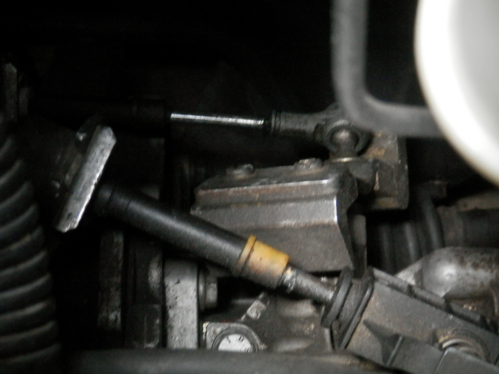

In these pictures the car is in neutral with the gear lever tightly pulled to the right without lifting the reverse collar.
The camera is not straight onto the gearbox. In reality the lever is only very slightly not quite reaching pointing backwards.
Judderbar you are a legend. I was able to get in to fifth and then in to reverse by lifting the collar as I shifted. Thank you so much for your time and help, I appreciate it immensely.
