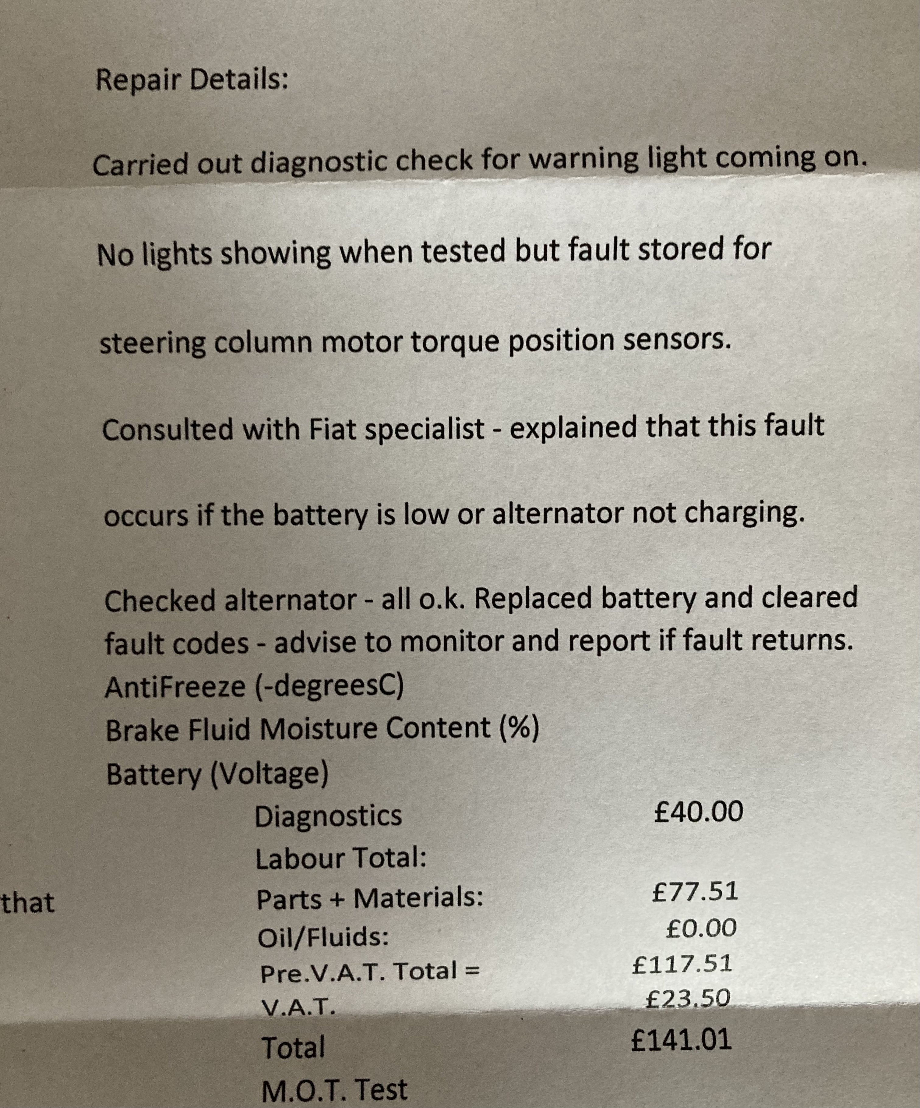

I replaced the battery on our 1.2 but the effect was temporary. The alternator was charging because we never had a flat battery, but when I checked the voltage (while driving), it was sitting low for a long time. The replacement immediately gave a better voltage and the steering warning light issue stopped for good.
For those interested, this is what the report came back as.

My trusty friend has returned - time for new battery I guess. Is it usual for older cars to need batteries replacing so often? Admittedly, my car is only doing short journeys a lot of the time.
I did however notice that within my breakdown cover I am covered for battery replacement, so have called them this morning.

Had a quick skim read but have to ever had the main earth cables changed?
When there corrode they can give lower voltages then they should be which can causes issues like steering faults

simple answer NO
should be fine for a few years. As long as the car gets a run out every week or so. lead acid battery dont like being left for long periods
A one off could just be a glitch. I wouldn't be too concerned until it happens again
But worth doing some basic checks. Is the alternator belt tight ! does the battery connectors look clean ! are they tight !
at least 3 people have had success by plugging the battery overnight to a battery charger over night.
Well both battery and alternator are charging, cables are all good and earths are all good - the guy tested everything for me. So, he's cleared the fault (our good old friend the C1002 torque sensor code), but seemed surprised that i had no juddering of the steering or that nothing cut out - so he was a stumped as me.

He checked the alternator, no issues with that either. It's like there's a glitch in the system but actually nothing wrong with the car.
My panda 100hp will put the PAS light on if i haven't driven it for a month or two, but only ever the once on the first start, then it goes away never to return unless leave it parked for a while again. I've never worried about it myself, just one of them foibles of the car in my experience.
Further to which if there really is a problem with the torque sensor you do have issues with the PAS, we've had a mk2 punto that was totally fine but if you turned the steering all the way to full lock it would sometime put the PAS light on and the PAS wouldnt work until you turned the car off/on again, always the same error of torque sensor. I replaced the torque sensor and it never happened again. And on that train of thought, in the panda if i do leave it and the light comes on it usually goes straight out again if i turn the wheel all the way to full lock - Italian weirdness at its finest :shrug: although i've not had it come up in a long long time and the car does sit for a week or so quite regularly.
So without reading the whole thread back again i suspect there is very probably nothing wrong with yours if you don't use the car all that often - fiat and garages seem to tell you that replacing the torque sensor means a whole column but it doesn't - you can source a torque sensor on its own, no too difficult to change but do have to take the column off to do it and needs calibrating after (MultiEcuScan can do it).
Battery wise, it should last at least 5-6 years in my experience, might be a parasitic draw somewhere perhaps. You can test it with a multimeter quite easily, put the meter in DC current, disconnect the earth from the battery and put one side of the meter on the earth lead and the other on the battery -ve terminal and read the current draw - there will be some but it should be negligible, if there is current you can then start pulling fuses one by one and seeing what circuit is drawing a current, a dirty and poor connection on a circuit thats permanently live with cause a higher current and drain the battery. Again that mk2 punto had this and it turned out to be the switch panel on the dash, it had clearly got water or something on it and i just wiped it all clean and fault disappeared.
