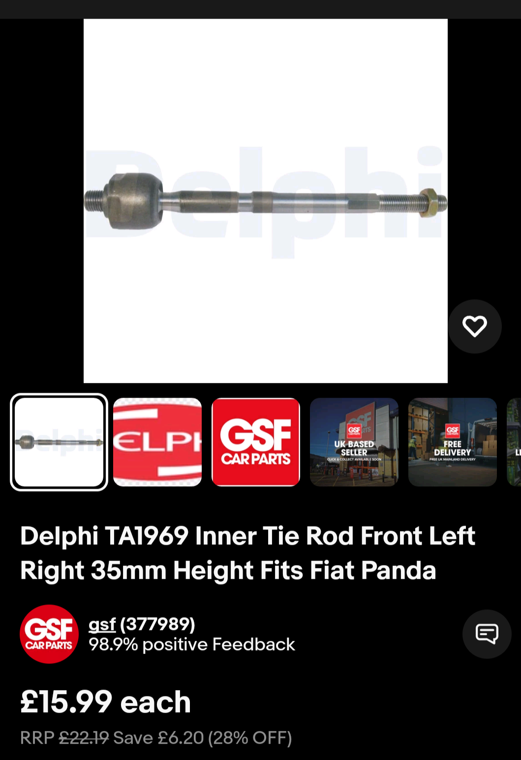

No
They are replaceable, screwed on to the rack
They start at less than £10
Have you got a link to brand new racks? It’s not the tie rod that have play, I’ve checked then already as that what I initially thought. But it’s the actual rack itself that got up and down movement
