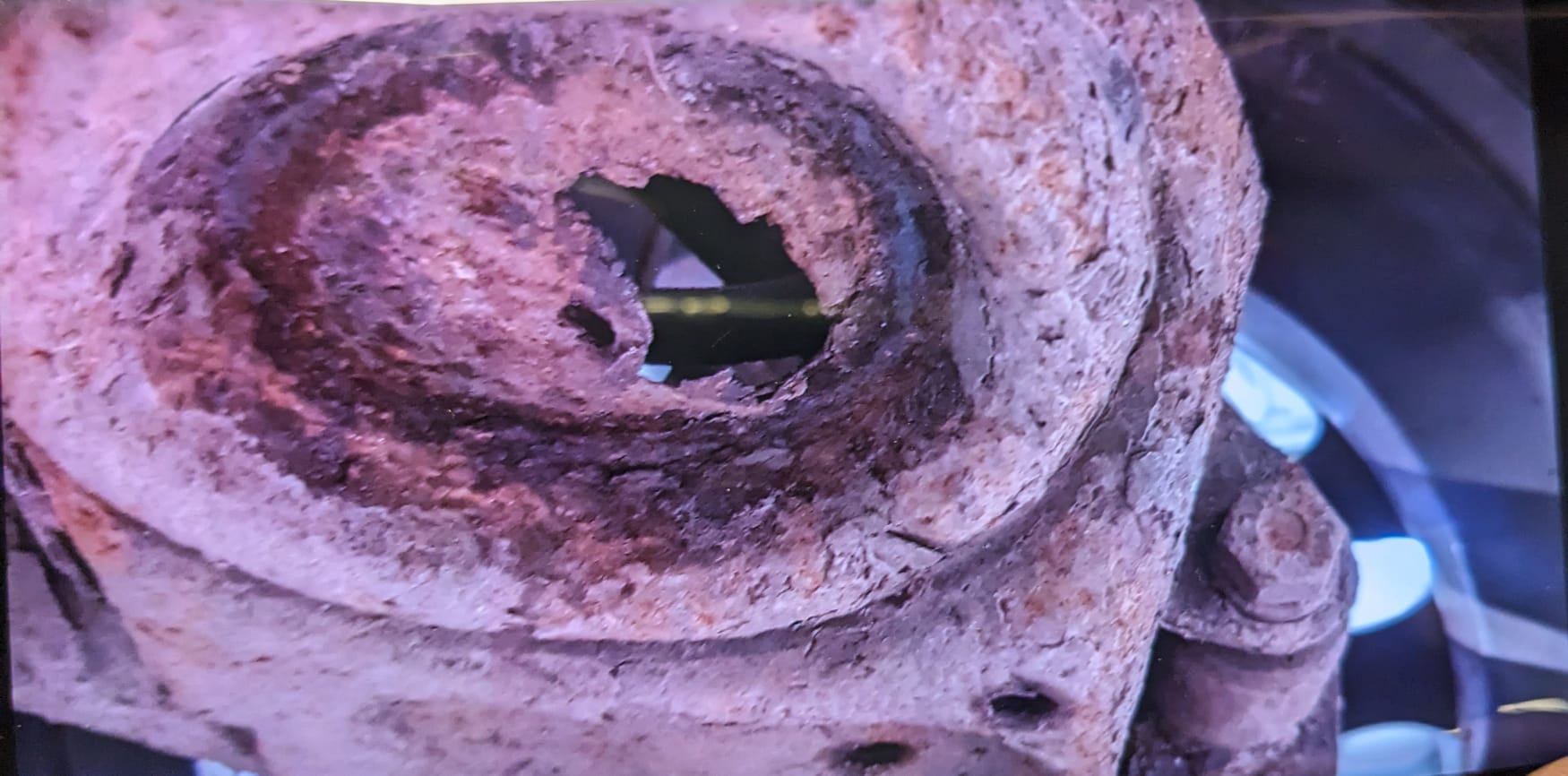

I bought a fiat 500 two days ago, the seller (a trader) has gone AWOL and I am left with a car that has failed it's MOT.
I paid £3k for a 2011 fiat 500 and it has a number of major MOT defects
1. Suspension Spring mount corroded (I think rear) please see photo of the issue [5.3.6(a)(ii)]
2. Engine mil inoperative or indicate a malfunction [8.2.1.2(h)]
3. Electronic power steering, system malfunction [2.6(a)]
In your opinion, how much would you think it would cost for a garage to resolve these issues? Am I just throwing good money after bad?

As to what the repair will likely cost, it's certainly going to need a new rear beam and all the other failure items will need to be sorted also. Without doing a detailed inspection it's impossible to give even a rough answer, but paying someone else to fix all of the problems will likely cost a substantial amount, likely thousands rather than hundreds.
Whilst a competent and enthusiatic DIY owner might be able to turn this into a useable car, as a trade project, the car could very well not even be worth repairing economically. Its true value in this sort of condition may only be a few hundred pounds.
Whilst a competent and enthusiatic DIY owner could likely turn this into a useable car, as a trade project, the car could very well not even be worth repairing economically. Its true value in this sort of condition may only be a few hundred pounds.

I’d expect to pay £500 maybe more for a new rear axle installed, I would not have it welded

Power steering malfunction, not sure but probably two things bad battery or flat ( £60, don't bother with a stop start one ) AND new engine earth strap £5, possibly £30 to fit
EML at start up, if it does not come up on the dash before start up that suggests the dash has been knobbed to hide another issue probably Lambda if the car runs normally, this could be somewhat more expensive? Start here FIRST, does the EML( engine symbol light yellow on the right of the cluster ) come on before you start the car?
Rear axle try to get it welded in order to pass only once the other issues sorted, worst case new rear beam as above £500

Hi welcome so you have a bad situation that's not your fault, assuming you have no alternative to fixing it yourself or loose everything lets look at the possible fixes?

I have just tried the car, and when I put the key in the ignition and turn it once (i.e the engine is not on, but the error lights are on) the engine management light (eml) is on.
When I then turn the engine on, the eml remains on.
From your initial response, and from another respondent, it appears £500 to replace the rear cross member thing, and possibly another couple of hundred for battery, earth strap.
I think there is an issue with lambda sensors, looking online there appear to be two, costing a couple of hundred pounds. I guess a further £200 to fit.
So does about £1,100 for that type of work sound about right?

But thank you for candor, I reckon your guess of £500 for a rear cross bar thing is probably right.
As you have had it MOTd and you know the problems the next step is to weigh up what's best. You could sell it to wbac, and get your £1200 and now you are £1800 out of pocket and still need to buy another car. which could be another £2-3k and your new car has cost you getting on for £5k.
You could ask the Garage who did the MOT to quote you for the repairs and see what they say. If it only cost you another £500 for the repairs and you have a good car, then that would be a much better deal then selling it and trying to find something else, and bare in mind any replacement could also need repairs.
I think you may be better to deal with what you have than jump out of that frying pan and potentially into the fire.
Plenty of people on this forum have had similar problems with this type of rust so may be able to advise better on the cost of repair.
Problems with the electric power steering and MIL light, need diagnosis so it may be worth spending £50 to get the codes read from the car's computers and tell you what the problems are. then you can make a better choice as to how much these things will cost to sort out.
There are loads of these cars about so good used parts are readily available to help save some pennies
Right now we just don't know. I'd say that's a minimum figure; my guess is that it could be more. Until you get a quote for the cost of making it roadworthy, it's impossible to say.
If we're to advise you better on the merits of selling now vs repair, it'd be useful to get a look at the car's MOT history. You can download this for free from this government website. If you post what you find, we'll be better able to help.
