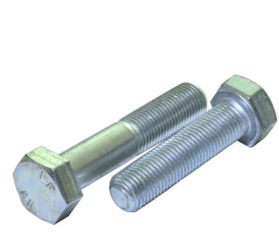

Many thanks for this! Went to Fiat dealer and they have ordered me some for £20 posted. Bit more expensive but should be ok.Bolts check the size but Ebay your friend
Maybe this just a guess
M12 x 1.25 Metric Extra Fine Bolt & Sets Hex Head 8.8 High Tensile White Zinc | eBay UK
HEXAGON HEAD BOLTS SCREWS SIZE M12. HIGH TENSILE STEEL 8.8 GRADE. THREAD PITCH WHITE ZINC GALVANIZED. Bolt Length Does Not Include Head. HEXAGON HEAD BOLTS SET SCREWS. HEAD HEIGHT SPANNER SIZE.www.ebay.co.uk

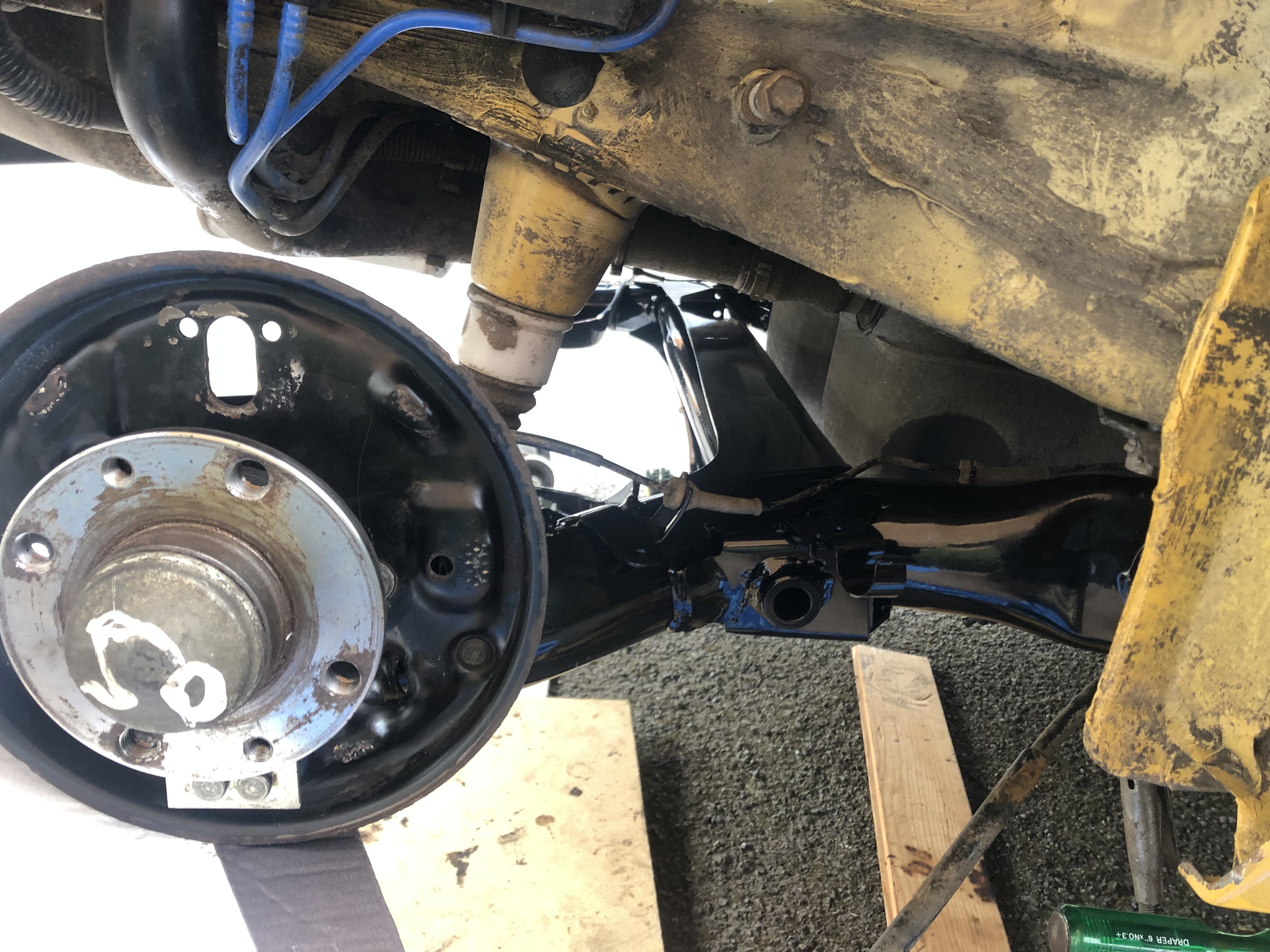

They just tapped out so hopefully still work when I reconnect. Incidentally, the stub axle, I have removed the 4 nuts but it still wont remove from the axle, is there something I have missed?As you need to move the whole hub over I left the abs sensors in place rather than break one?
It will outlast the car so possibly no I didn't do ours, or not until fitted you don't want it all slipperyThanks all! This thread is great! Should I waxoyl the new axle when fitted? Still waiting for bolts to be delivered from Fiat, so at a standstill at the moment![]()
That or a spray over with a can of stone-chip, paint to keep water and road debris away!It will outlast the car so possibly no I didn't do ours, or not until fitted you don't want it all slippery
IM do an affordable replacement for the 1.4 500 axle (just select the disc brake option), so probably not worth the effort of trying to salvage a marginal one.I've a 2008 1.4 scrubbed up but worn (corroded) axle.
Bit thick maybeIM do an affordable replacement for the 1.4 500 axle, so probably not worth the effort of trying to salvage a marginal one.

Trouble is when you fit a nice new part it shows up the rest dont it!"It’s finally fitted! Yippee! However, bit of modification is needed on the offside bottom shock absorber mount, they don’t line up but only out by a little, so file a bit and it fits! Great axle from IM! I am so pleased! Just waiting for my springs to arrive!
