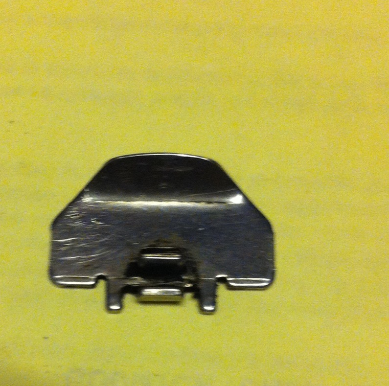

While checking brake shoes on my daughter's 2nd hand ' 53 plate panda 1.2 I found a "stray" brake part lying inside the brake hub. See attachment.
I think it is part of the self adjuster mechanism. I think it fits into a spring plate behind the hydraulic cylinder, but access is tricky to say the least. I can't get it firmly back in place. :bang:
Can anyone advise how to do it?
Is there an alterative to taking the whole wheel bearing off to get access?
On the other wheel the same part was completely missing and had been replaced with a tie wrap around the threaded section to prevent it retracting.
Thanks
YES - it is part of the self-adjuster,
you SHOULD be able to get it all free by removing the shoes,less bother than disturbing the hydraulics.. sounds as if you would do well to get 2 x new assemblies though..

Thanks varesecrazy, that was great advice. Job completed without any more sore forehead!! Thanks again.

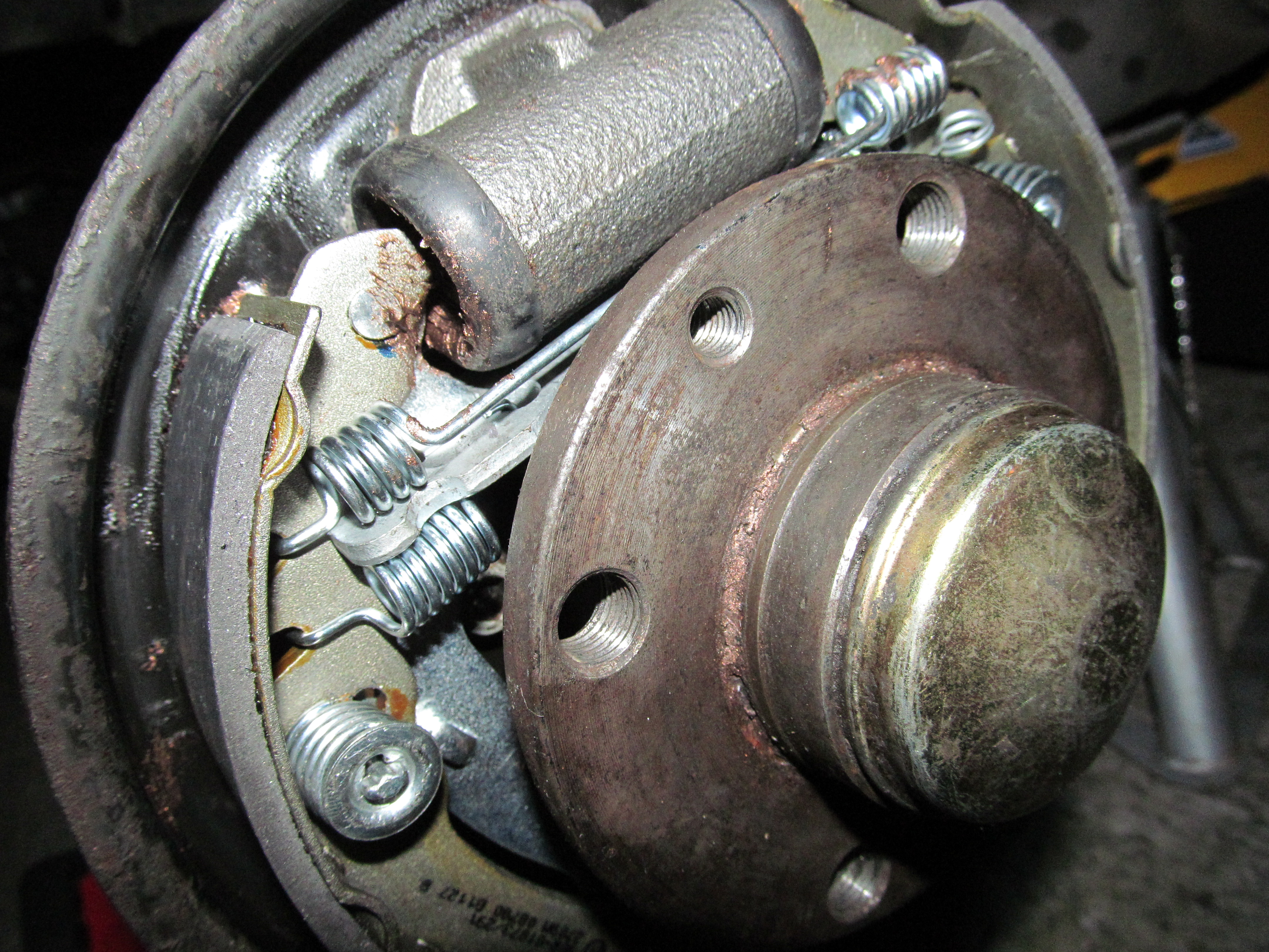

Thread resurrection time! Only because the same piece as in the OP's picture just fell out of one of my drums! And I didn't take any pictures...
With typically brilliant timing, on the way to my MoT last year, I noticed my right rear brake squeaking on every wheel revolution. It passed with one advisory for slight binding on that brake.
I took the rusty lip off the inside of both drums with a wire brush on an angle grinder. The right rear drum was hard to get off because of this lip, so I was hoping it was the rusty drum that had caused the binding.
Recently it started squeaking again, on every revolution. The drum was also noticeably warmer (not hot) to the touch than the other side after a drive.
I found a few old threads suggesting a sticky adjuster so figured I'd try freeing it up.
As soon as I started poking around, I noticed the arm at the back of the adjuster (numbered 5 in diagram) was loose and flapping about.
Trying to disconnect the adjuster spring from the shoe, a small piece fell out of the drum! This turned out to be the pawl (9) for the ratchet wheel (3).
So, springs off, shoes out, brake cleaner, copaslip, pawl re-attached (fiddly), adjuster wound back and all back together again:)
Seems fine now, but I'm thinking it might be time to overhaul the rear brakes before too long. Those adjusters are strangely expensive...:(
...but then everything else is amazingly cheap!:D
