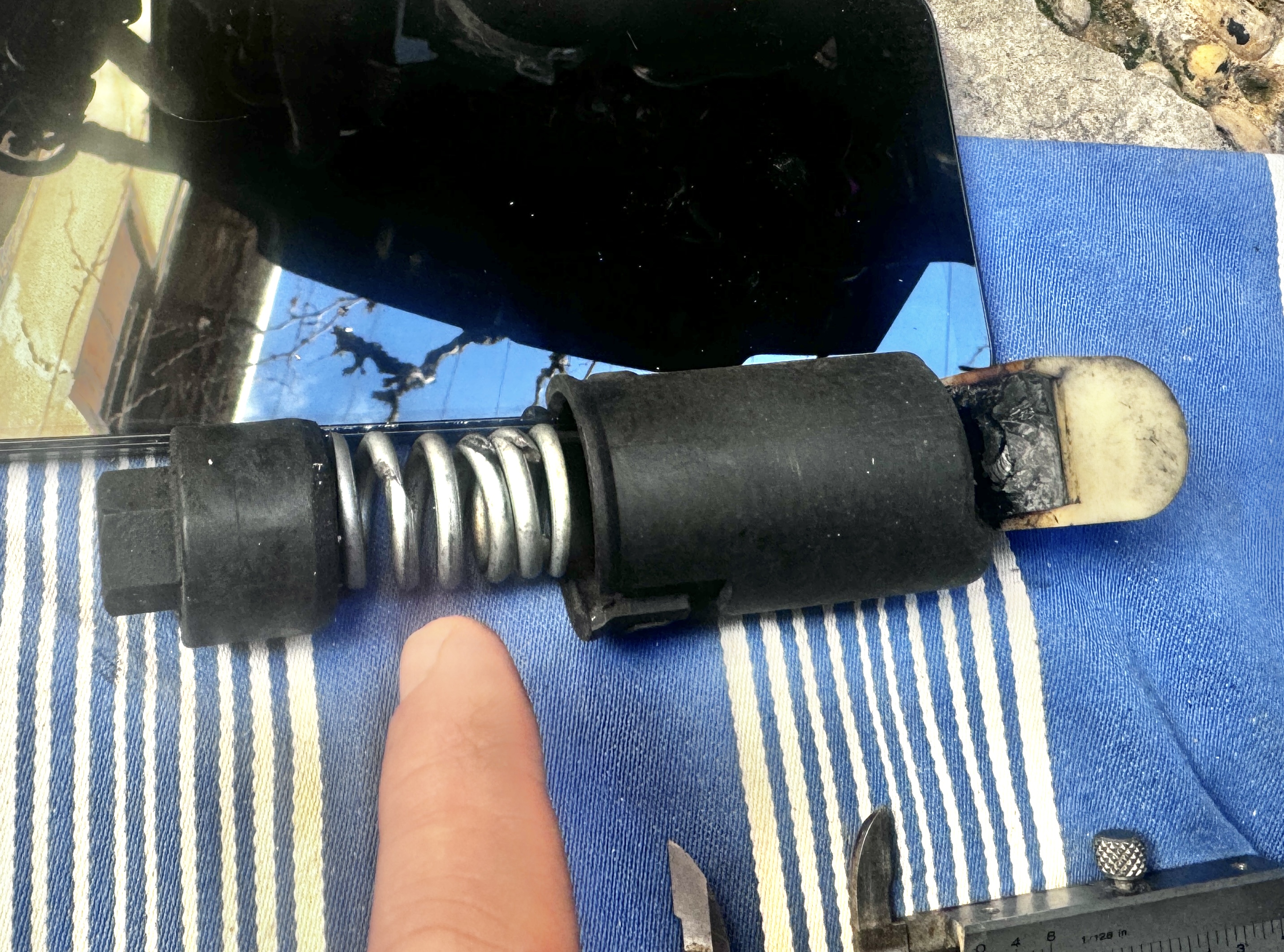

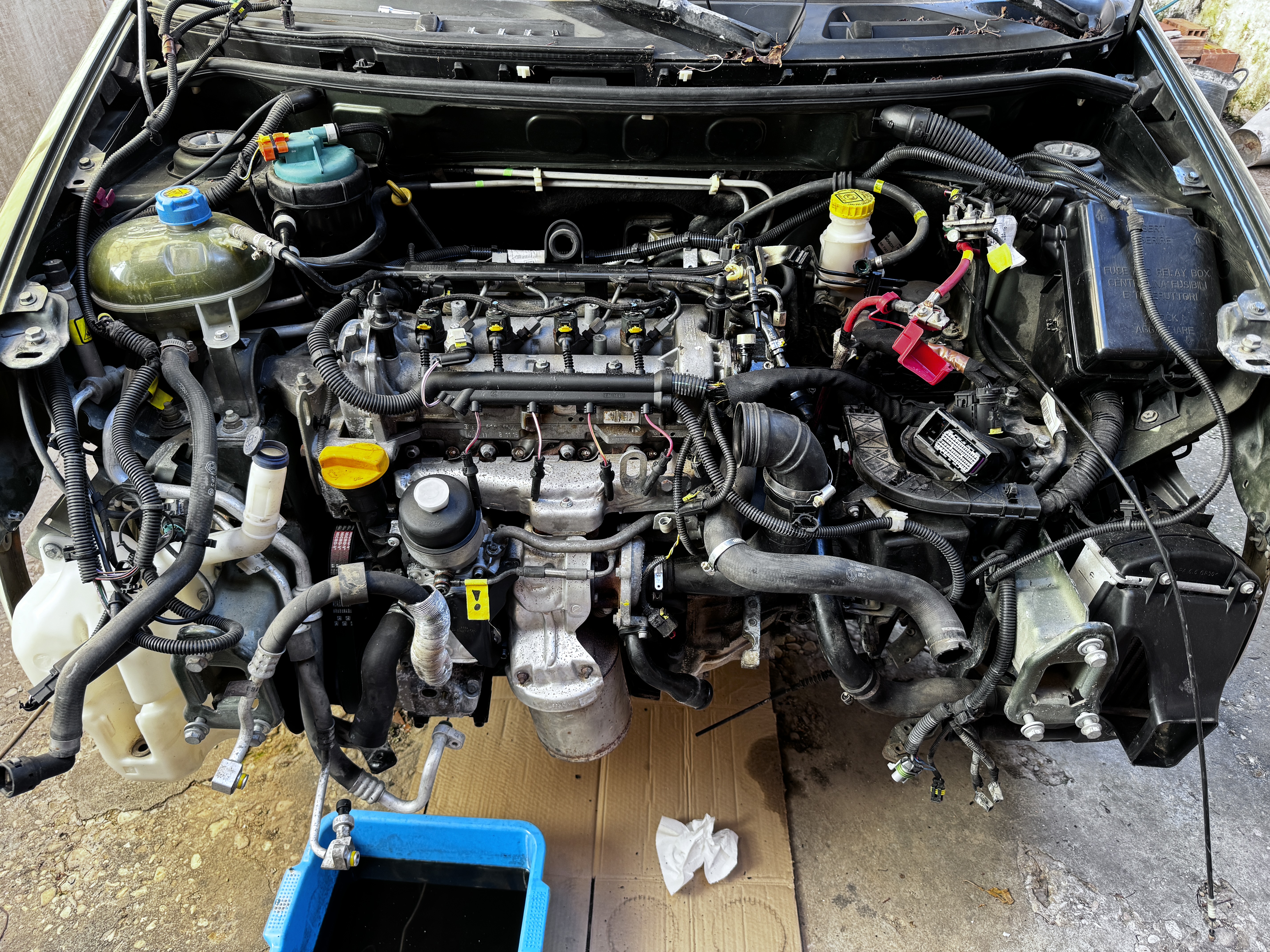

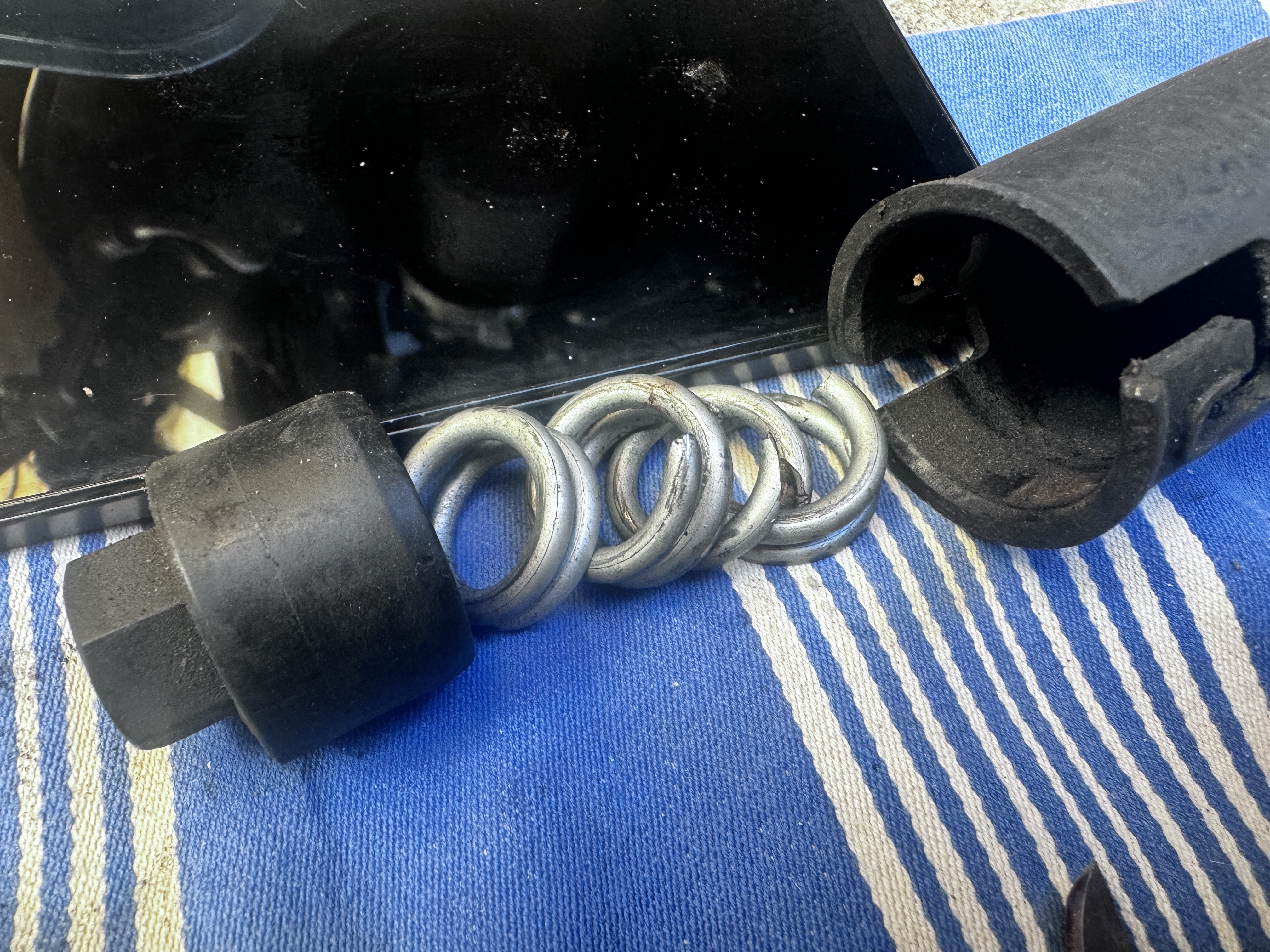

Hi all. As I am pulling the engine out of the 2007 cross multijet for a clutch and head gasket job amongst other things, I discovered that the sell-adjuster spring at the clutch end of the valve is broken in pieces. It appears not to be part of the replacement cables on offer. The scrap yards have no pandas either.
Can anyone shed any light on this part?
Thanks in advance

I could not source this part, so I did what I do best, and Rebuilt it!
After a happy surprise whilst taking the engine and gearbox out, I found that the four springs commonly found in the usual clutch friction plates are pretty much spot on in dimensions and tensile strength, plus the fact that these are clutch parts and so designed to take a repeated beating. Might as well give it a go.
I have made a quick 4 min video of this morning's work, and I now have an as new spring thingy to put on the end of my clutch cable again. Here's the link to the visual how to:
