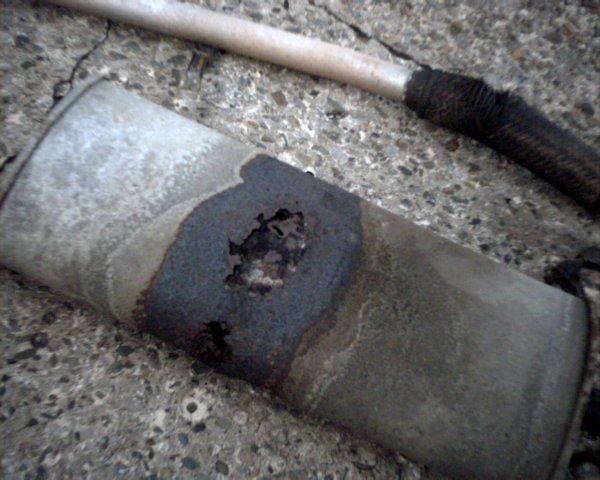

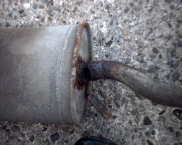

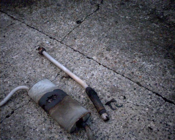

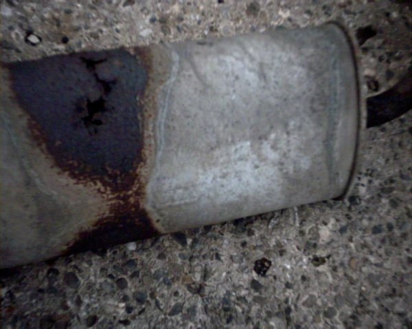

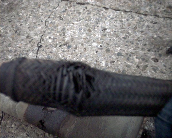

If your back pressure is wrong in the exhaust, the lambda sensor gets a bad gas reading, so Yes If the baffles have collapsed, the cars performance will suffer.
The injector light coming on initiates something called "Limp Home Mode" in the ECU. This basically give the car enough fuel to get home, which is usually WAY too much and will cause a fast idle.
Get a wet rag and plug it into the exhaust and hold it while the engine is running
(be VERY careful here, it gets hot and builds up pressure, so do it at arms length with gloves on, and keep your face and body away from the exhaust!) The engine should stutter and if there are any gas leaks you will hear them, you will also hear a muffled rattling if the baffles have collapsed.
If this is not the case then the Exhaust is ok.
