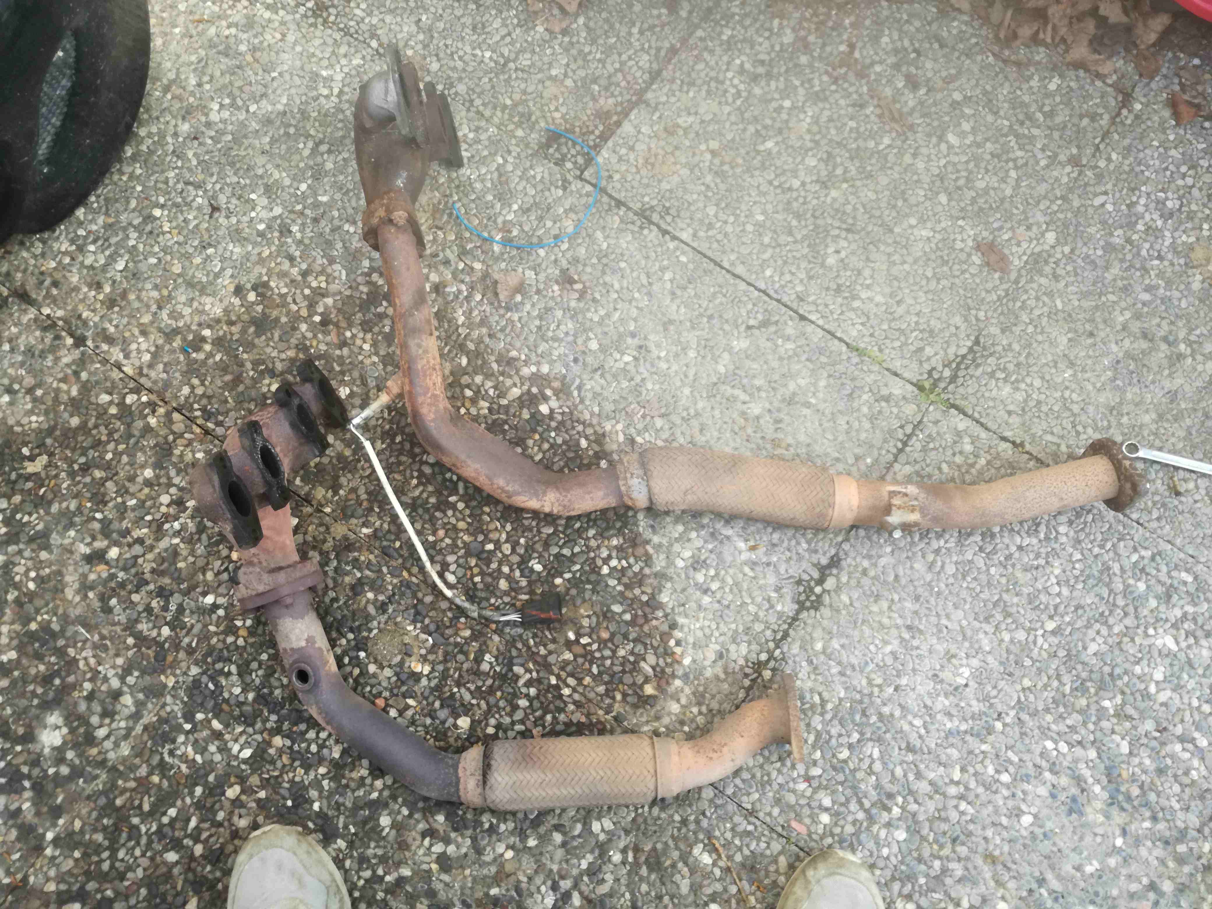

These are differenze to exhaust manifold 1.1 and 1.2

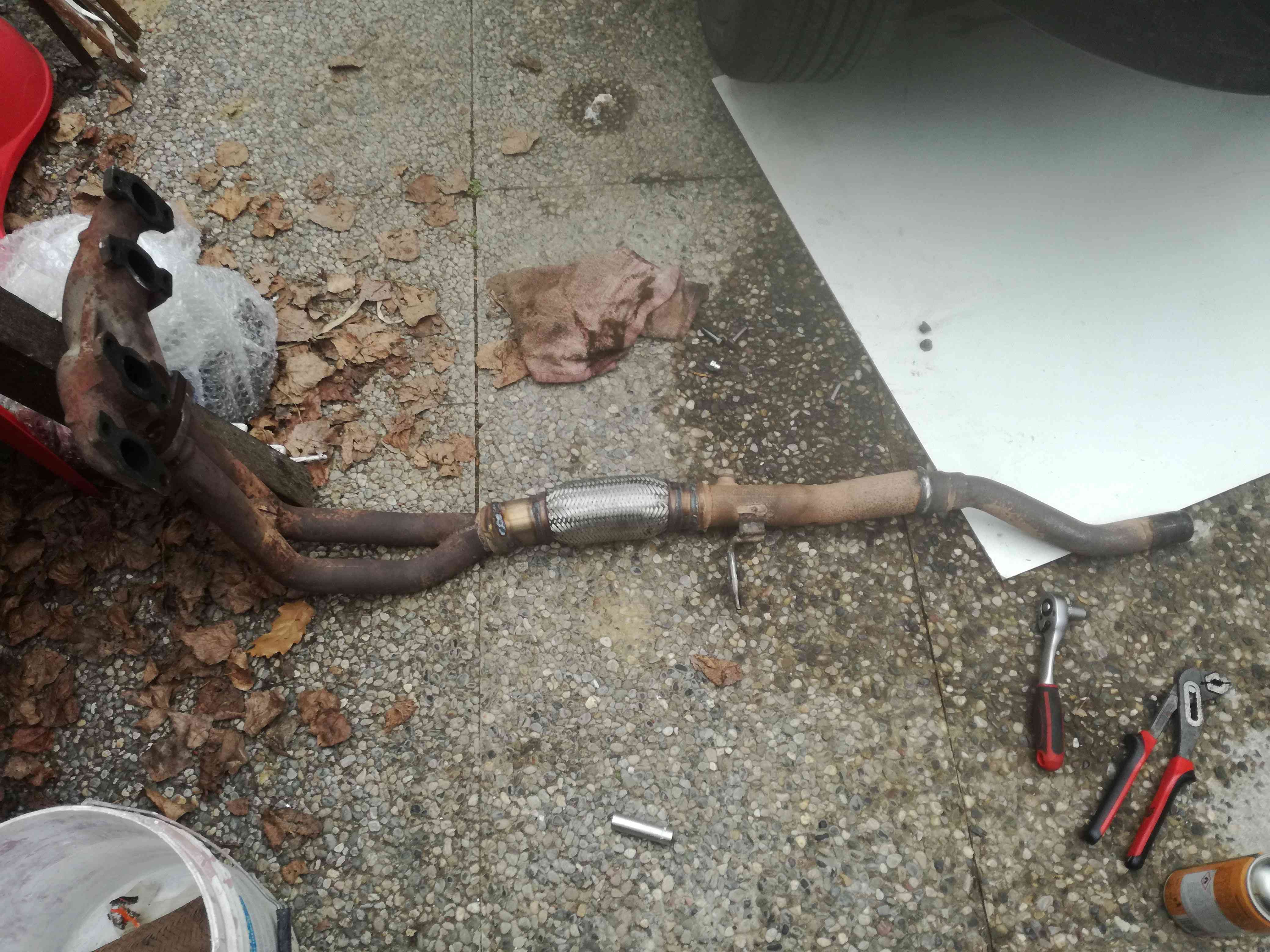

and my solution
