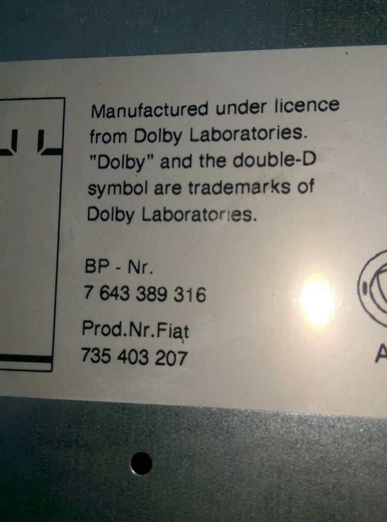

Sorry, without the serial number, I can't get the code for you.
This must be the first Blaupunkt radio ever, not to have one.
Does this help?

Sorry, I received the details now.
Here are some photos of the HU.
The Head unit doesn't accept the code on the code card, only displays WAIT.. message after entering it.

2463 is the correct code for the serial number you posted.
You need to clear the "WAIT" message before entering the code by leaving the radio and ignition switched on continuously for up to 24 hours until the display shows " CODE ", then " - - - - ", then enter the code. If you have already done this, and the code is still not accepted, then it's likely that the code has been changed at a radio workshop.
