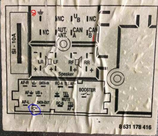

Hi
I have just got a Code for my radio by Davren - thx.
But i have this issue - i think more than 8-9-10 wrong codes have been tried. So i unmounted the radio, and tried to connect it to a 220V to 12V converter.
The only way i can get power to it is using pin 8 in "A" and pin 15 in "C", this is fine radio shows Radio Blocked / Wait
But the radio turns off after 20 mins.
Somebody here who knows witch pin to supply with power + and - to have the radio turned on "forever".
Connecting 2 power supply's were mentioned, but to what pins ?

Hi
I already looked there, and searched for continues power, external power supply. But most of the guides goes for assembling and wiring in the car, and adding sub and speaker.
This question goes for take out the radio and bring it into the house, powering it on, and have it powered on for more than 24 hours.
The problem for mee are the unit is powering off automatically after 20 mins.
/thx

The power supplies and earth connection all go to connector A, not C.
You need an earth to pin 8 of connector A, and power to pins 4 and 7 of the same connector. Having power to both the permanent, and ignition fed pins should stop the radio going into 20 minute mode.
Pin 15 in connector C is the power supply out to a CD changer (if fitted) so hopefully, the radio shouldn't have been damaged by connecting power to that pin.

Hi Davren
Thx - for trying to help me out, I tried already adding power (+) to pin 4 & 7, and earth (-) to 8. Still the radio powers off after 20 min.
Looking on the sticker, it seems for me pin 7 are not in use (NC = not connected ?)
I also tried feeding pin 4 and the pin marked with blue, I think this pin was mentioned earlier in this thread, and oc still earth to pin 8. But same issue power off after 20 min.
I tried to ad an image here of the sticker, but I'm not allowed.
They are standard ISO connectors, so the wiring should be all the same. Connector C is only used for accessories such as external amplifier, CD changer, auxiliary input etc. There shouldn't be any power in connections there. Connector C is usually made up from 3 separate connectors, blue, green and yellow I think. Does your car have those 3 connectors fitted to the radio?
What year and model Fiat is the radio from? The numbers you posted when you asked for the code, suggest it's a Panda radio, but you said it was a Punto.
Not all puntos had the 3plug extra wires fitted
As for the radio saying wait is because it needs a minimum of 30mins ignition on to clear the timeout
The more incorrect codes = longer time outs
If its going off after 20mins it means 1 of the power feeds is missing
Ensure uts getting perm and igniton feeds
And it should keep stereo on for the timeout to clear
Ziggy
Hi
It is a Panda :)
I tried to measure with ignition on - on the cables, and it seems pin 4,6 and 7 have +12 - and pin 1 or 3 can't remember had 5V (CAN A or B)
I tried then to supply the radio with power on 4,6 and 7 - but still the radio turns off after 20 min.
I think I need to put radio back into my car, and leave the car and radio on, until the wait goes away.
Radio is back in the Panda.
Left the ignition on for about 2 hours, and radio asked for CODE.
The provided code from Davren, worked.
Thx for any help, here at fiatforum.com
