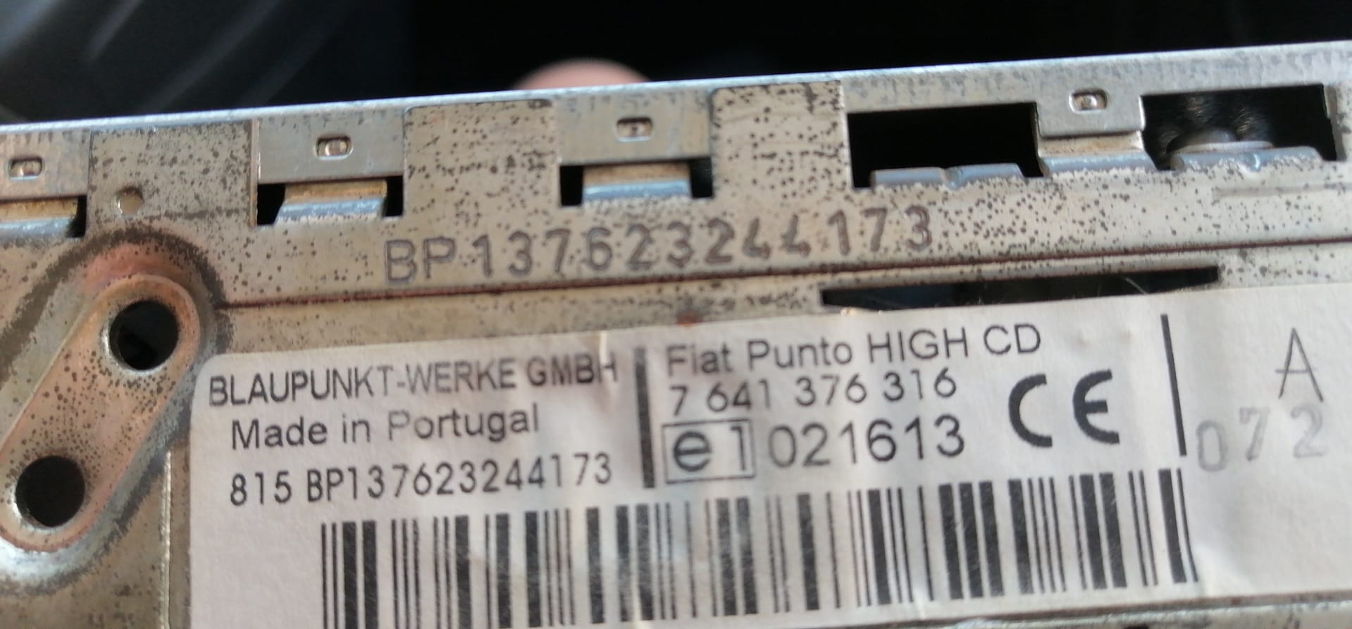

Hi there,
I bought the code for my bellow radio from you guys but I still struggle to get to the point where I have to input the code. In my local garage, they had the radio connected to these radio displays (typical in car dealers for demo purposes) for 48h and the message never changed. Can you give me some insights on what the solution should be to be able to input the code?
Thanks in advance for helping!!
Hi, Welcome to the FF.
Assuming you have the standard Fiat Punto Blaupunkt radio, the " WAIT " message will appear if someone has tried to enter the wrong code too many times. To clear it, you need to leave the radio and ignition switched on for 2 hours. The radio is ready to accept the correct code once the display shows " CODE " then "- - - - ". After the 2 hours, you may have to switch the radio off then on for the " CODE " and " - - - -" messages to appear.
If you need the correct code for the radio, post all the numbers from the back and sides of it on this thread:
https://www.fiatfo
https://www.fiatforum.com/i-c-e/85204-one-only-code-fiat-radio-thread-40.html
