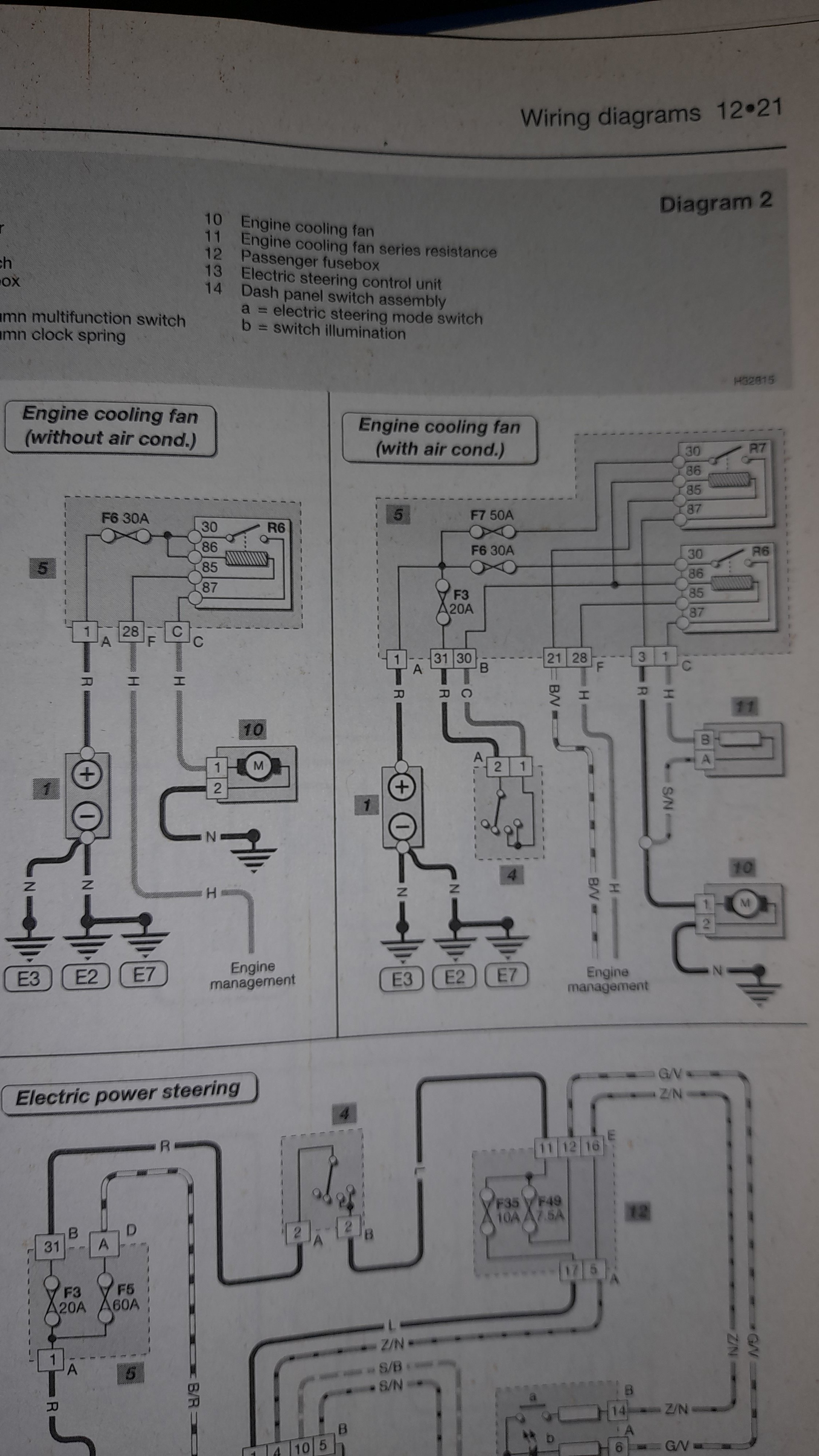

Ok. I led you astray a bit. But i think your car should have a relay in position 6 for the radiator fan. I suppose only the cars with air conditioning have the large relay in position
That's what I am thinking, i don't really understand this much but from what i can see here is the engine cooling fan even without air con has a relay at the bottom of fuse box [R6]?

The ECU earths the fan relay via a little grey wire that runs from below the fusebox to the ecu plugs. If it gets broken as mine did you will have the symptoms you have. A test is to lift the fan relay a little, get a wire in at the earth pin, ground it somewhere handy with the temp sensor disconnected and now does the fan run.
The pin is 85 if I'm not mistaken and it runs to B8 on the ECU, our 2001 Mk2. Another way is just test that wire for continuity. The break was at a bend in the harness about midway between the fusebox and the ECU.
When you disconnect the temperature sender you should get a red flag on the dash and a slight increase in idle speed. Then you know the car is reacting to the 'missing' sensor and it's just lost sight of the fan relay.
