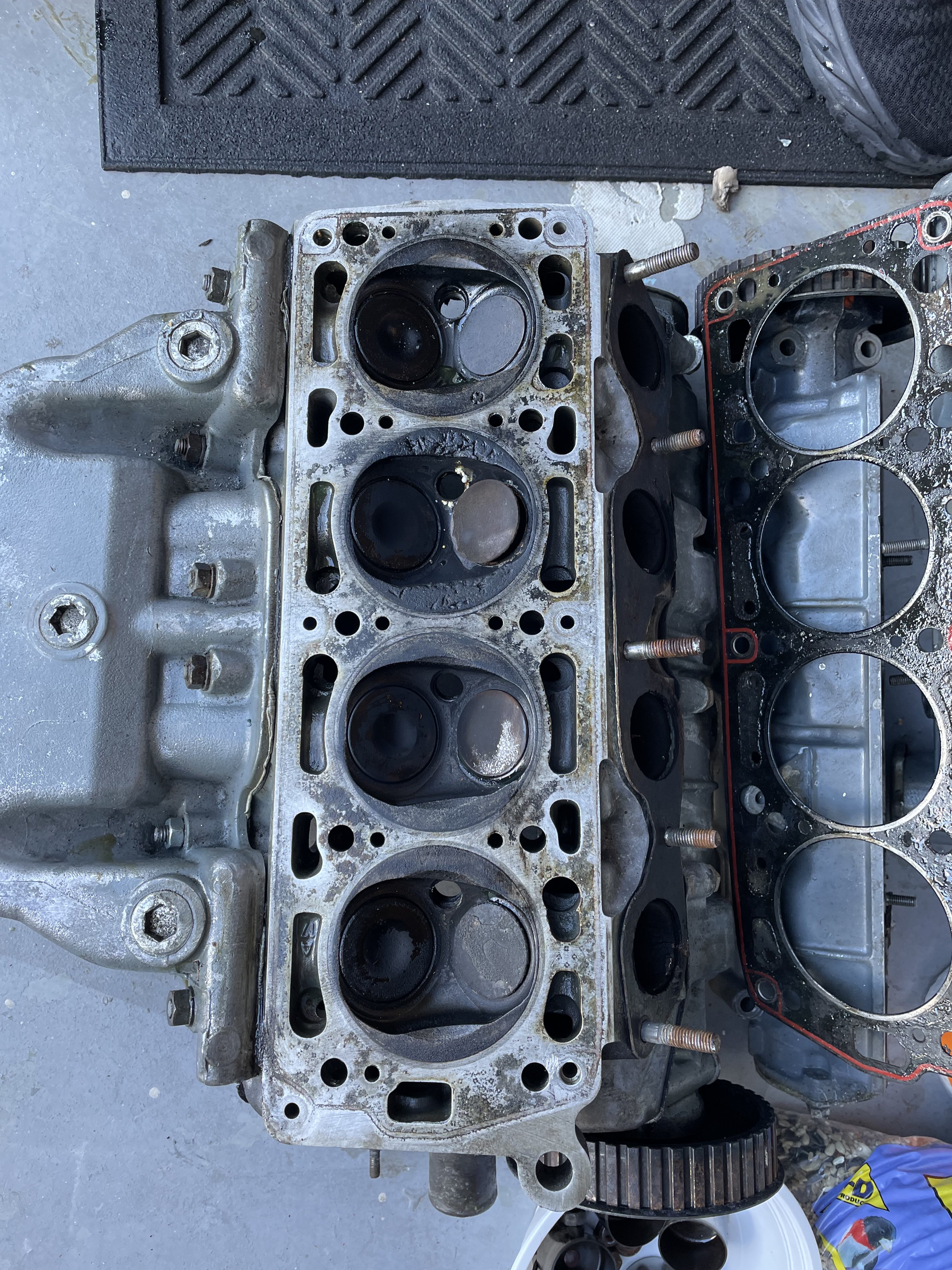

I got the head off. The head gasket was fully intact so that does not seem to be the problem. I head on first inspection looks ok but I have not examined the block yet. It is clear coolant is leaking somewhere into the oil as the new oil I replaced is already green.

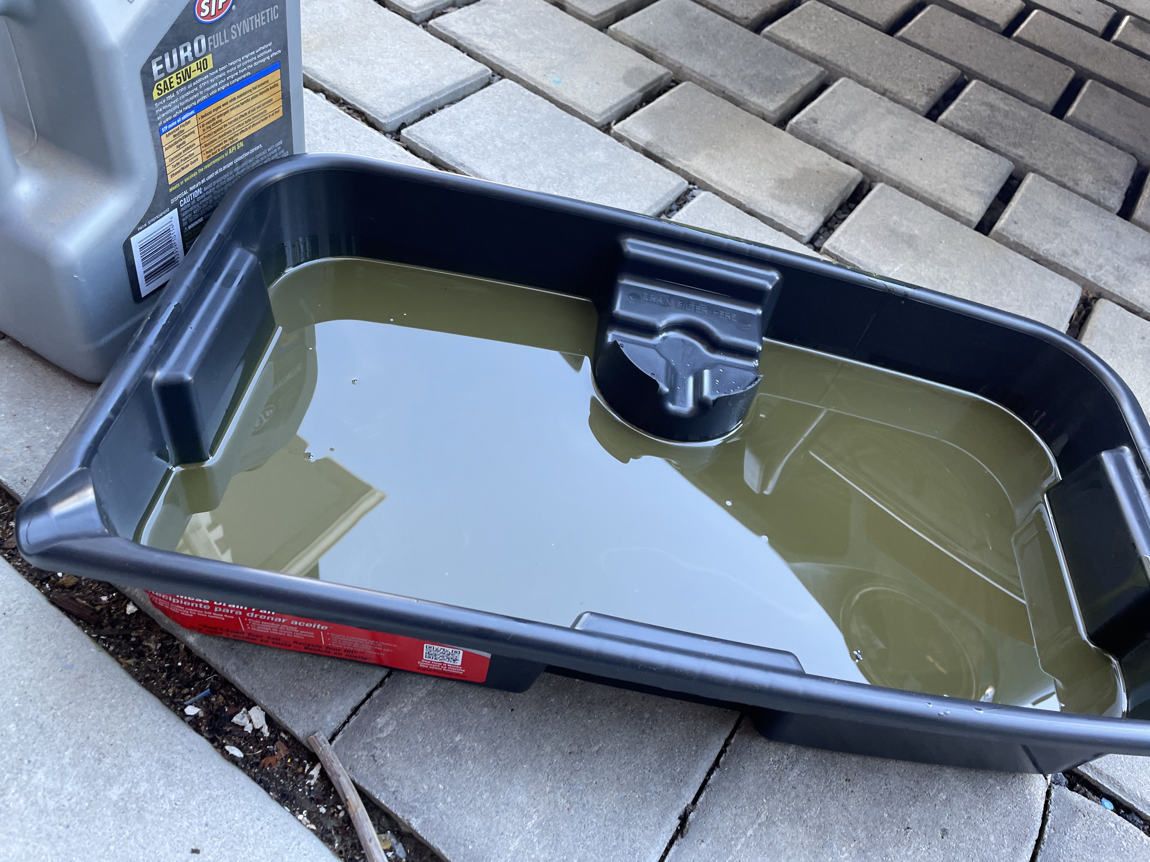

Well I have done some inspection of the block with the head off. With the oil drained out and the oil pan plug out if I put coolant in the radiator, coolant runs out of the oil pan drain plug. So to me that says the block is cracked. Any other verdicts?

Sounds about right. Reminds me about the old Ford tractors 4600 etc that used to crack blocks, no 1 cylinder behind the water pump or at the bottom of cylinder bores where they join were favourite places . We used wonder weld on a David Brown and that lasted several years until it had a coolant change but I think you would be best looking for a secondhand engine.
