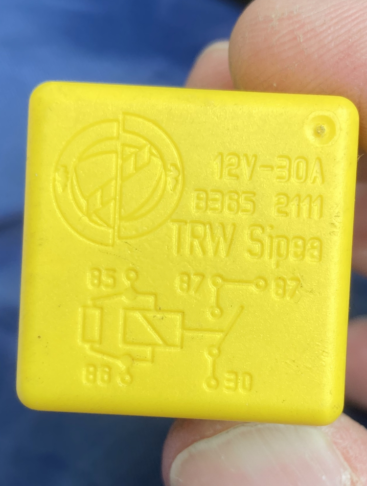

Had the gt out for spin over the weekend and found the fan had stopped working, suspecting a blown fuse , fuse was ok so tried a new resistor and spare fan but no joy . A mate had a look and found there was no power getting to the positive side of the fuse it was showing a good earth , put direct power to the motor it worked, I also found the wipers and washers front & rear not working either yet the fuses are all ok , I’ve checked the two earthing points on the inner footwells and the are sound no rust etc , would there be a separate relay for all this ? , there are some in the glove box and a few on the rear of the fuse board .
