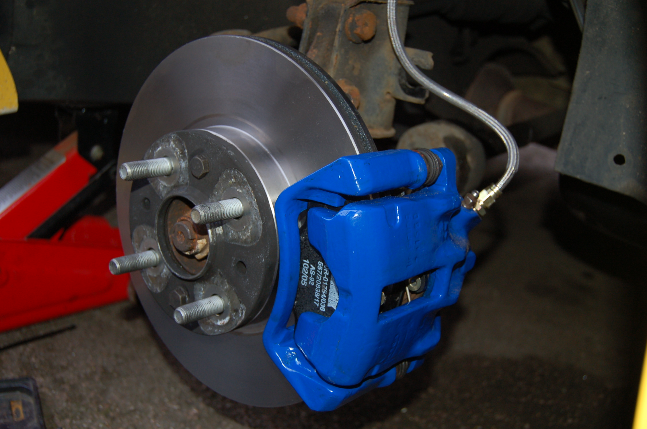

Hi there,
I am trying to swap GT brakes on my cinq but the Brock B5 alloys are a huge problem. I sand de calipers a little but this is not enough.
Maybe 10mm spacers will do it, the 3mm that I use now is to thin.
http://members.lycos.nl/turbocinqy/forums/HT-Remklauw.jpg
http://members.lycos.nl/turbocinqy/forums/HT-Remklauw2.jpg
at the moment the wheel is almost clear. only the balance leads are a little to high.
Can you give me some advise. And is it safe to use 10mm spacers on a turbocinq.
I need this brakes cause of som troubles with my legs and that why I don't have to much pressure power to put the paddle on the ground.

Re: I've fitted Punto GT callipers/disc's!
The diameter isn't the problem anymore. Only the spokes...? are to close to the moving part of the brakes. So if the rims goes 10mm to the outsite the space between spokes and brakes is more.
The will fitt.... some day :D
Brake upgrade Succeed (y) Finally.
After I placed 16,5mm spacers at the front and 20 at the back, a lot of grinding and things like that they fit.
Oh?? Is it normal that the brake pedal has more stroke?
I think so. Cause of the bigger pistons.
right just a bit of info for anyone doing this.
i have bendix stamped calipers but if you get the bendix pads listed for the punto front then these are too small.the bendix calipers are actually made to the ATE speac.so ATE pads are what you need.
