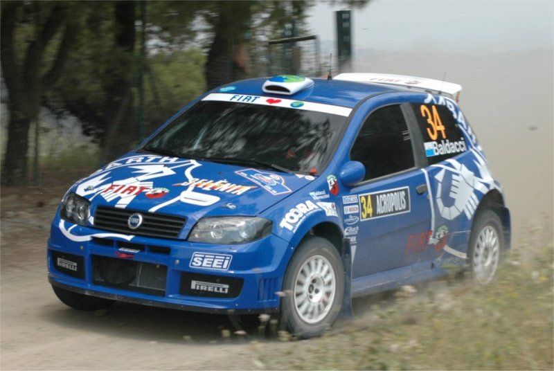

look at this
Fiat Punto S1600
1.6 engine at 215hp in 1000kg

look at this
Fiat Punto S1600

Yep custom made, rally car, not road legal in the U.K. and would cost you €65,000 despite being built nearly 15 years ago....
You can get one hell of a road going car for €65,000
You could buy a 2013 Audi R8.... I know what I would rather have and what would be the better car ...(y)
