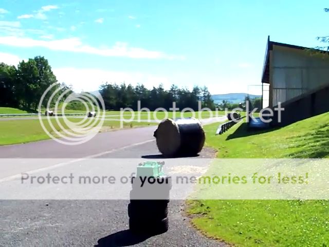

Upon arrival i was concerned that i would need to change from the slicks as the track was damp and greasy, but as the sun was shining i left them to see how i would get on. First few corners went good but was feeling my way about the car and track and when i did open her up a bit, the rear stepped out twice in the corners. The track was drying up well tho so stuck with the slicks.
The track isnt quite long enough to get out of 3rd gear but was still plenty quick
On acceleration coming out the corners theres a bit of a thump so i will have to check the engine mounts, battery wasnt fit to start the car after the initial start at the beginning of the session, so new battery needed, and must remember to carry jumpleads in the toolkit haha.

Been looking into the handling side of things to see if i can improve the corner grip of the rear and getting the power down on the exits, so far i think i need to get it laser aligned and some camber put on the rears, and the rear will be getting lifted 10-20mm to aid downforce and hopefully transfer weight to the front of the car to aid grip in acceleration.
Well i'd defo say laser alignment is a great place to start, especially if you find somewhere that can set up your camber, there's a place called pro-grip that's highly rated, think Donald/Scuderia went there?
What kind of corners are you losing rear grip on? if it's more high speed stuff then i'd probably leave the rear of the car down and look at the front, it will probably be easier to give the front a touch of wash at high speed (usually by playing around with ARB's) and that will balance the rear out. You'll likely find if you start tweaking the rear the front will feel different anyway.
For getting power down, what diff do you have?, track cento's report huge benefits from Quaifes
If you watch the vid a few posts back, i was loosing the arse on the corner closest to the camera, but that could have been a combo of worn slick on nsr and greasy track, on saying that, i was struggling the whole time to get it to grip coming out the corners too, spinning up in 2nd and 3rd, it has an LSD but unsure of make.

Can defo hear it losing traction under power, sounds like you can almost get the power down initially but the second the boost really comes in that's when it's breaking traction, but on slicks on a greasy track i'd say it's best to re-evaluate it all on a bone dry track and then adjust anything, all that there could just be tyres not suiting conditions which is just massively exaggerating stuff. Really doesn't take much wet to take slicks out of their operating window.
Yeah, most of the way im feathering the throttle, will have a wee play with it and see how it really does on the 6th :)
