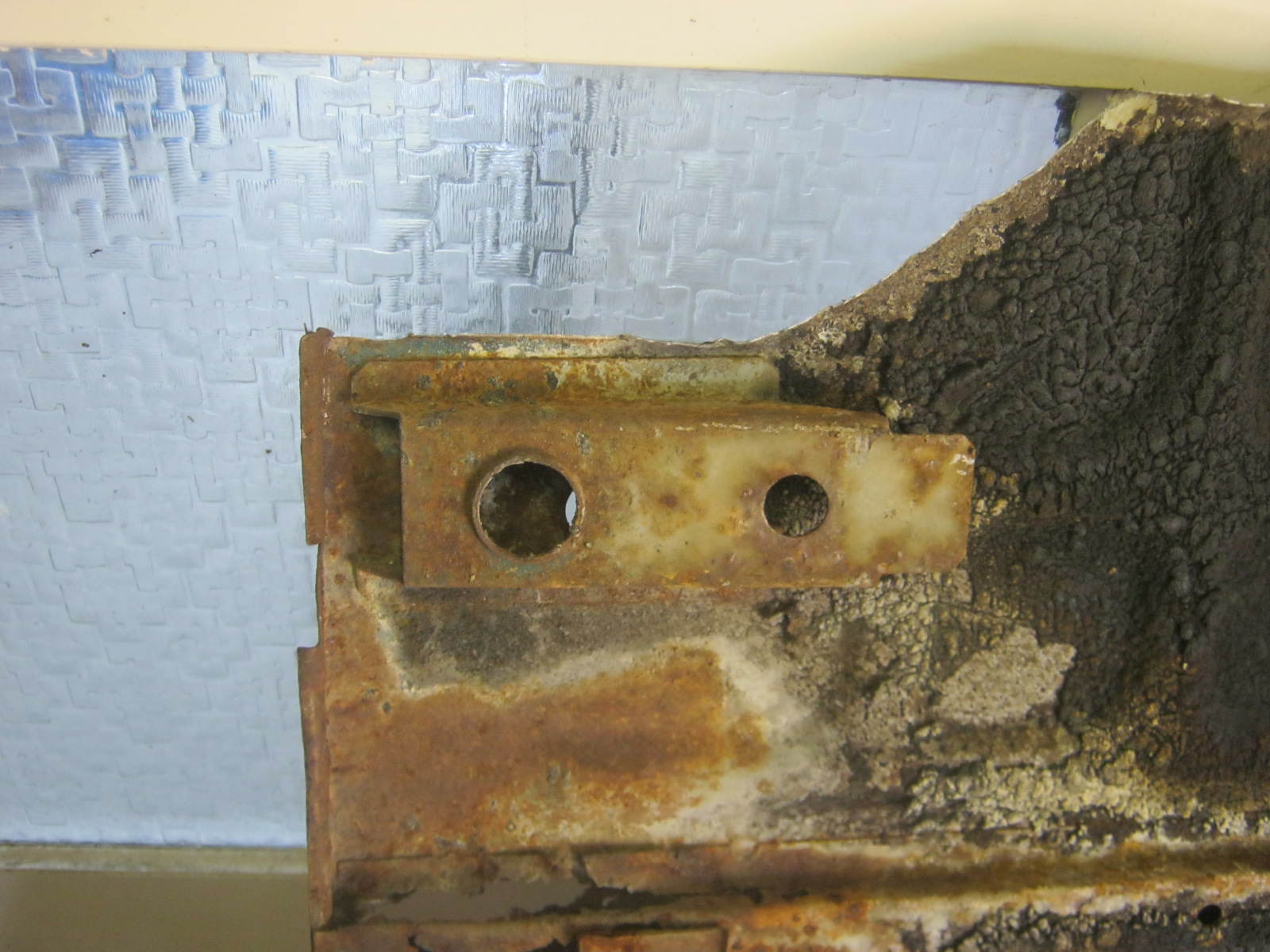

Been there, done that and appreciate what a job it is.

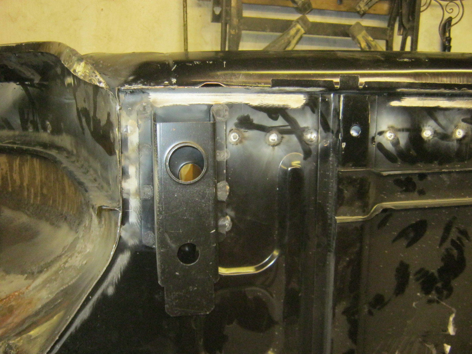

Well worth while in the end, and you know you have uncovered any hidden rust. It seems like ages ago since I done this part so I just checked my photos. As Peter said they are lifting platforms for either Jacking or resting the vehicle (subject to floor strength). They are made from quite thick steel and I found the easiest way to remove them was to remove the floor panel then grind the spot welds through on the floor side. Then you can reuse them unless they are corroded too much. I had ordered 2 new ones before I had checked these thoroughly so I fitted my new ones. But I have kept the old ones which will get used on my 500D probably.
I found it easiest to weld them to the floor before fitting the floor. I drilled holes in the floor panel and plug welded them, that way you get a stronger weld on the thicker steel. Grind any heads off, fit the floor and then its all covered by the sound pad.

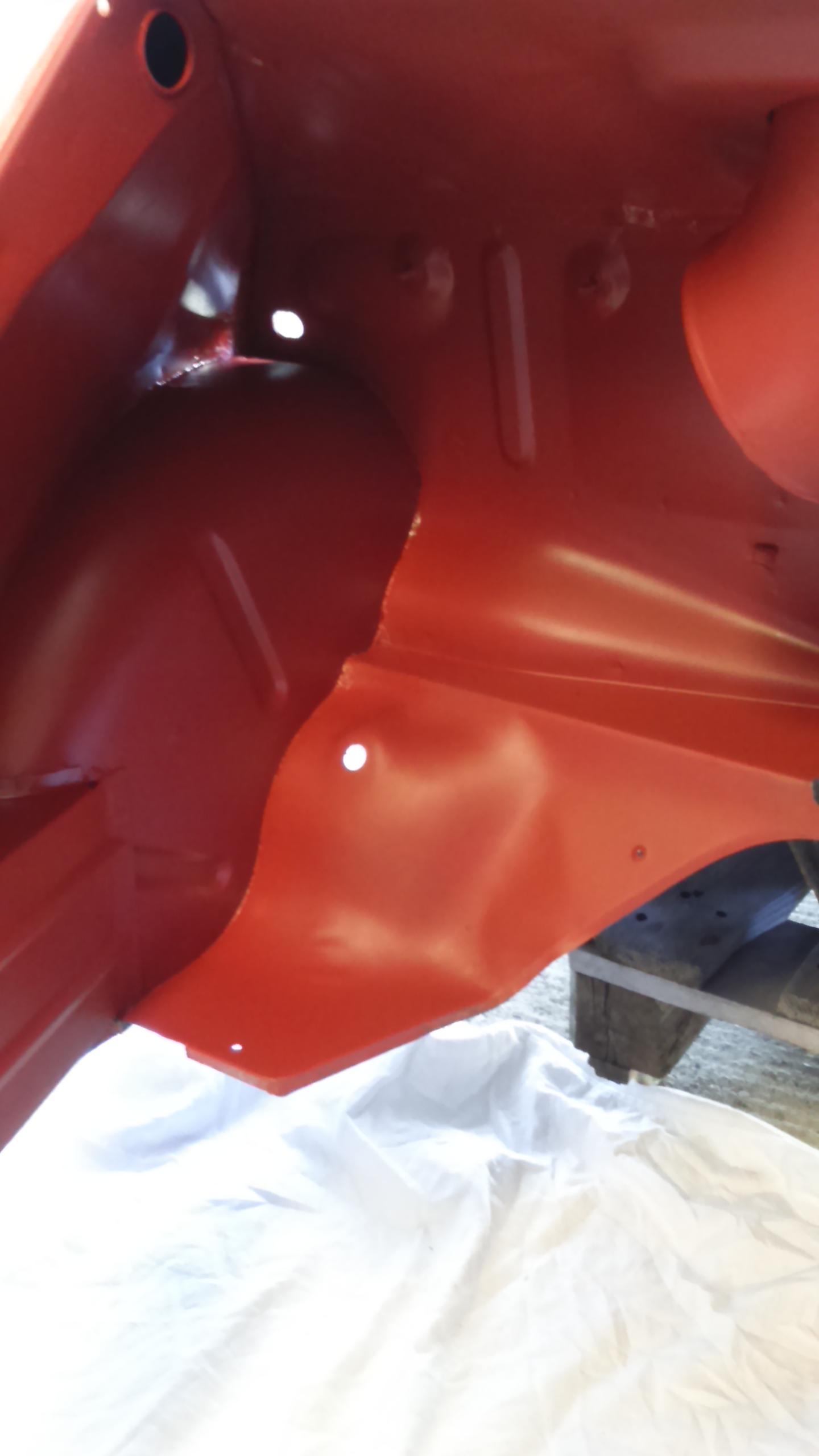

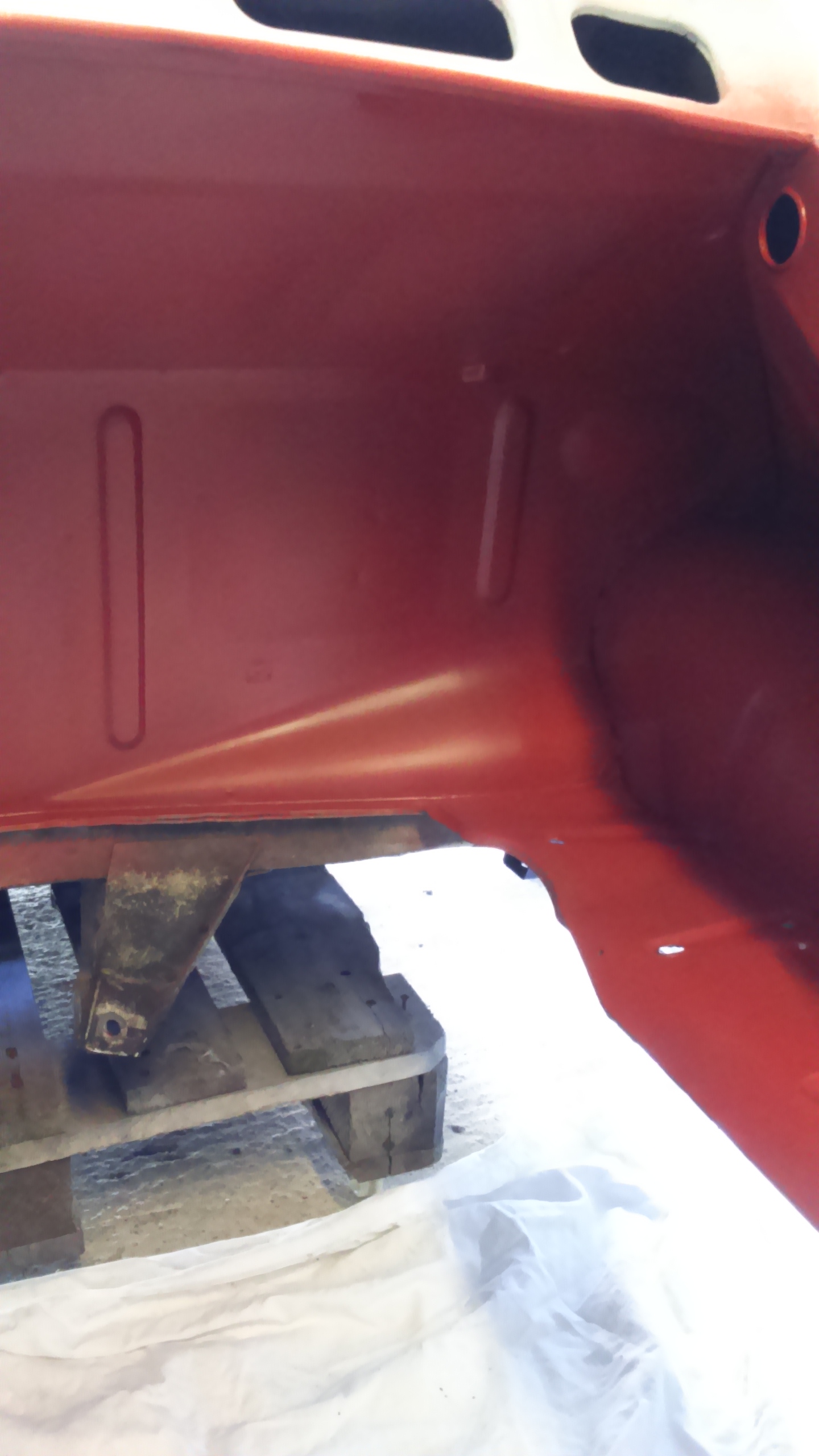

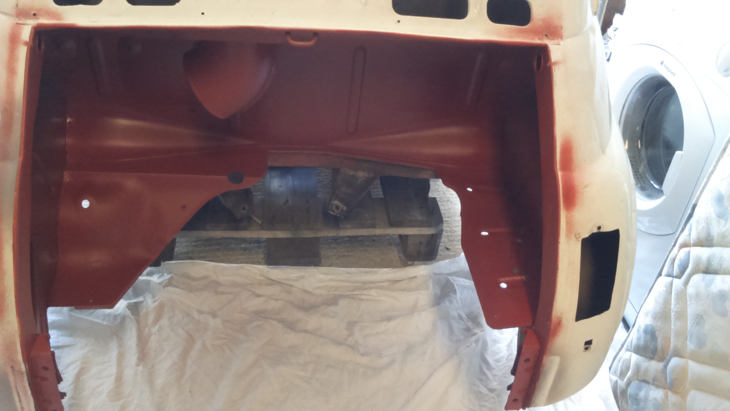

The mammoth task of removing the underseal continues. Even when you heat it and scrape it you still end up with residue behind that I'm then struggling to get rid of. I completed the engine bay today and put a coat of primer on it to stop oxidation.

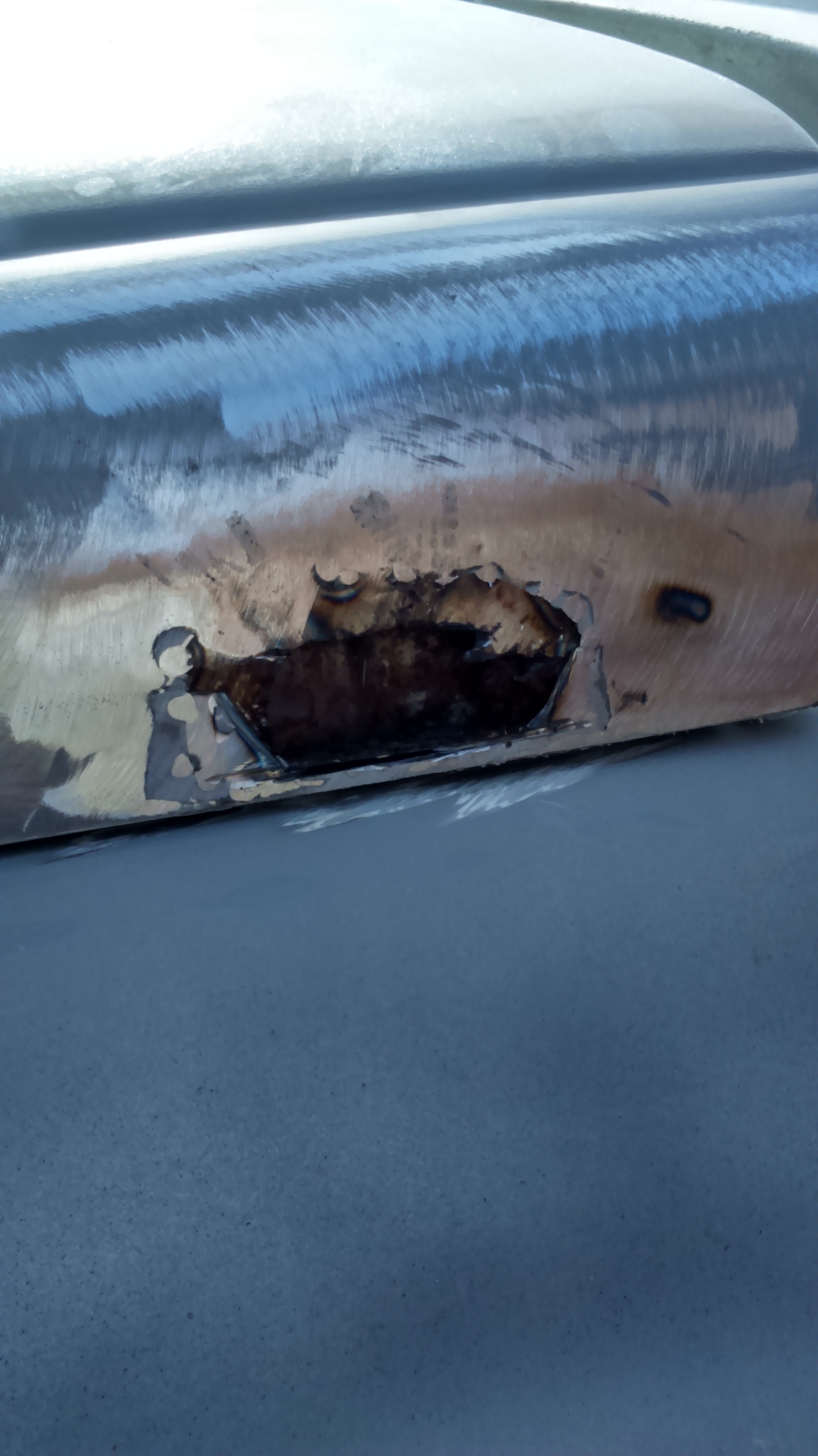

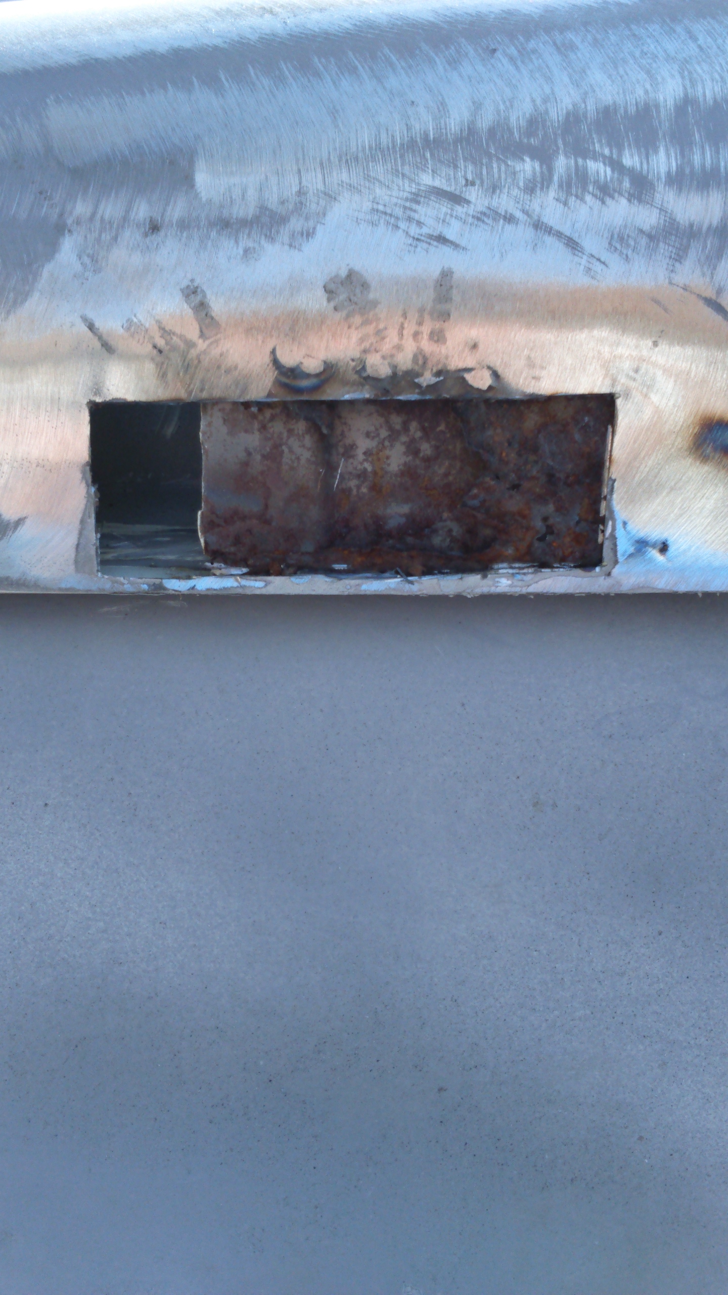

I then attacked the bonnet that when I removed the paint discovered a load of filler. This then exposed a dodgy looking repair which was nowhere near flush with the original metal. I took a grinder to it to try and neaten it up but it just started to break up. I removed it to expose a hole in the bonnet and some rust on the bracing. They had basically just covered the hole with a piece of metal, tacked it in place and covered it all with filler. I have cut out around the hole and treated the rust. I will then put in a repair piece, weld it up and smooth it all up.
Engine bay looks good. That cant be a nice job, that's one of the reasons I went for blasting.
Ooh I could see a new bonnet being ordered soon!
Oh I should have read the post properly:D It is clearly the bonnet, as Sean said I would bin it and save yourself a lot of work. On my 500 over the years people had twisted the bonnet from side to side to try and get an equal bonnet shut gap on both sides. I tried for ages trying to get it to sit right but it had been badly deformed and was beyond help.
I went and got a new bonnet in the end, the only thing I had to do was grind the inner lip down as it was too wide and was catching on the on the front wings, otherwise it would rubbed all the paint off. I should add I started using a grinder but nearly went through the bonnet, so resorted to a little cutting disk on a Dremmel.
Sean, Tony
I will bow to your better knowledge but I can't see how I will need a new bonnet for such a small repair. The previous repair was bodged and that was okay so surely if I do it properly then it will be okay? Van der Laan has one at the moment for 50 euro which would also prevent the need to repair it and to try and get it down to bare metal. The outside is easy but the inside is a bugger! Have I just talked myself into a new bonnet?
Damian
The choice is yours! new bonnet, nice and straight, no dents. Or repair the old one, and then always wonder if that rust is going to appear again from the area you cant get to.
Seriously not much in it, all depends on your budget. Believe me, if you buy a new everything it starts to get very expensive
