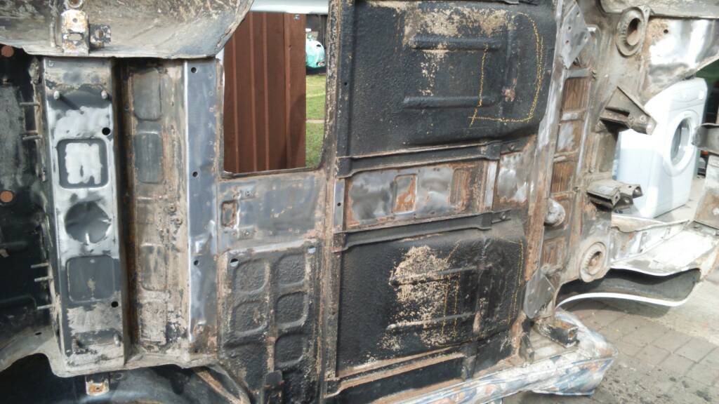

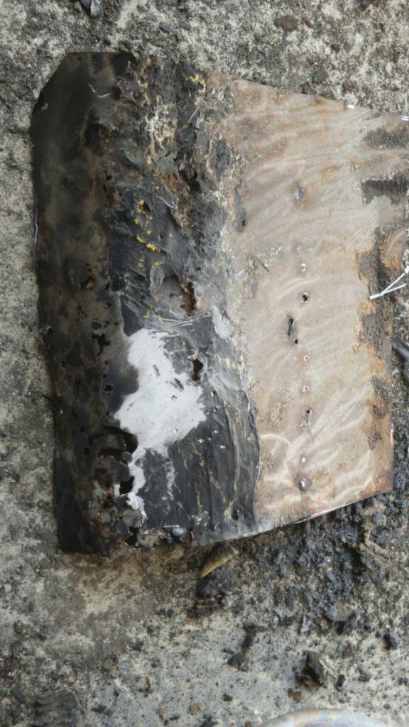

A scraper and petrol was all I used. Needs a final clean but nearly there

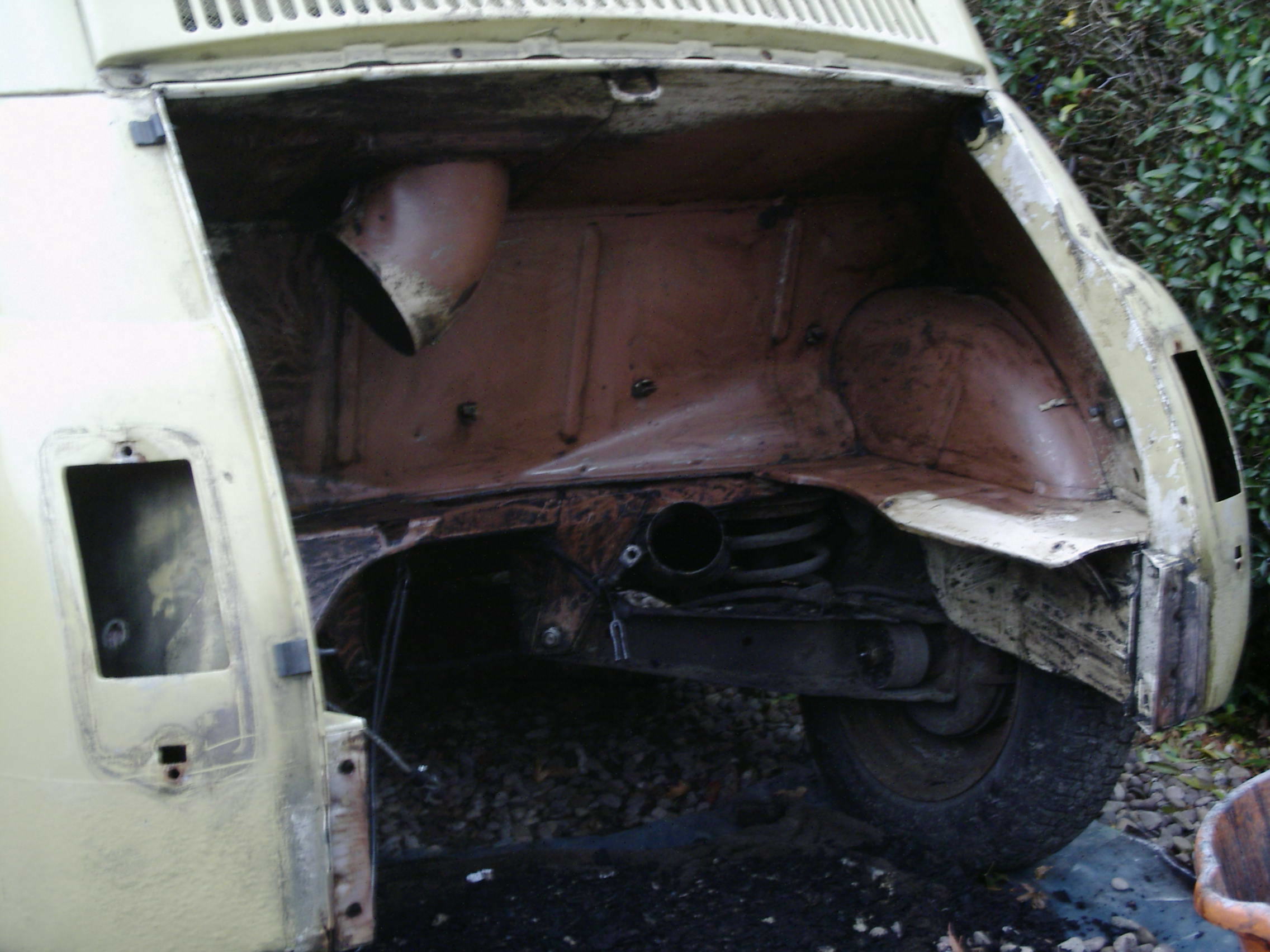

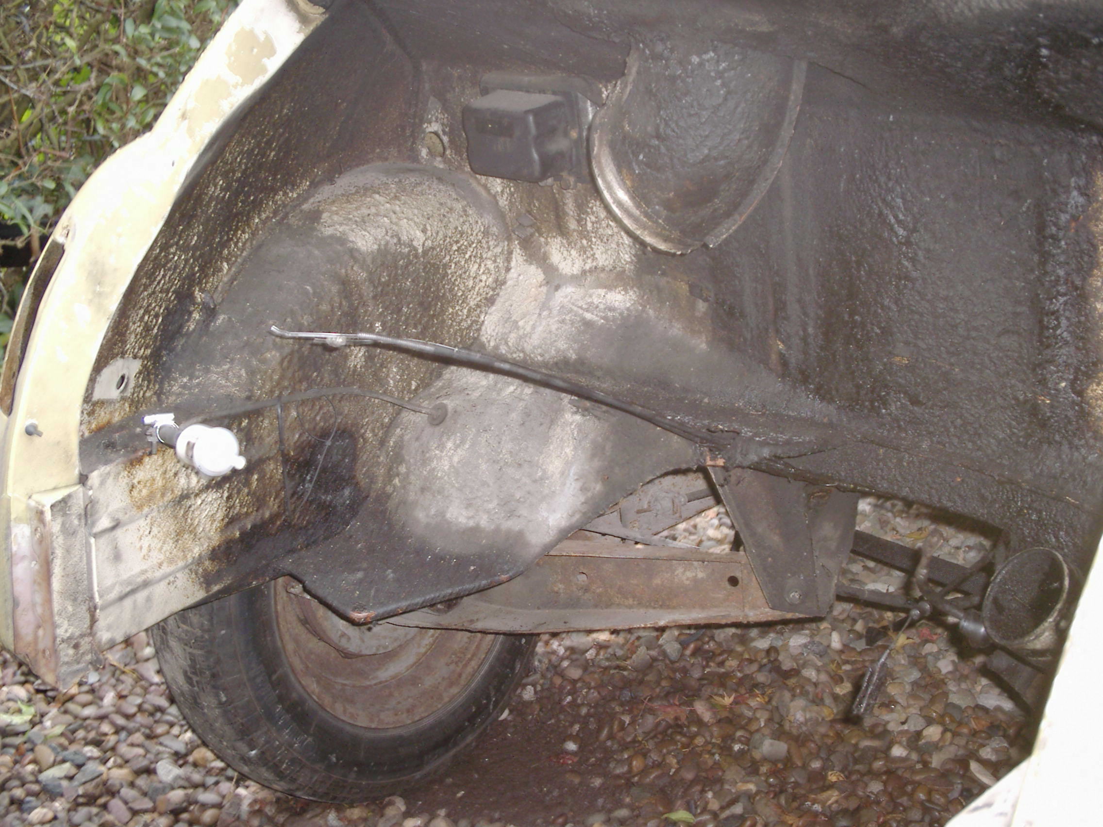

First bit of metal cut out. No stopping me now and certainly no going back.

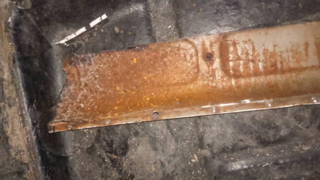

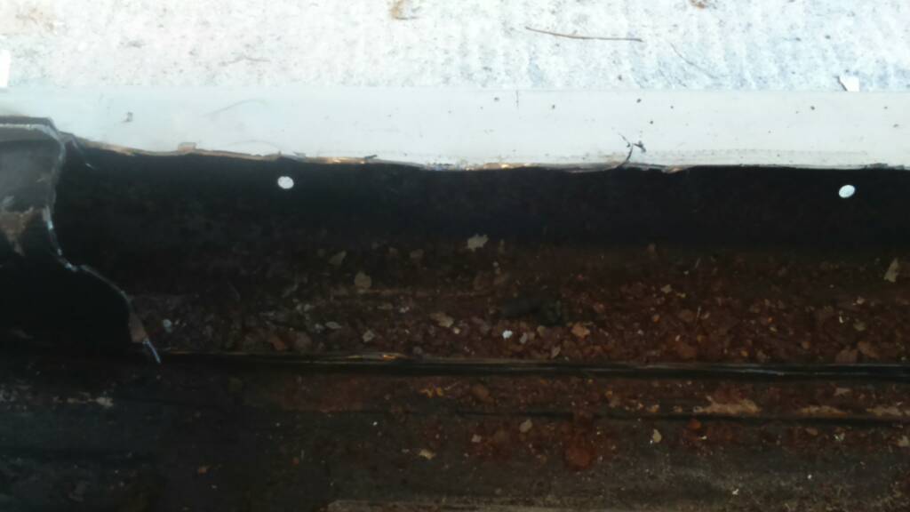

Ahhhh ahhhhh! always looks worse when you start cutting into panels. I have always found that whatever rust you can see, there is usually 2 to 4 times as much that you cant see.
Just think how much stronger it will be when it is finished, and how pleased you will be knowing that rust wont appear a year after you have spent a fortune having it painted.
Keep up the good work Damian.

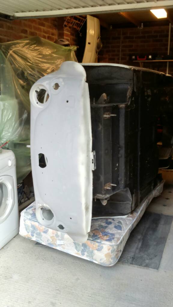

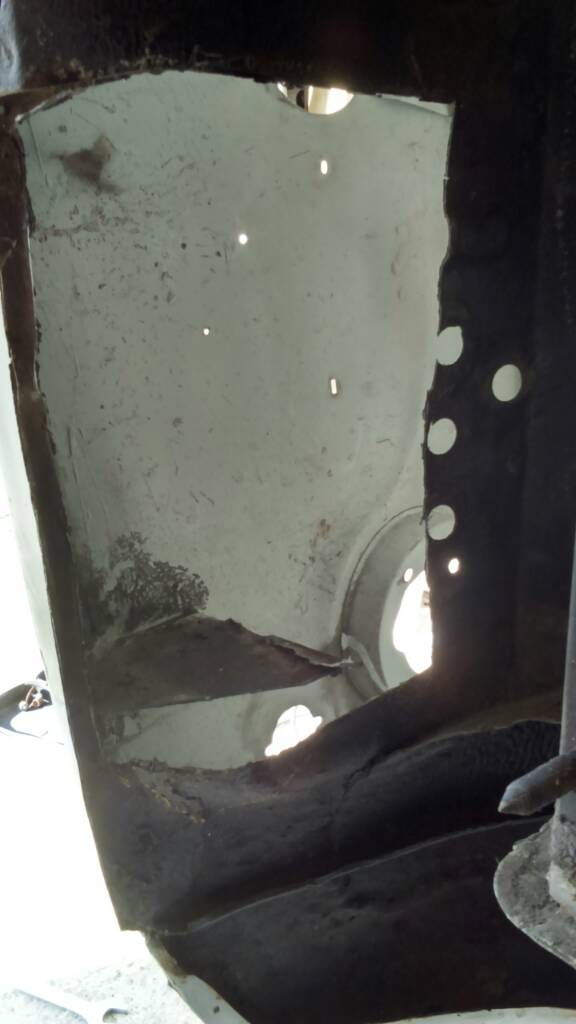

Change of direction, well for the car at least. Getting the underneath stripped and cleaned and replacing the battery area with a repair patch.

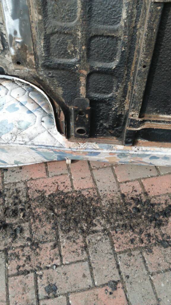

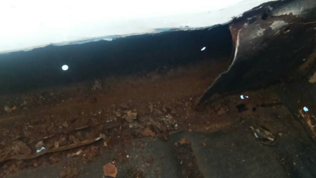

Have enjoyed the restoration so far but not todays job, removing the 49 year old underseal. Tried every top tip on the internet and every chemical and grinder wheel I had in the garage to no avail. The only thing that would touch it was a heat gun and scraper. Had to work in sections about 3 inch square and slowly try and get it all off. Once you get the majority of it off you can then try your petrol, grinding wheels etc to get it to bare metal. Not quite finished but broke the back of it, obviously didn't bother with the floor pans as these are getting replaced. In the last photo there is the extra bit to the front of the floor. My new floor panels don't come with them and I haven't come across them on parts sites. What do they do?

Lovely stuff Damian. I missed on that pleasure because what little was left, after the floorpans were refitted seemed OK to me and I let it be. But your obviously going for a finer finish.(y)
I think you are maybe asking about the support pads are you?....the raised plate with flanges and a pressed out circular hole. I the car body can be rested on them if any front mechanical work is being done..probably mostly used when originally assembling because there's a similar setup with those rear turrets. I have since seen them for sale, maybe Axel Gerstl? but I made one out of heavy gauge steel. You might be able to grind off the old ones when you remove the floor, clean them in your sandblaster and re-use.

Thanks for that Peter. I have just found them on Van Der Laan but I think I will do as you suggest and re-use the old ones. Recycle where possible. The underseal was original, I think, and was tatty in most places. Around the tunnel it was up to 5mm thick and in other places there was barely any! You also can't paint over it and I want the underneath to be the same colour as the body (baby blue). I have sourced some underseal from Soudal that looks good stuff and I will apply this myself to get an even coating. It can then be painted over and should last another 49 years (although at this rate I don't reckon I will). I've found out today that these cars really are a labour of love!

PS. Probably easier to weld the brackets on before you fit the new floor....just a thought to avoid upside-down welding. :cry:
PPS. Probably all the preceding also applies to the seatbelt mounting nuts and plates.
