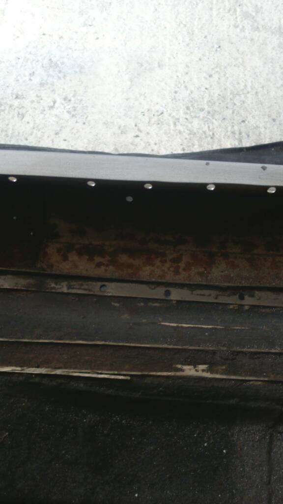

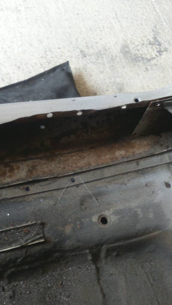

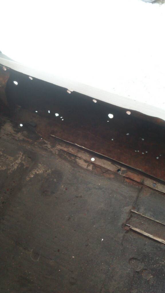

Done a test patch on the roof to get the technique right for prepping before painting. Reckon I've got it nailed now as it's like glass but not sure exactly what finish a paint shop is looking for?

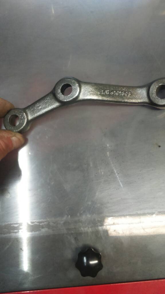

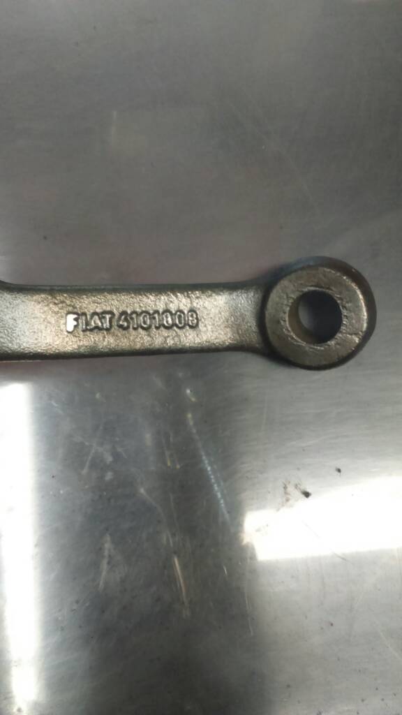

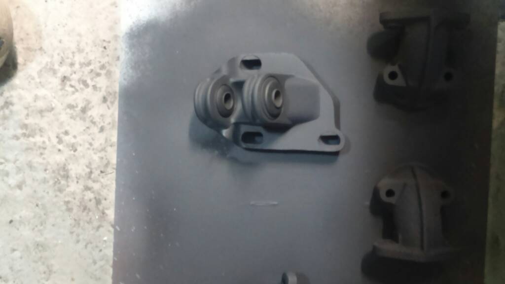

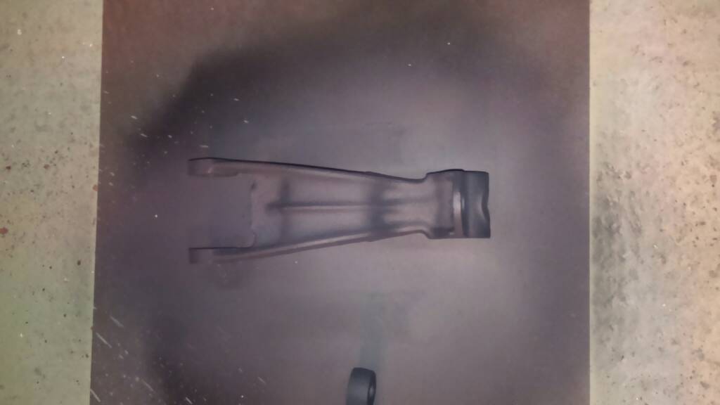

Shot blasting today. Just doing 1 king pin first to see how it turns out before doing the other one. Got the steering idler arm so clean you can see the original fiat part number!
Thats etch primer not the finished colour

Wow, did you polish that idler arm?
I cant even get my one off the steering box.
I have tried all sorts of methods & it wont budge. Might need to cut it off.
If I don't get it off I cant change the seal.
empty the oil, stick it in the oven for 30 mins - then bearing puller and some persuading..............?
Sean
Thats the arm from the steering idler bracket. I shot blasted it and then gave it a quick blast on the wire wheel. I've done 2 steering boxes, the first I couldn't be bothered messing about and cut off the arm. The second I didn't want to cut off so I had to modify a ball joint tool. It was still stuck on hard but it gave in in the end!

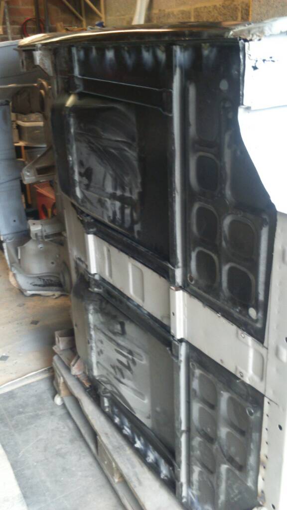

2 floors in. What do others do to tidy up underneath?
Thanks Steve. I was meaning more to do with tidying up the welding on the new floors
Hi Damian, I usually use an 80 grit sanding disc on my grinder to tidy up the welds. Then I use a clean'n'strip wheel to clean up the area. I noticed you don't have the floor centre braces welded to the remainder of the original one that is attached to the centre tunnel. Is your guy doing that as well?
Yes Sean he is. His welder packed up today so although it's on it's side we haven't touched underneath yet. What do you do to disguise the fact the new floor is at a different level to the original centre? Have you got a picture to show the centre braces?
