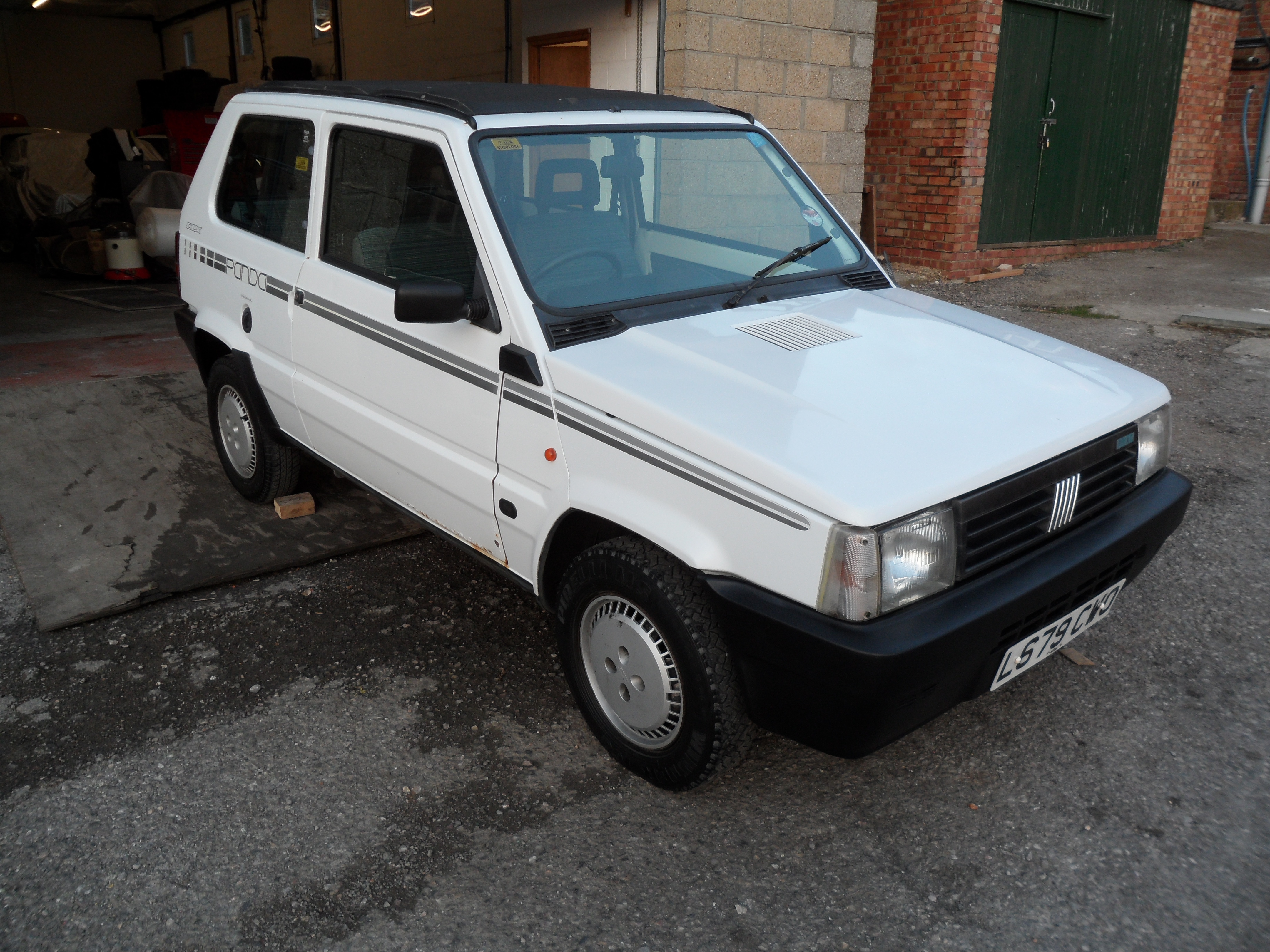

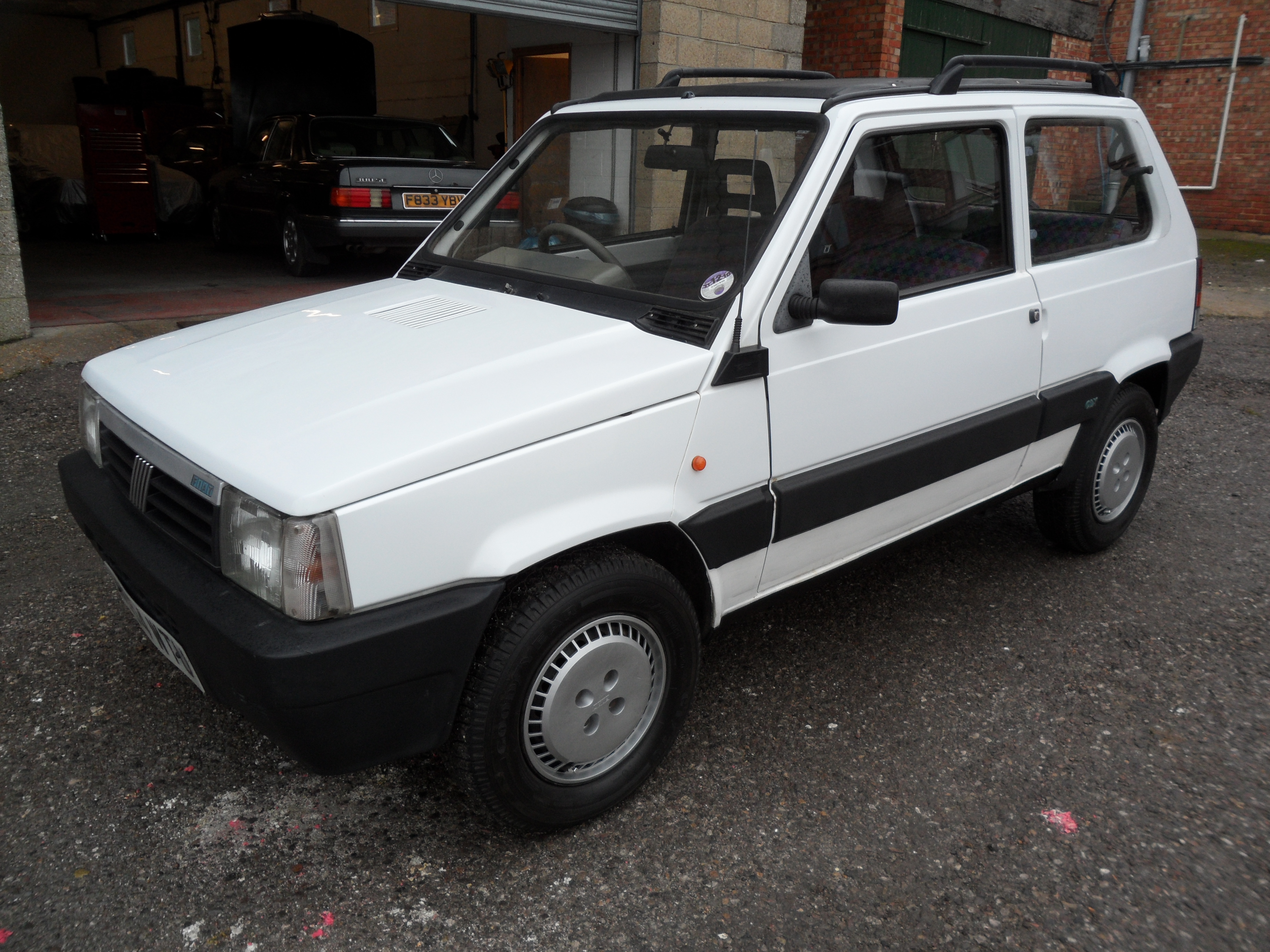

Well I have submitted and had approved a design so it's now full steam ahead with the first car. The basis for this is the white clx I recently picked up from David (Fiat Nutter)............

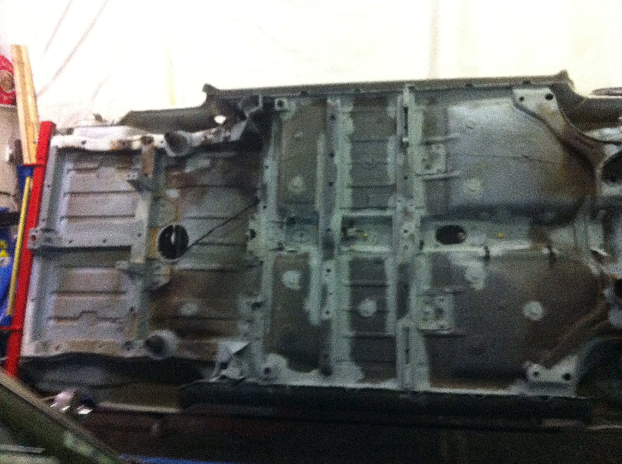

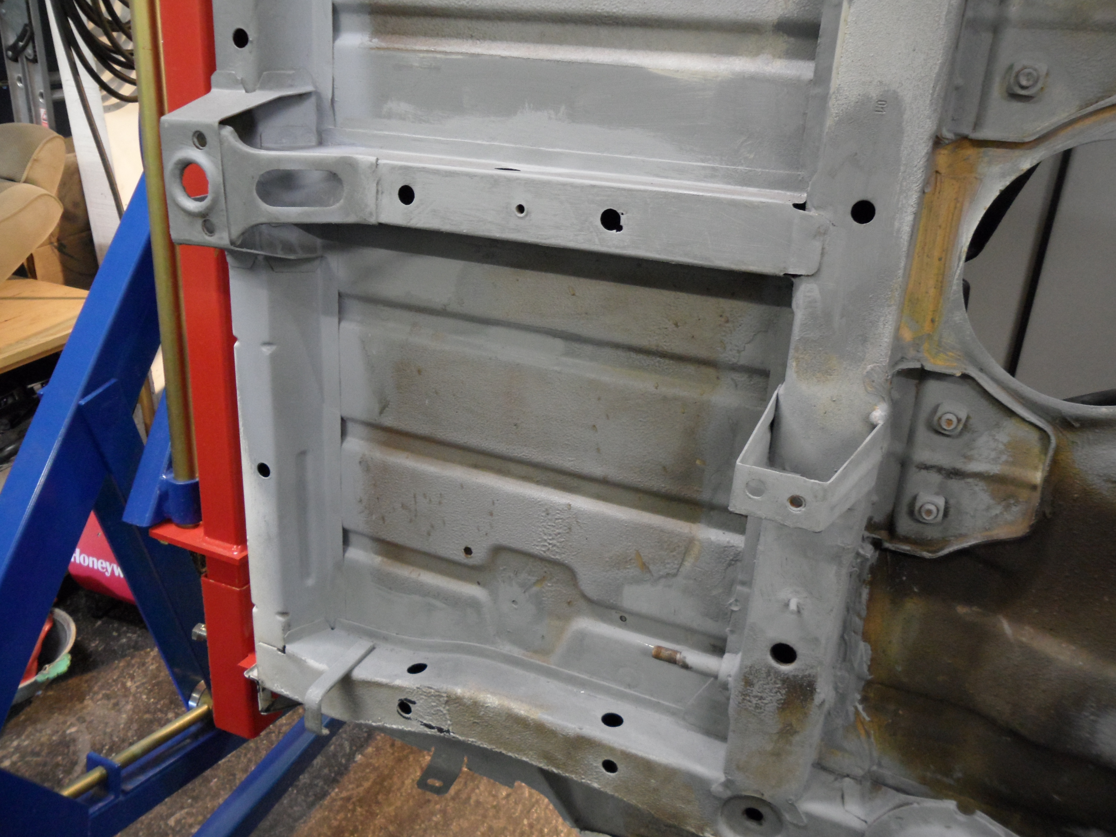

Been making steady progress on this since last posted, mainly working on the floorpan.

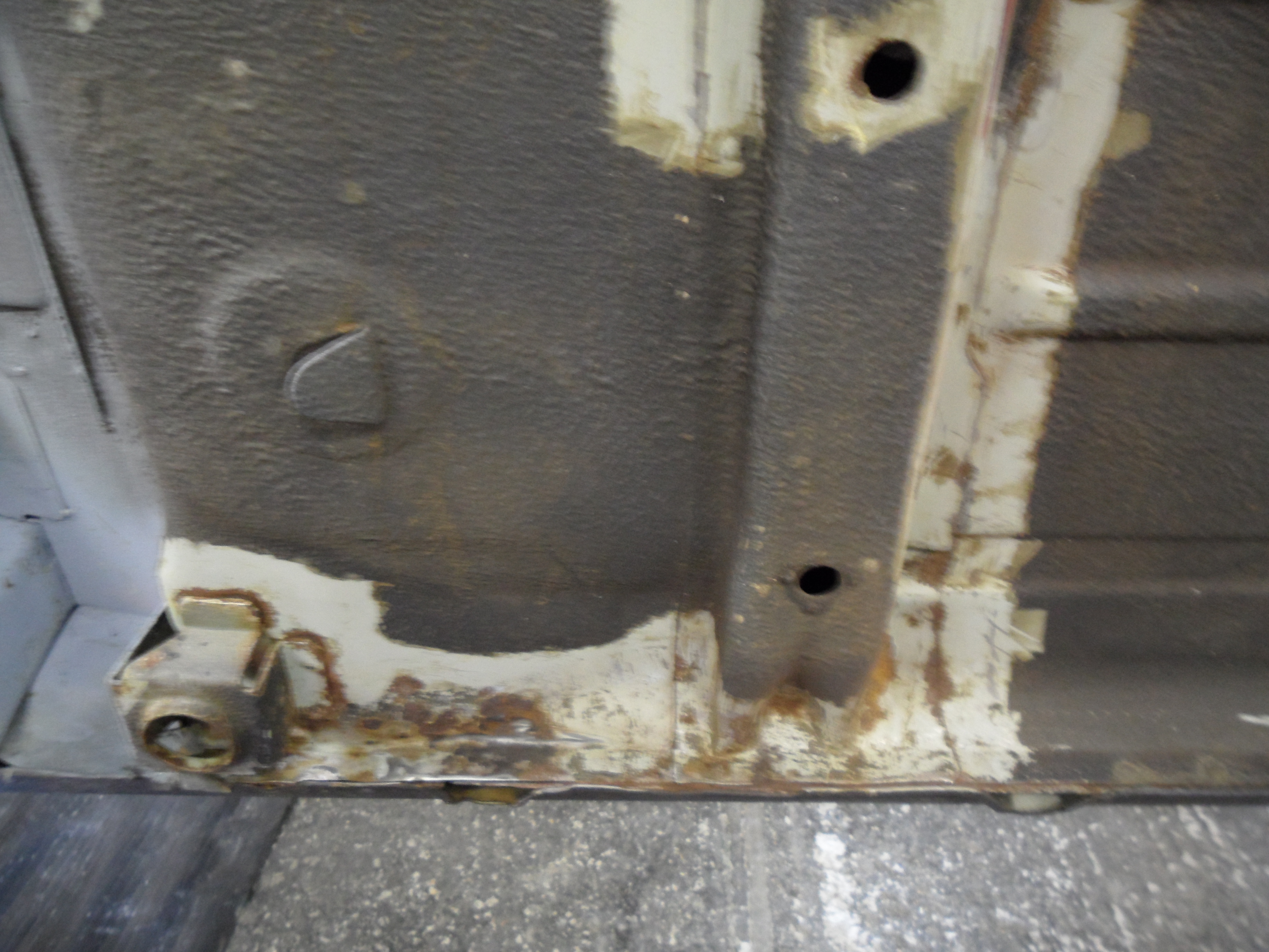

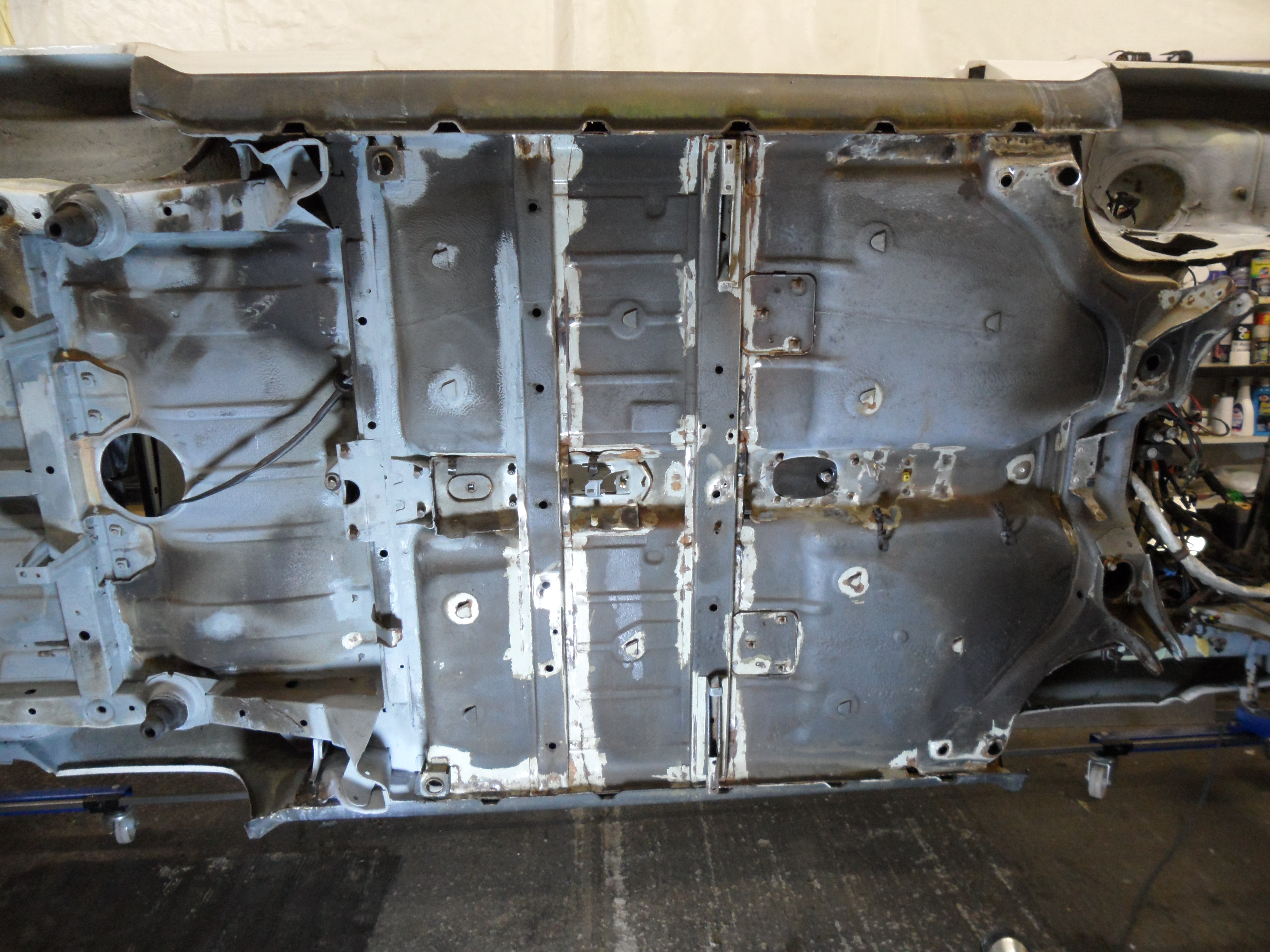

It's actually a very solid Panda but with a lot of surface rust where the original underseal has lifted on the seams and allowed surface rust to develope. So first job was to thoroughly scrub the underside then scrape off all loose underseal.
Then the surface rust could be sanded off as much as possible and what little was left was treated and primed with zinc primer. This stuff is 95% zinc, I've never known a 1litre tin of paint weigh so much. :eek:
The usual rust trap at the rear of the inner sill was perfect on one side but did need plating on the other.
A few pics .............

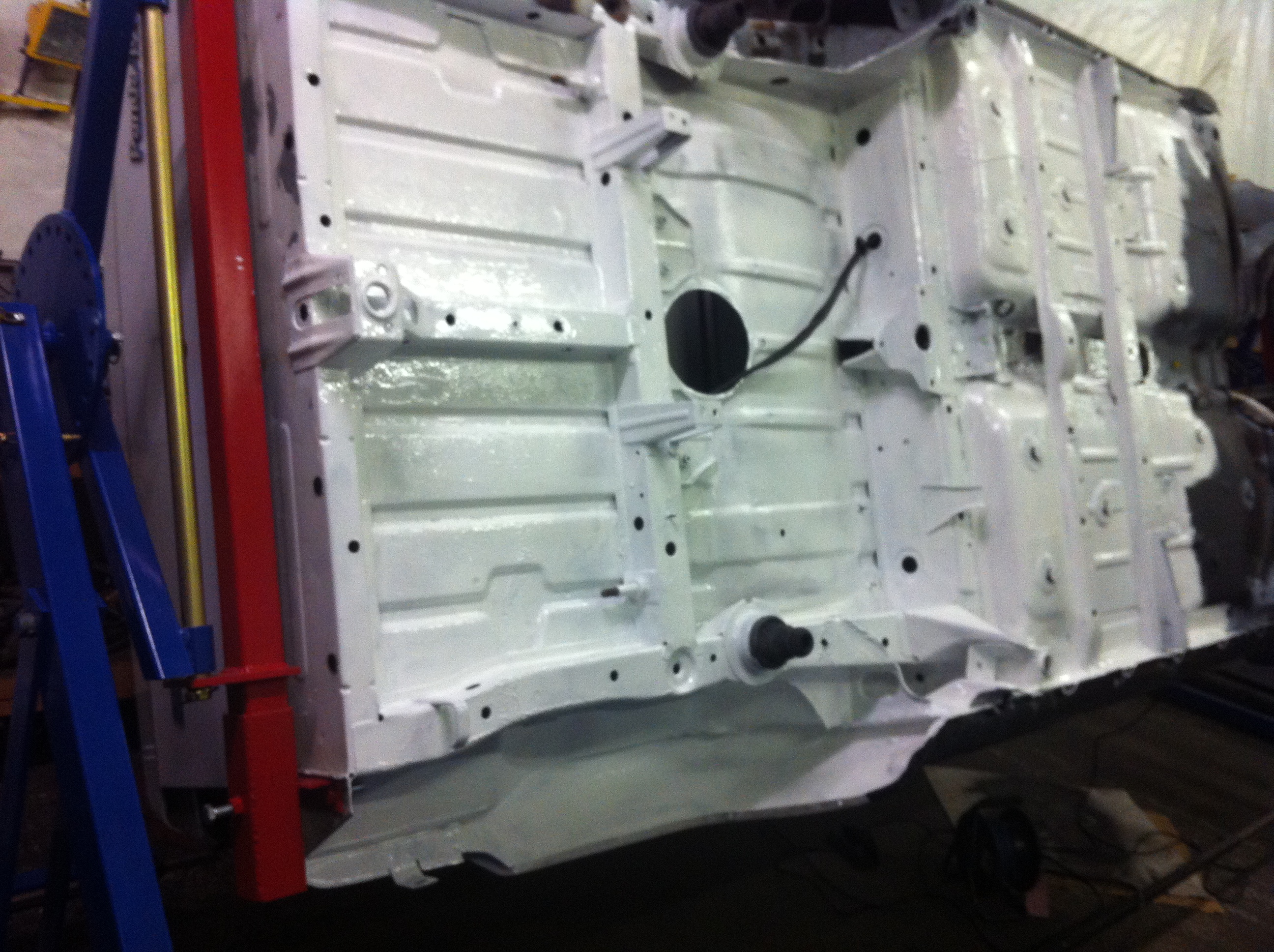

Finally got the de-rusting and zinc priming finished as far as the start of the engine bay........
So now I was able to start applying the epoxy mastic with a brush, a cheap brush too as it's cheaper to throw it away than it is to clean it! This is as far as I got before running out of the stuff........
Another litre is on its way. :)
Sorry to show off the chassis tilter , I'm really spoiling myself there :eek:, but with at least six cars lined up for similar work it will easily pay for itself, and make the task of doing floor pan work alot more pleasant.

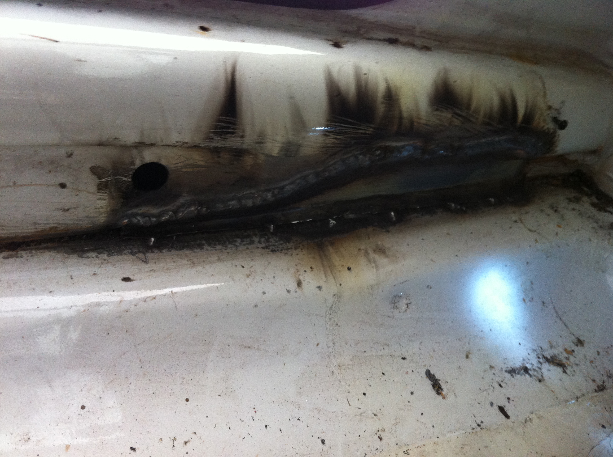

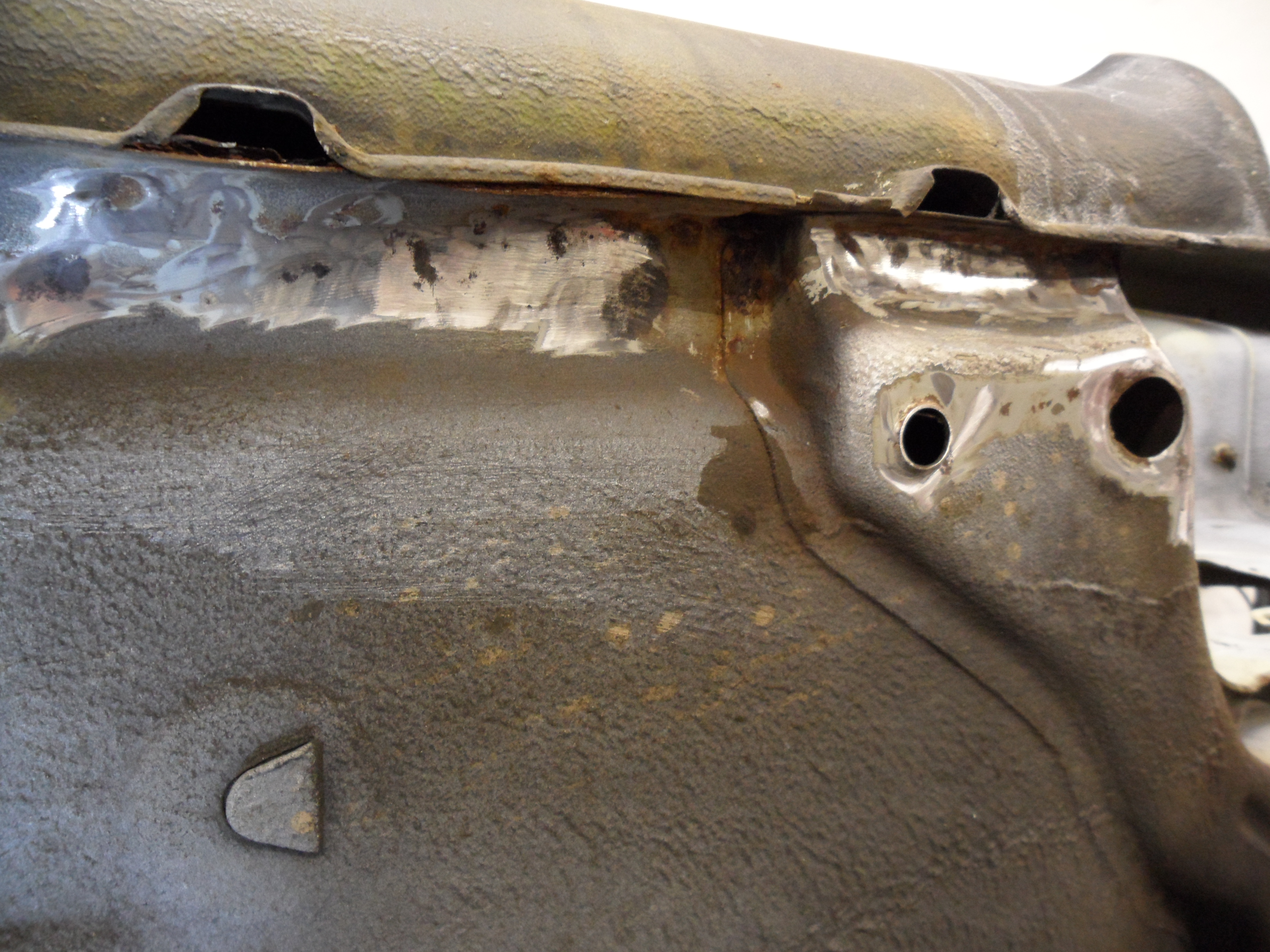

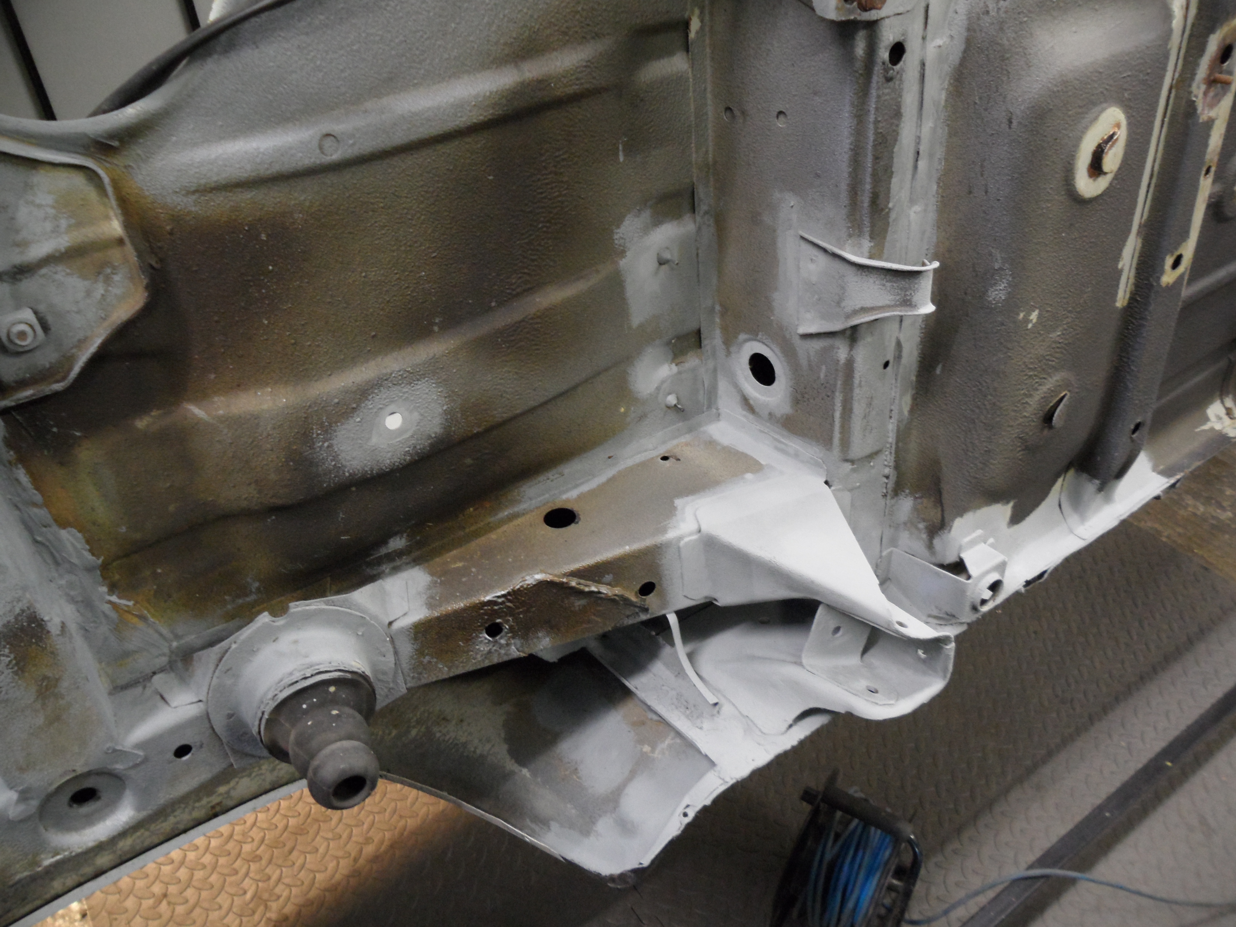

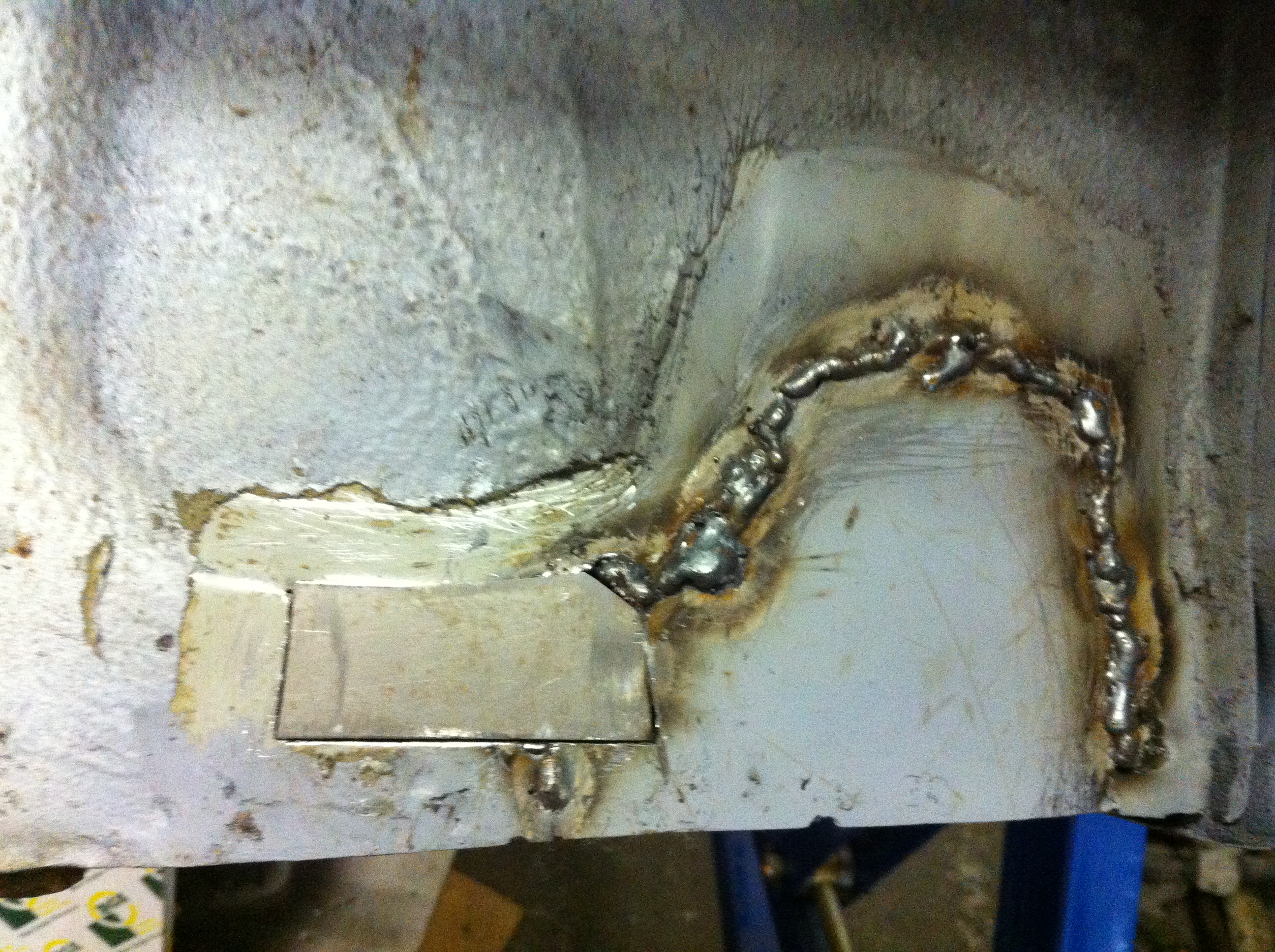

First off is a couple more areas of rust that needed welding...........
This is an area where the inner sill meets the floor. Barely noticeable at first which is why I had missed it on earlier inspections, but this was the size of it once we'd got back to good metal.

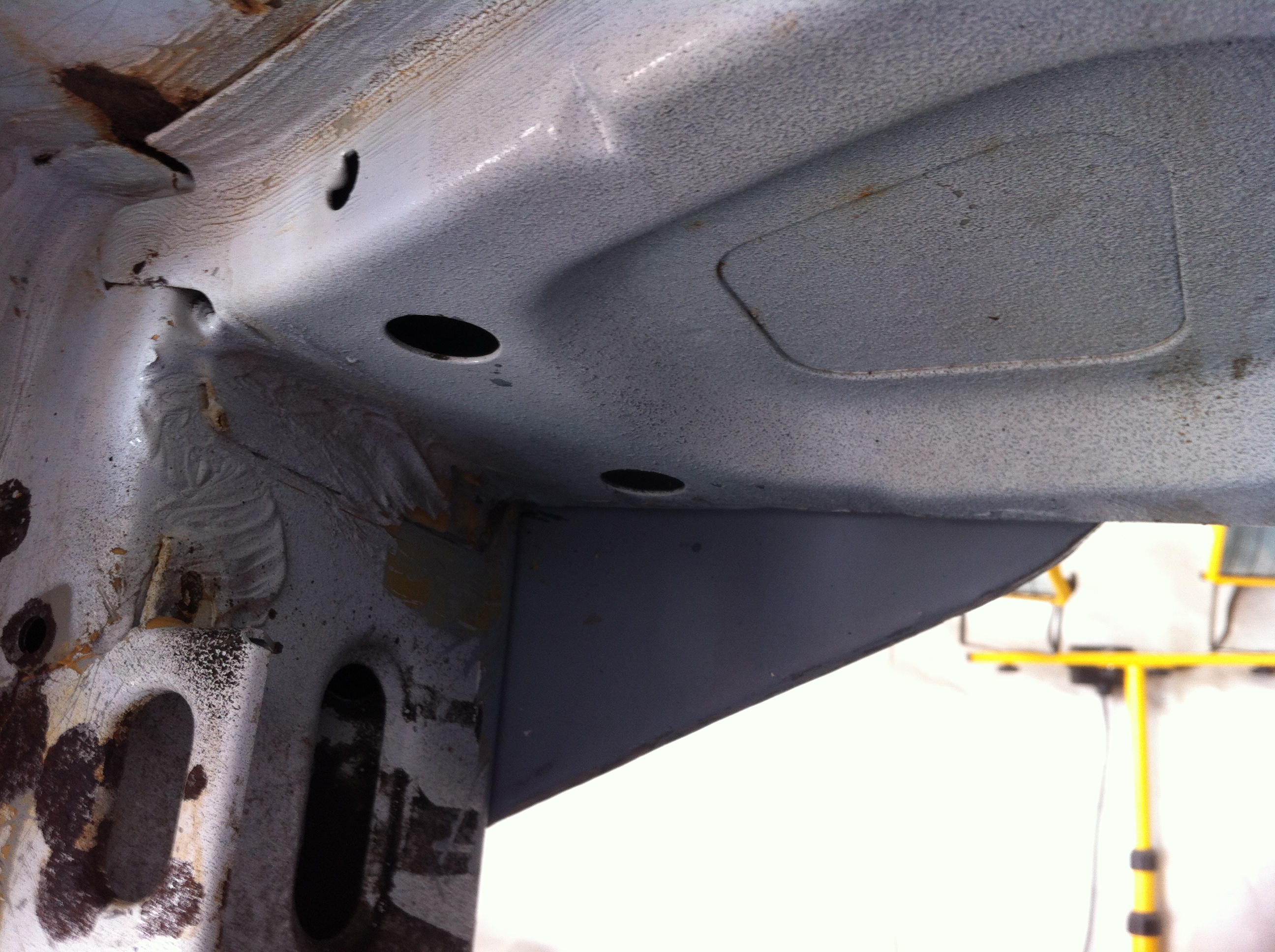

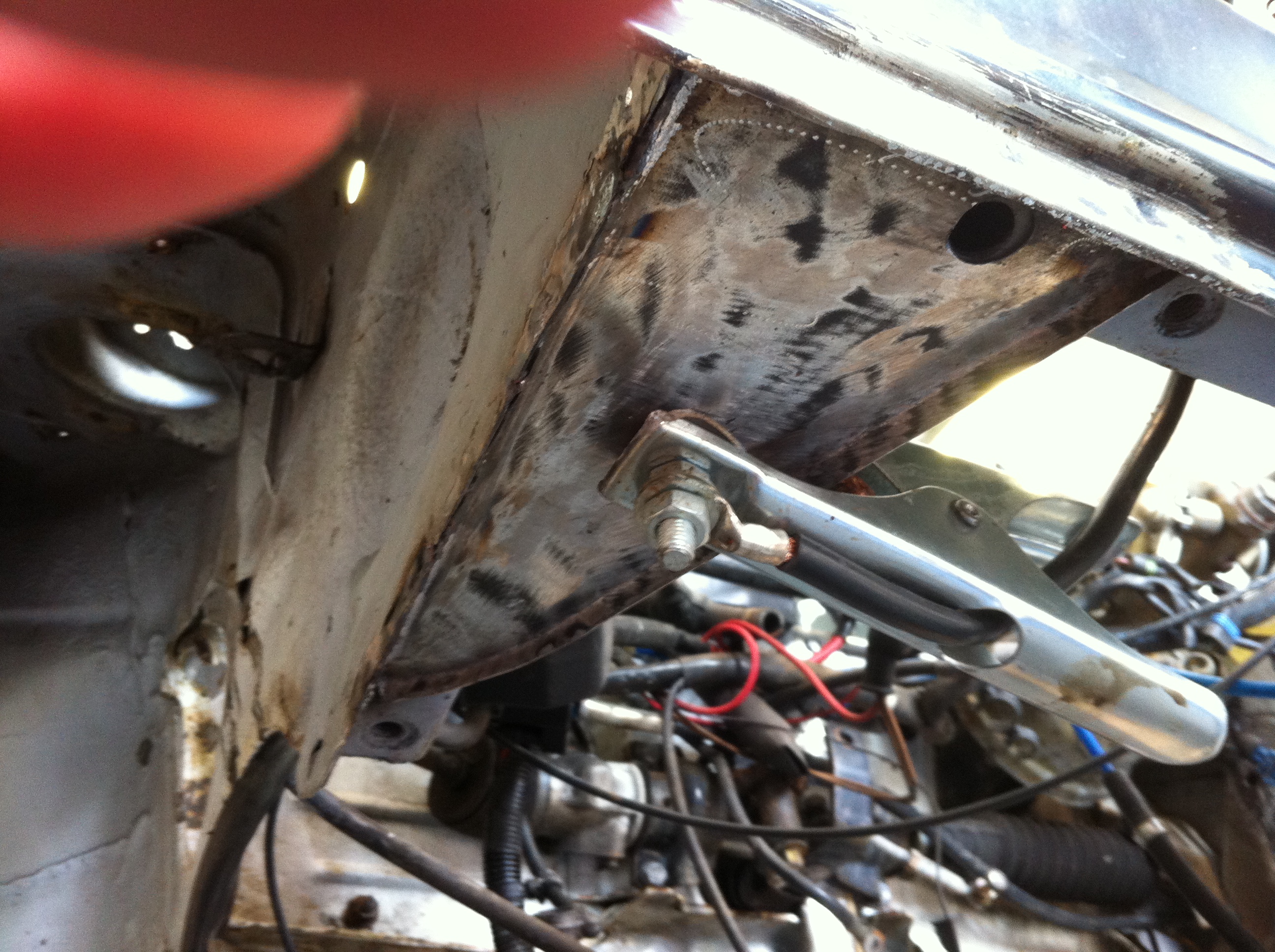

This odd triangle in one front corner of the engine bay had rusted where it was spot welded to the chassis, the only way to kill the rust completely was to cut it all out and make a new piece.
This section (in primer) under the o/s/f wheel arch covered a rusty hole that grew even bigger when I tried to weld the back edge, so another piece was needed before it was finished.......

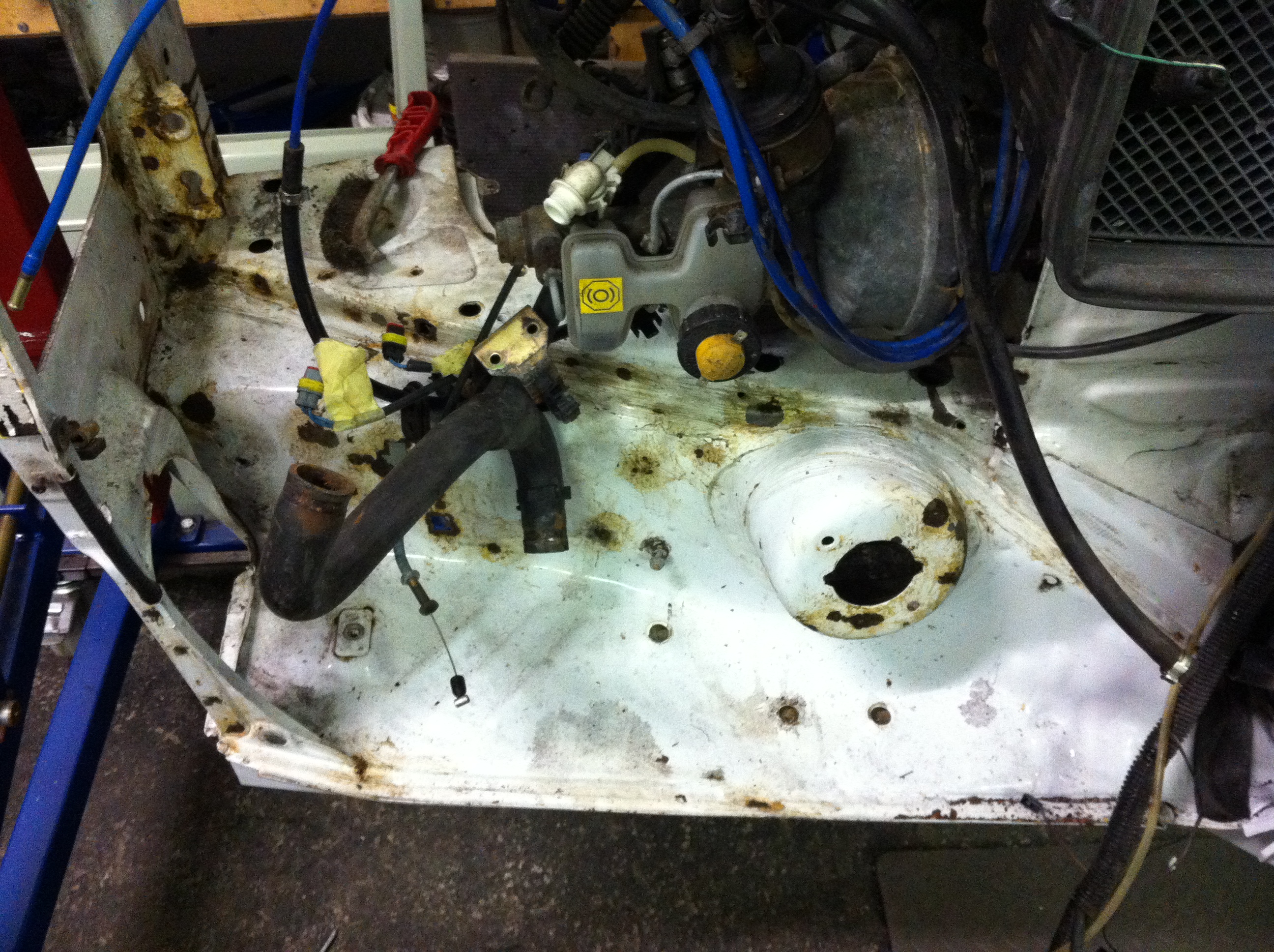

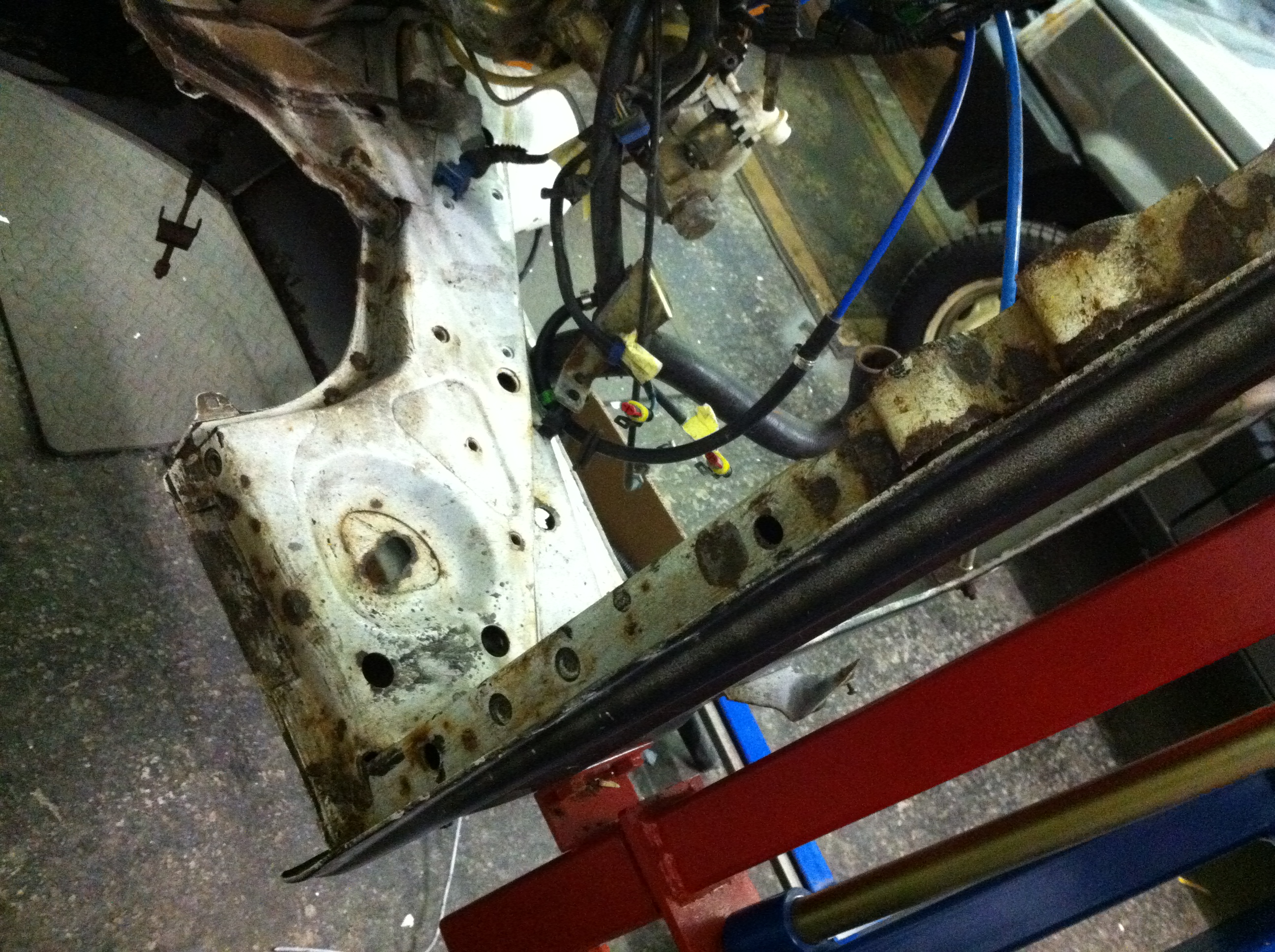

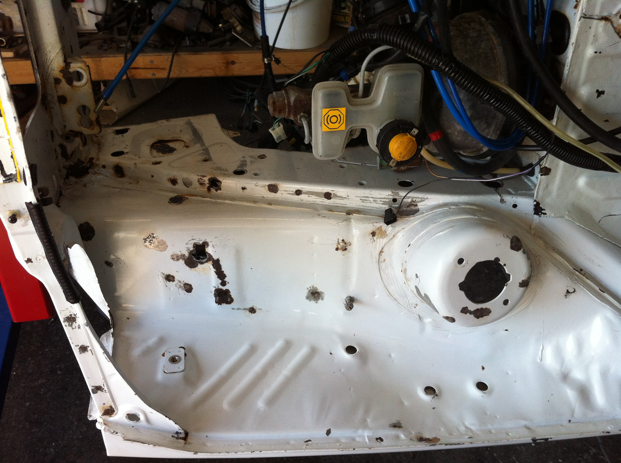

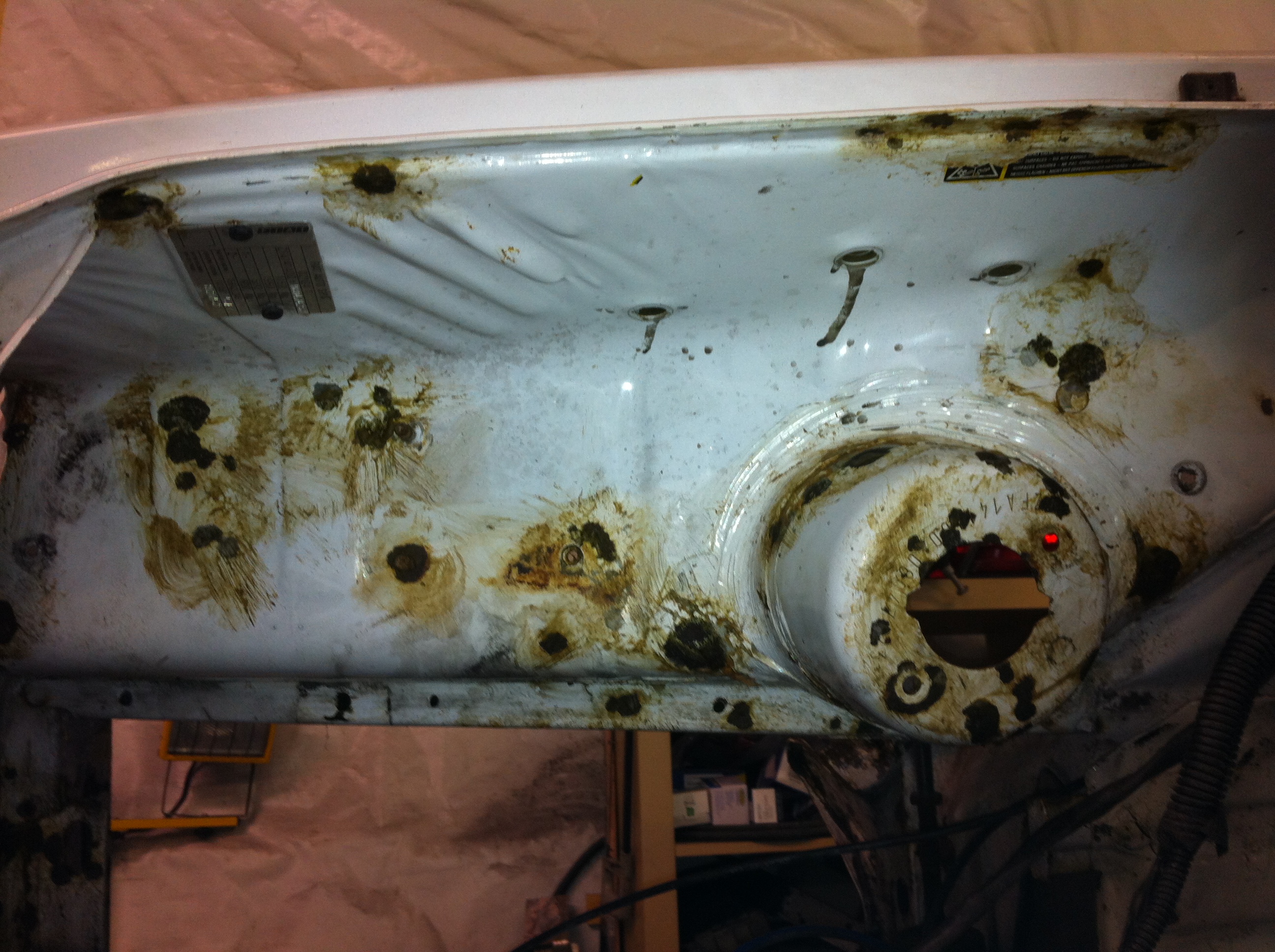

Next it was on to the engine bay.......

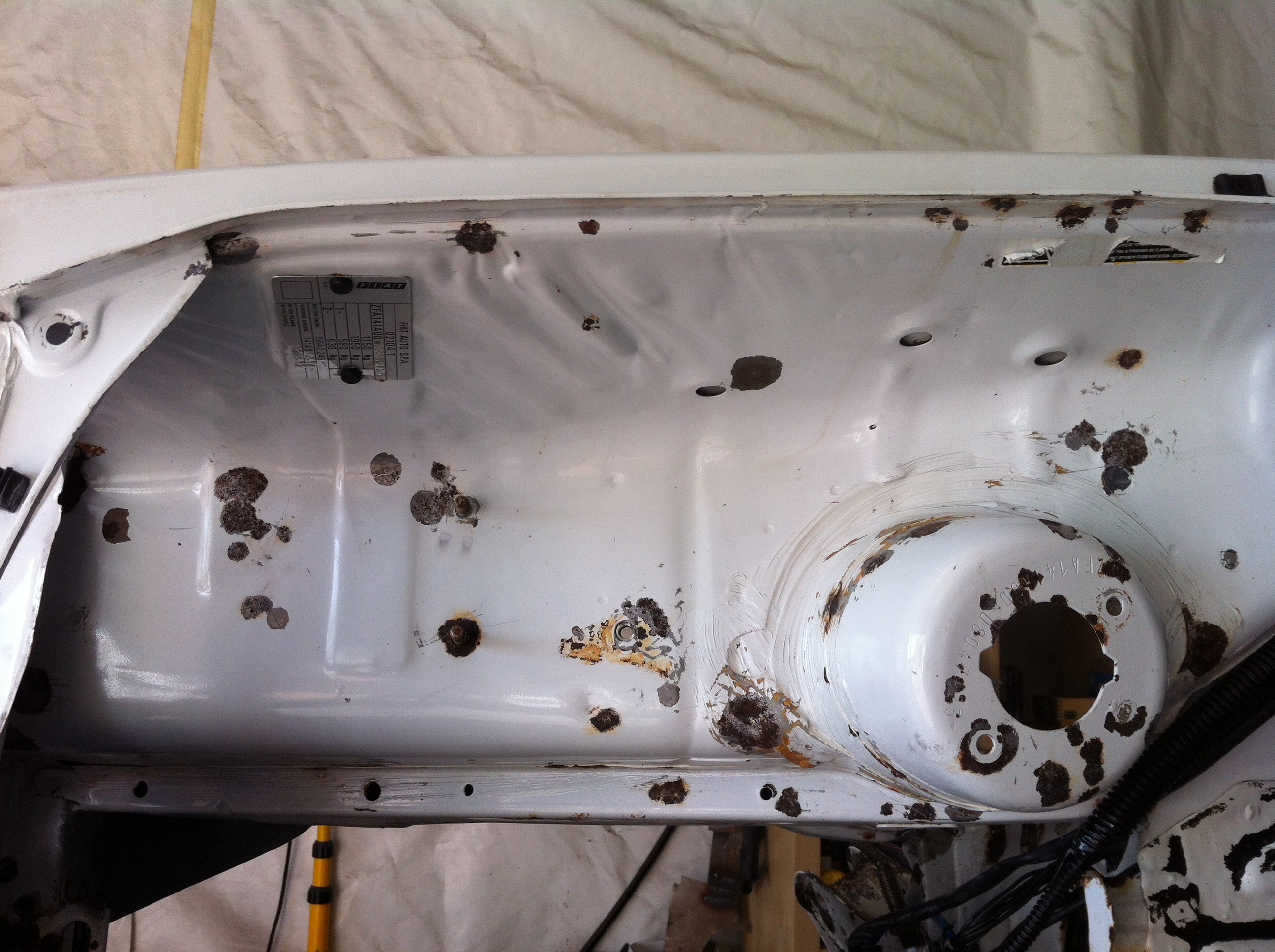

Front panel and inner wings were covered in rust scabs, not deep or seriously rotten, just ugly. The pics above show them treated with Deox C gel, it's the liquid in the rust bath but in gel form.
Once this had done its job rust converter was applied to what was left......

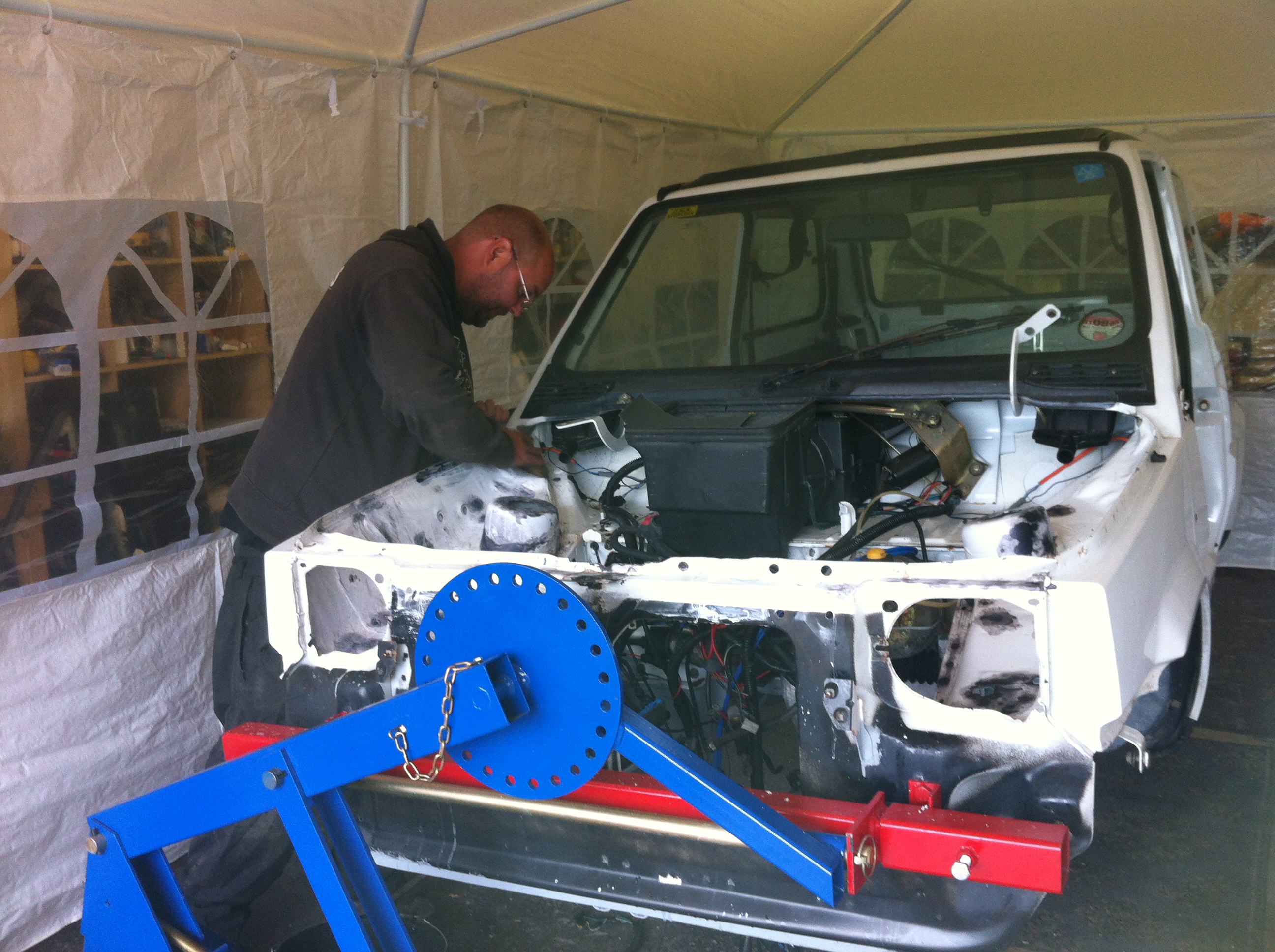

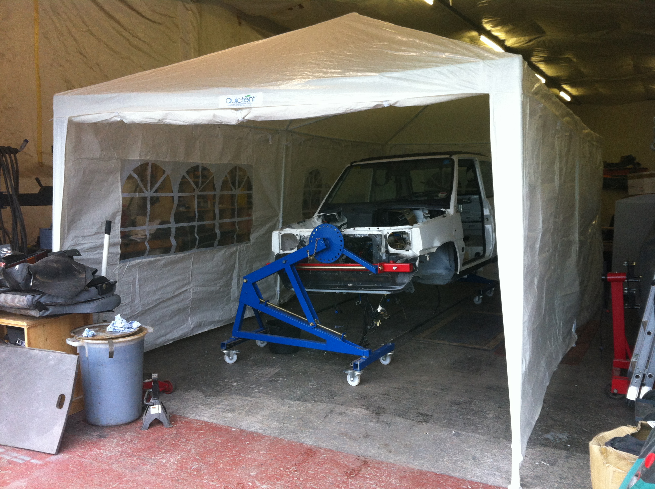

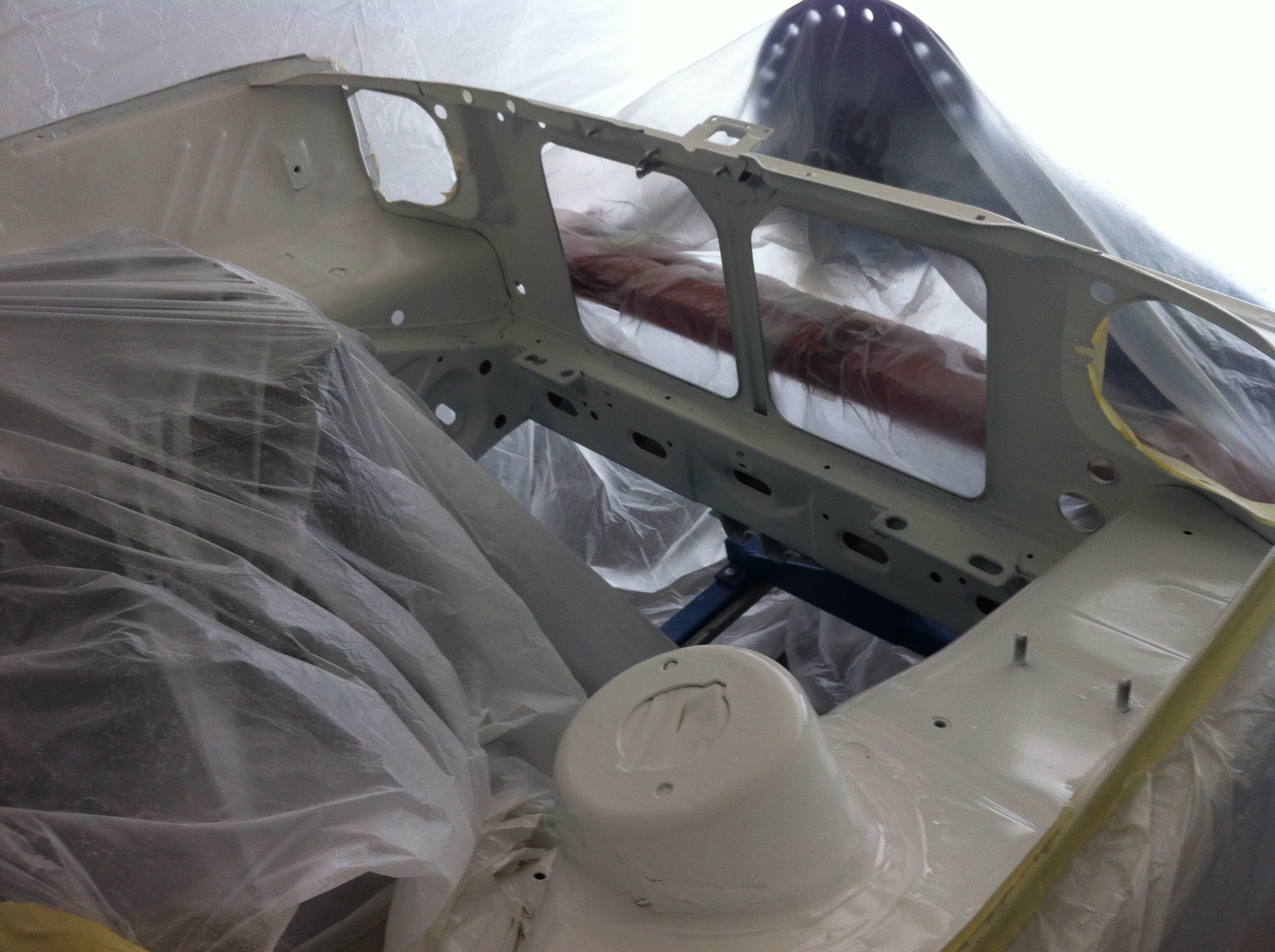

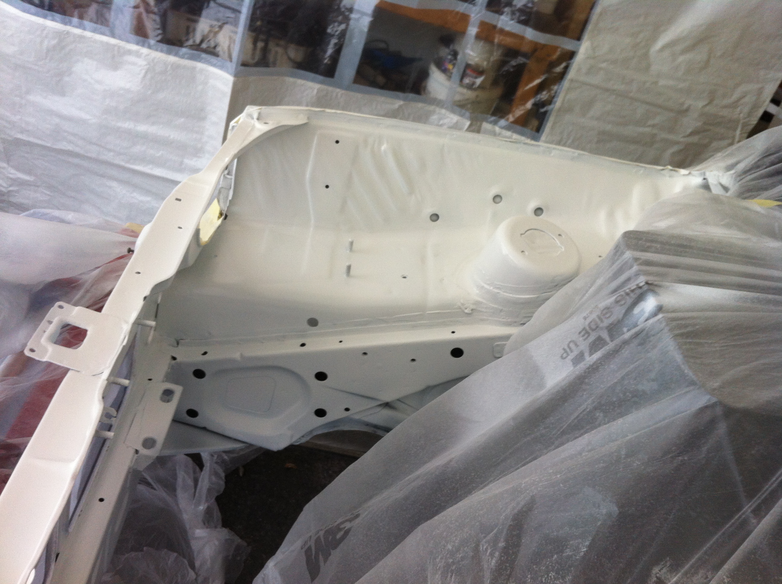

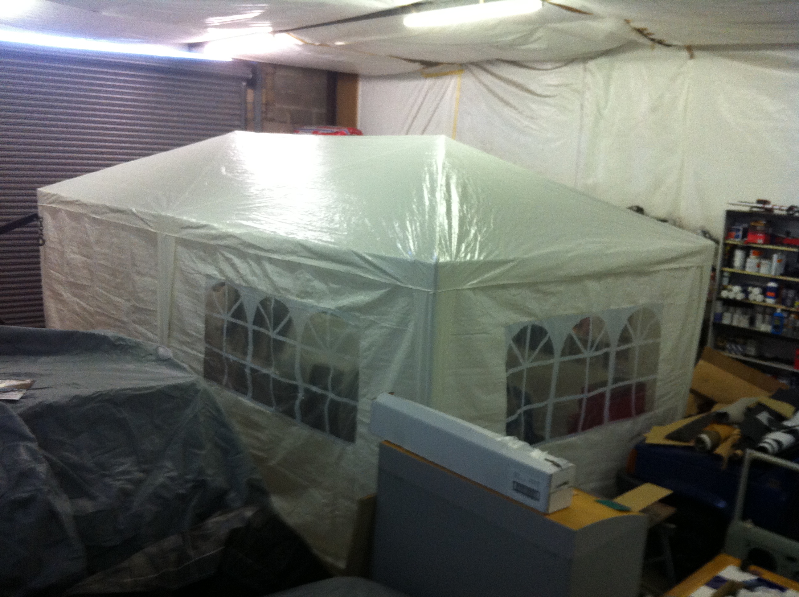

I have two new things in the workshop......

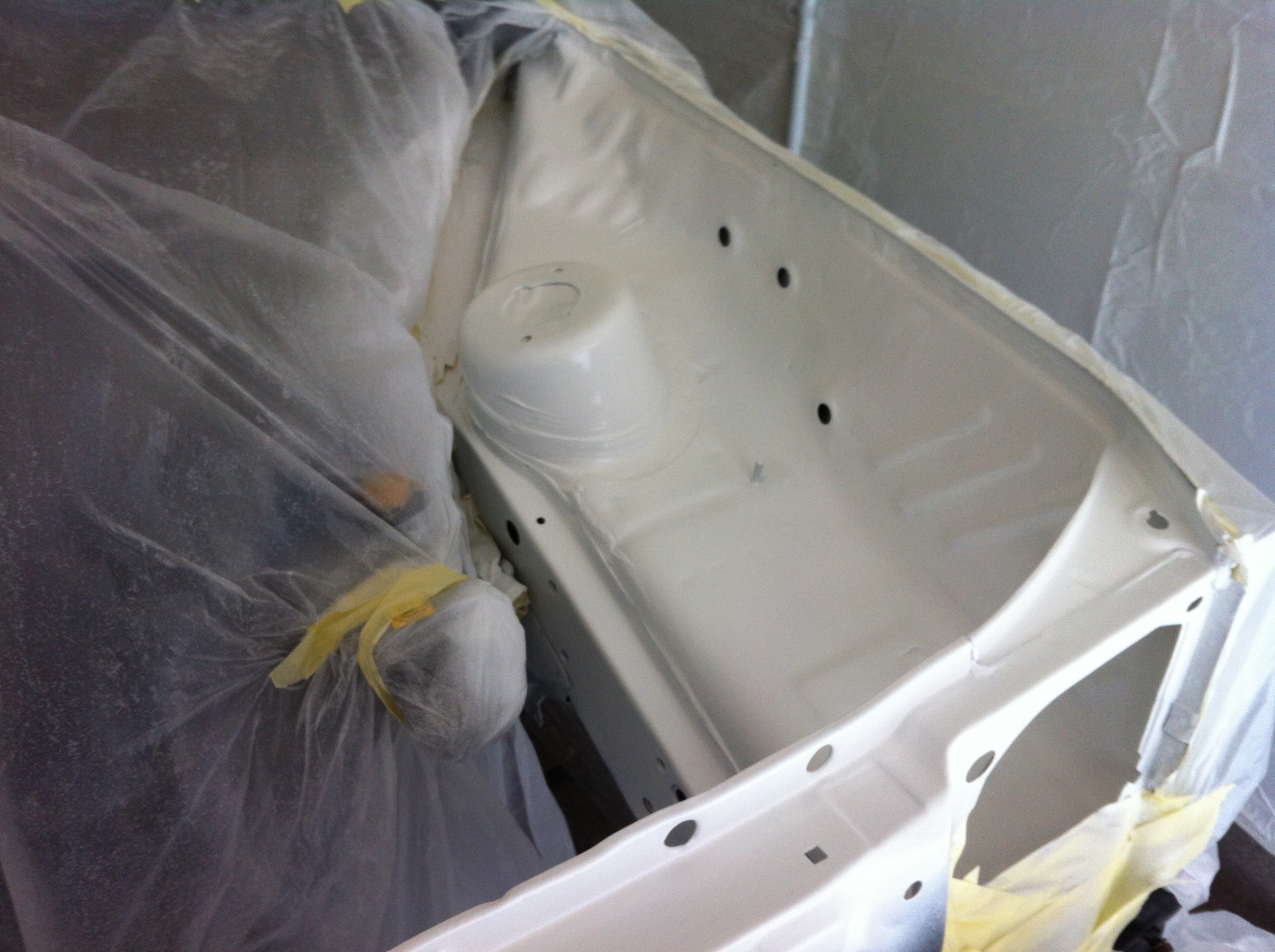

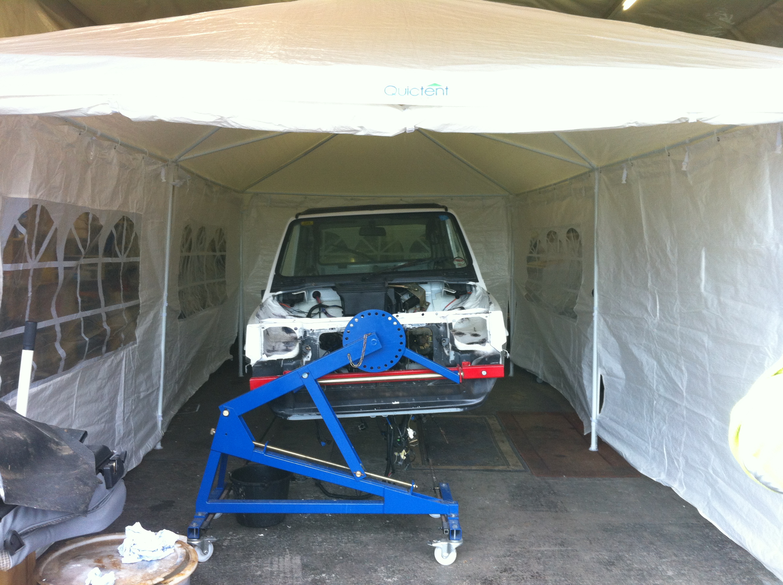

1. A makeshift spray booth to make sure nothing else gets covered in overspray.
2. A helping hand called Alan.
Both are shown in the next bunch of pics. Pete has been helping out recently too, but next week he goes back to work for McLarren. :(

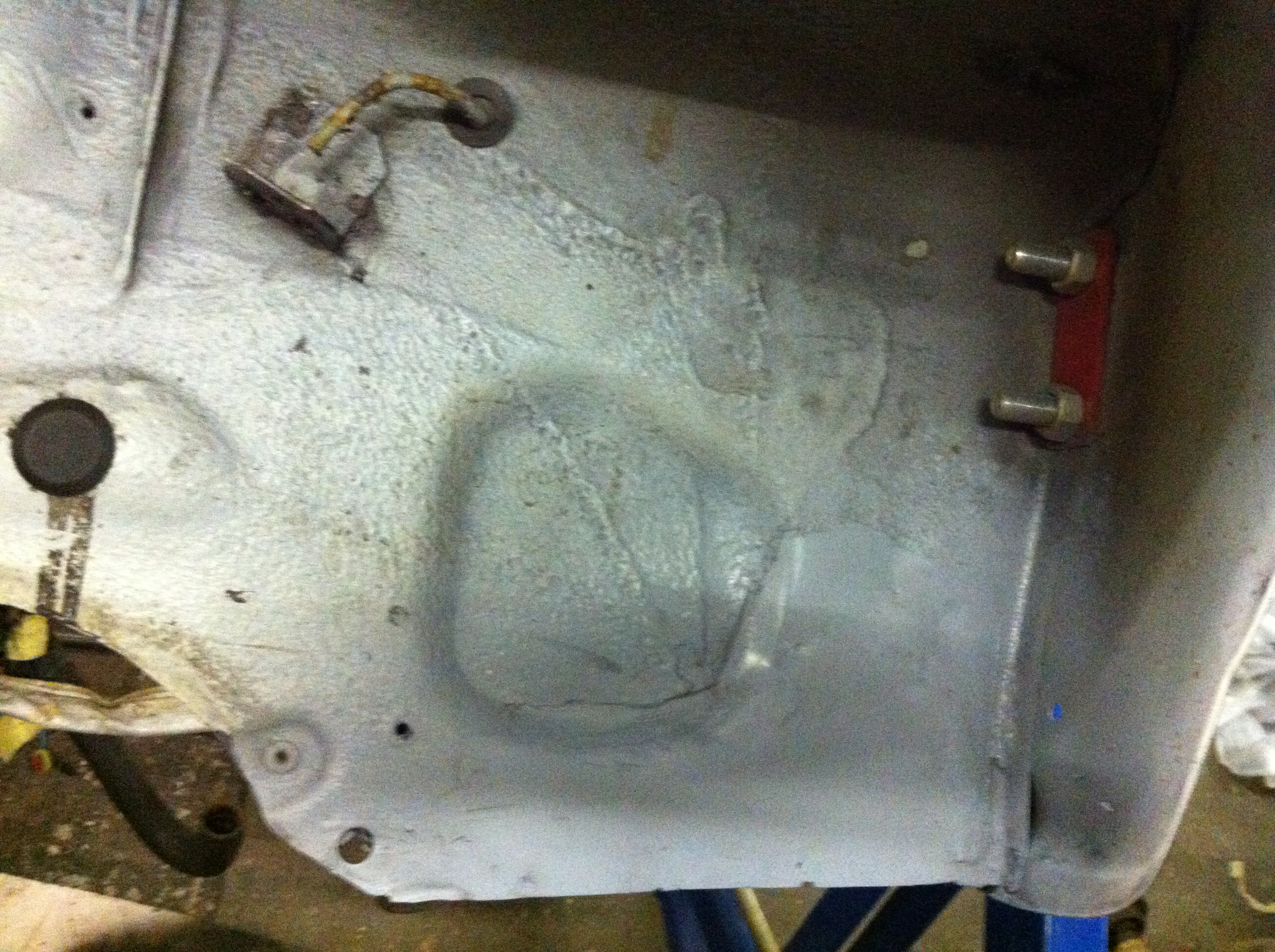

First job to be carried out in the booth was to spray the inner wings and inside of the front panel. We've used epoxy primer in white, very tough stuff. :)
Top coat should be going on tomorrow, will post pics once done.

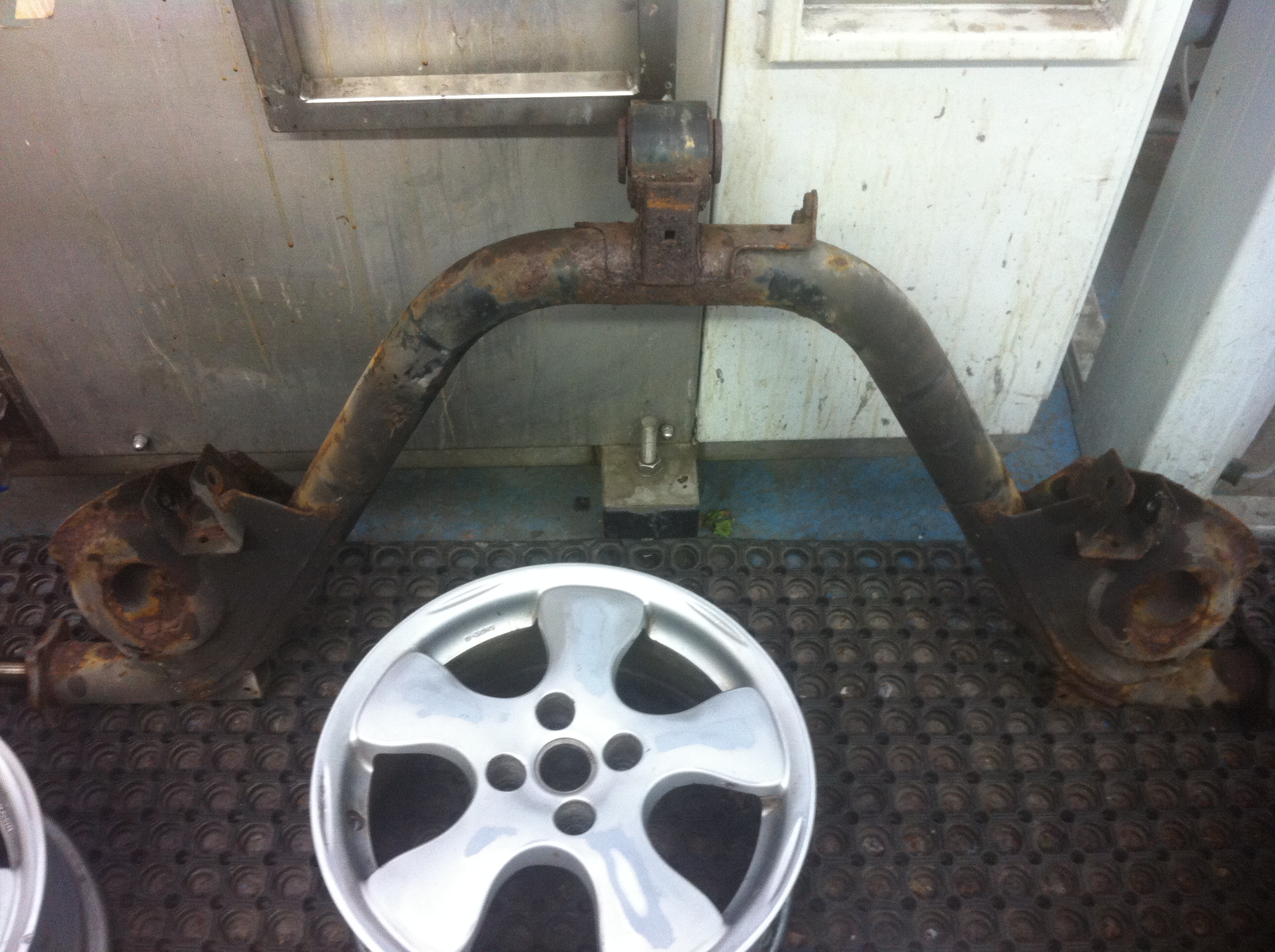

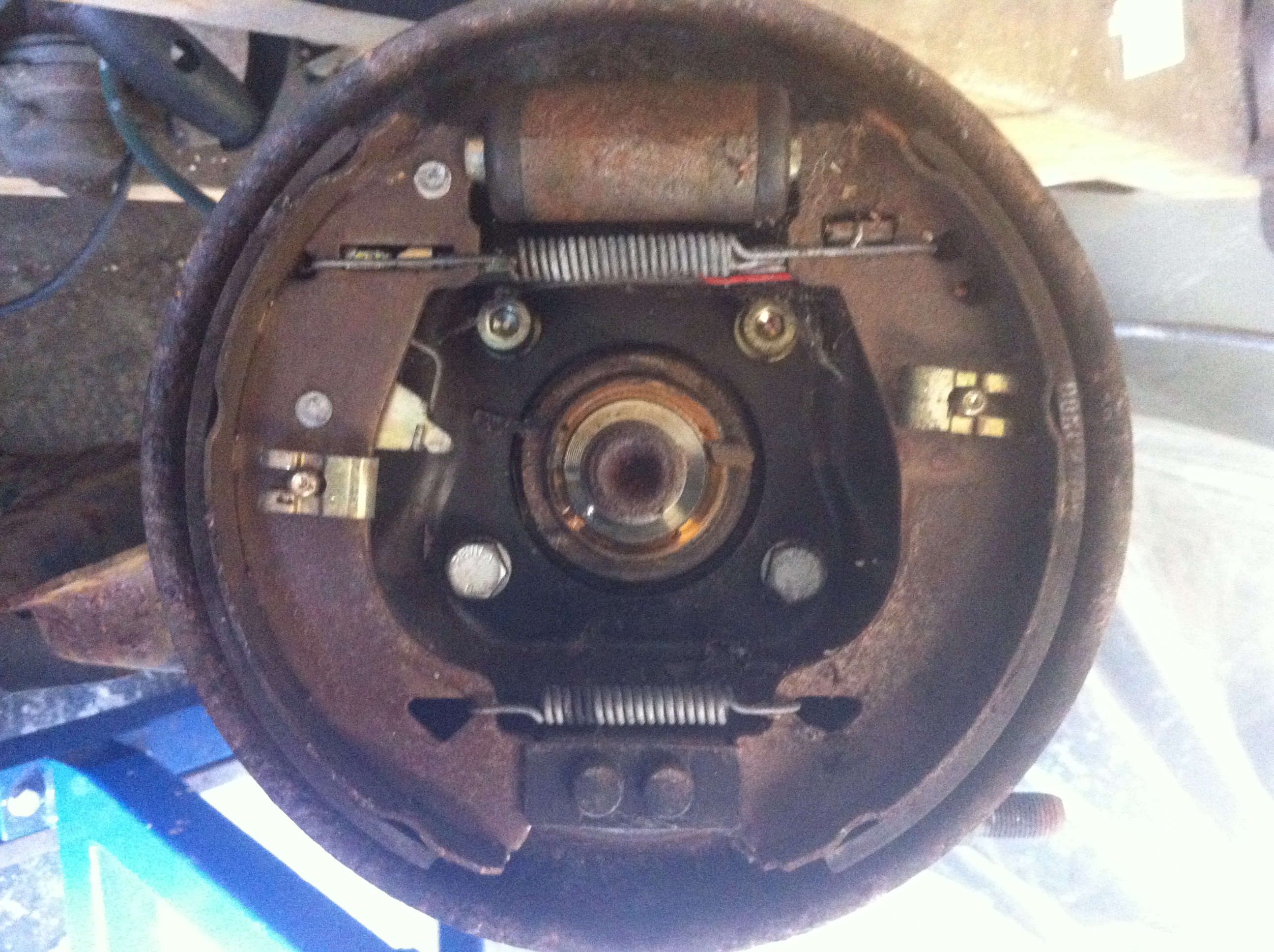

Back axle is now stripped and at the powder coaters. It's not going to be powder coated, this project is too far over budget as it is :p, but because of its size I felt that getting them to sand blast it will be a big time saver.
I'm leaving the brakes in one piece for now and will deal with them as an individual item.
In fact I think I'll compare them with the donor Punto's brakes to see if there is a worthwhile upgrade to be had.
