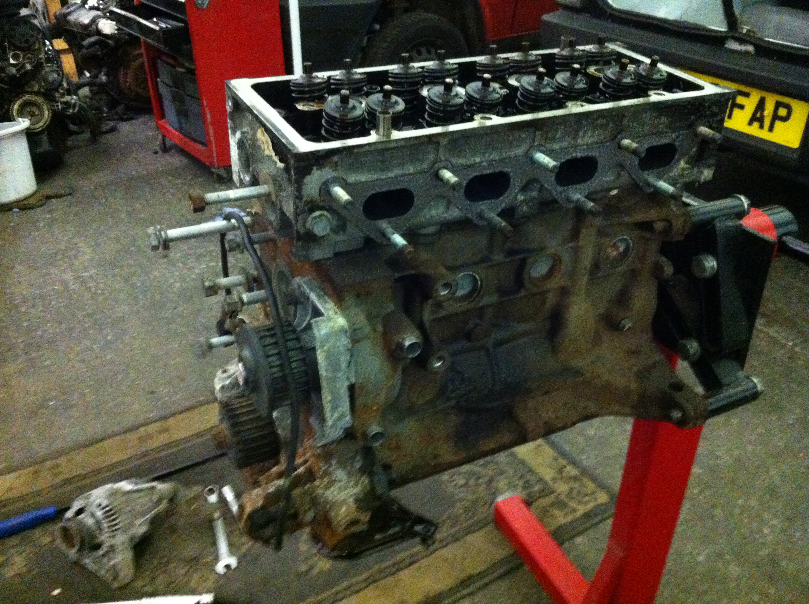

Well today I stripped down the engine in order to renew the head gasket, cambelt and tensioner, and all service items. Rear crankshaft oil seal needs renewing, as does the sump due to rust. (n)
This is how far I got .........
Unfortunately I could not remove two of the cyl. head bolts due to my bit breaking. The bolts are actually the 'Ribe' type but as I didn't have Ribe bits I was making do with a Torx bit. It was working fine until I got to the penultimate bolt, then :bang: Will be replacing it tomorrow as well as getting the right tool I think.

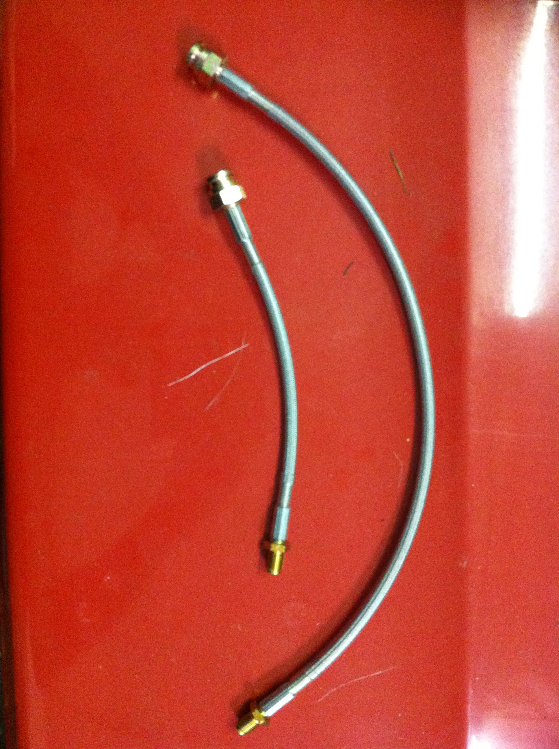

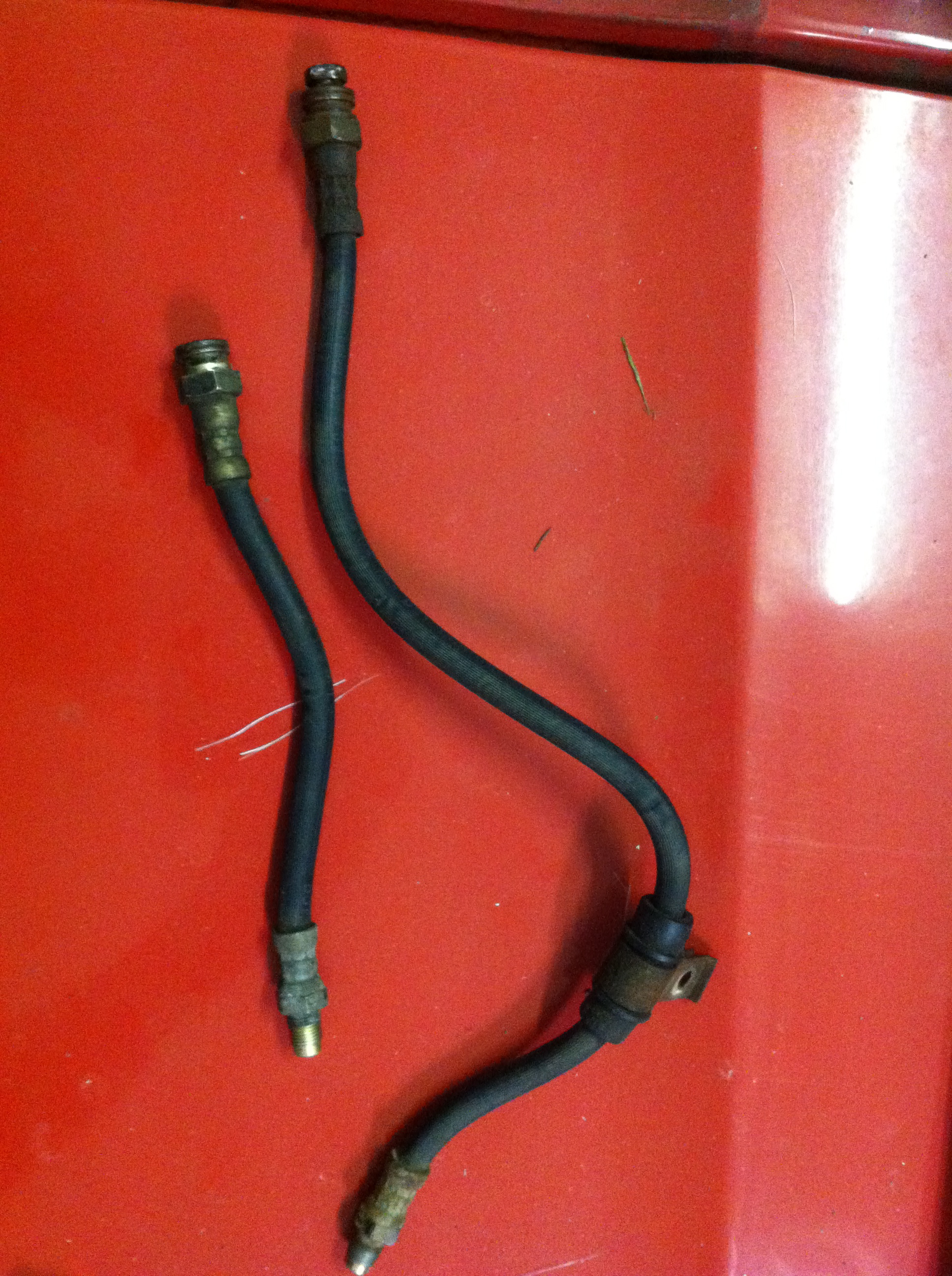

Also picked up some brake hoses from Hampshire hose services. I'd dropped off the originals last week and they made me two sets of Goodridge hoses to match. For those that don't know Goodridge hoses are aircraft quality stainless steel reinforced, they can withstand much higher pressures, last longer, and look pretty :cool:
These are the originals......
These are a set for the blue clx in the usual silver........

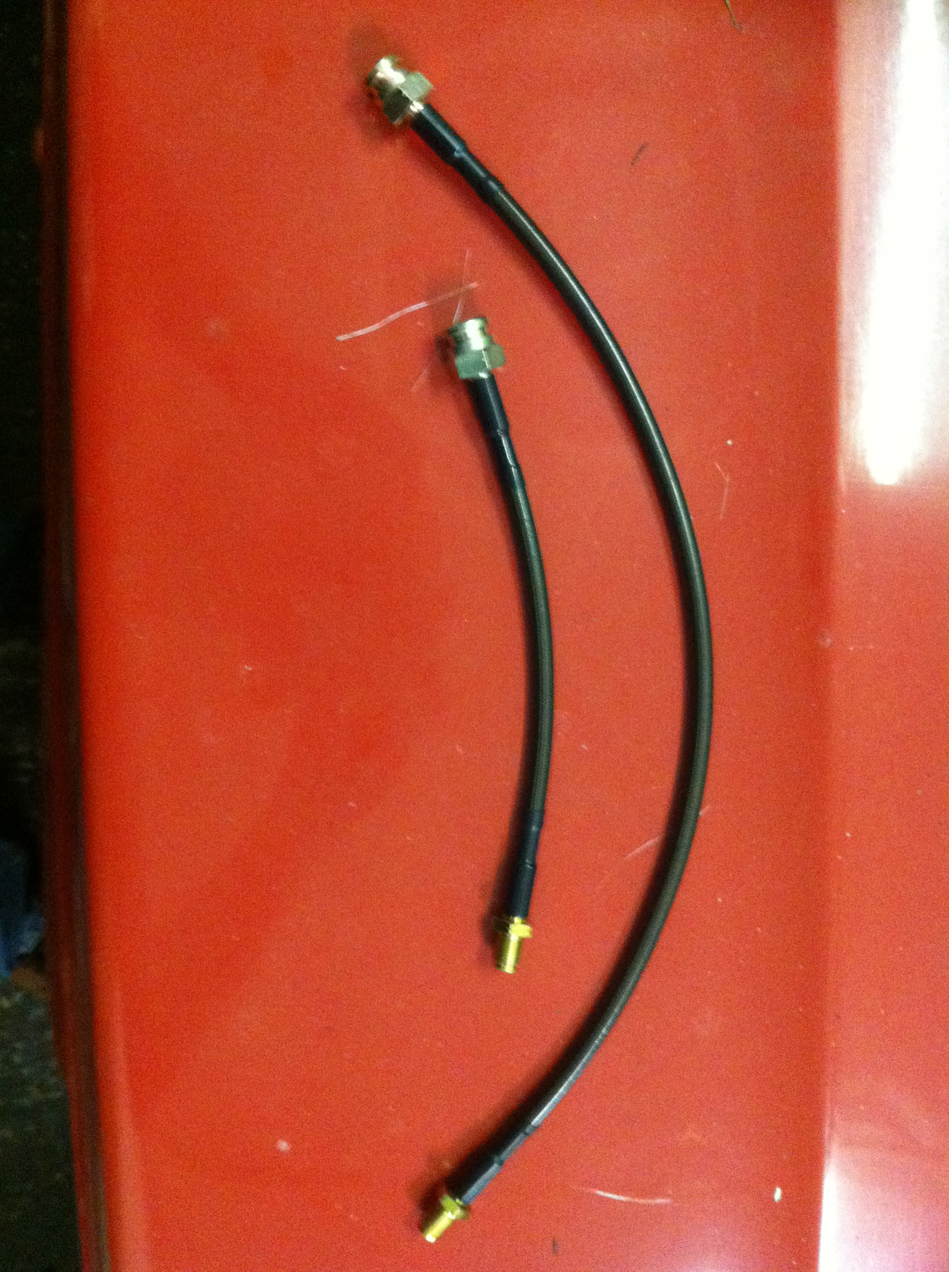

And to keep to the black and white Panda theme for this project I got these.....
They are covered in a semi transparent black plastic sheath, kind of look like carbon fibre, so will look much better for Panto.
Of course there are actually three hoses per car, two fronts (long hose) and one rear, but you didn't need to see them all now did you.

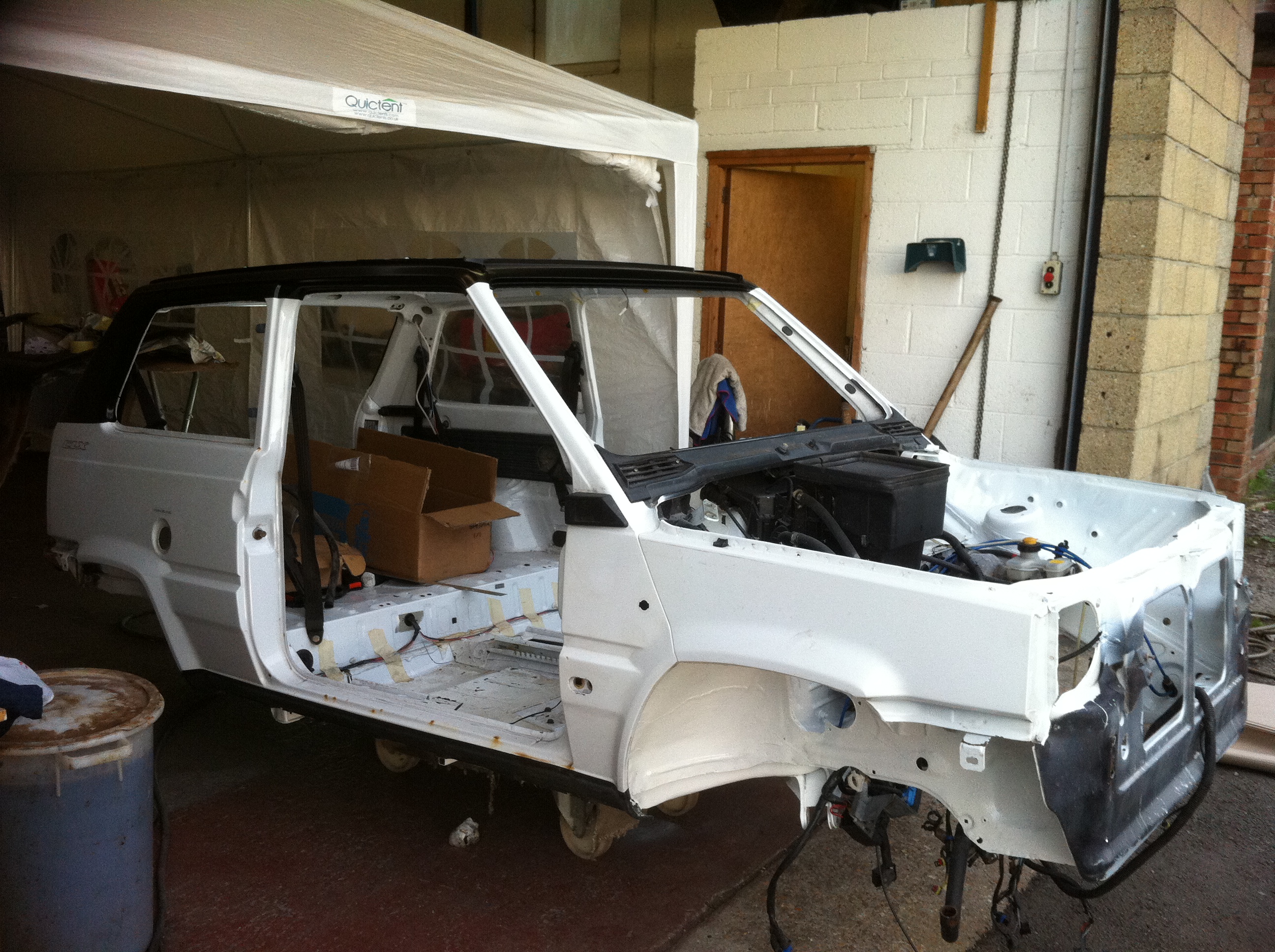

Well Pete popped back to do a couple of jobs today, one of them was to paint the roof of Panto........
I've been looking forward to this bit as it will really hint at what the final look will be.........
The top of the tailgate had to be done too......
The black scuttle under the windscreen stayed black in my design but I'm now having second thoughts and think that maybe it should be white, hmmm.
Reminds me of a mk1 Range Rover except that roof should be vinyl not paint!
1 vote for white scuttle here, and black and white faux fur for the dash :rolleyes:
I've always thought that the the Panda has more than a passing resemblance to the MK1 RR - particularly the rear lights and the clamshell bonnet, and particularly in 4x4 guise. This car is going to look really special. A black Panda with a white roof could look really nice too - like the Italian Carabinieri ones.
Scuttle will be white.
We are not going for a '70's Cortina look, so no vinyl! For similar taste reasons fur of any description is banned - on seat covers, dashboard, roof lining, floor, or as fluffy ears.......it's not a C*apri after all :D
