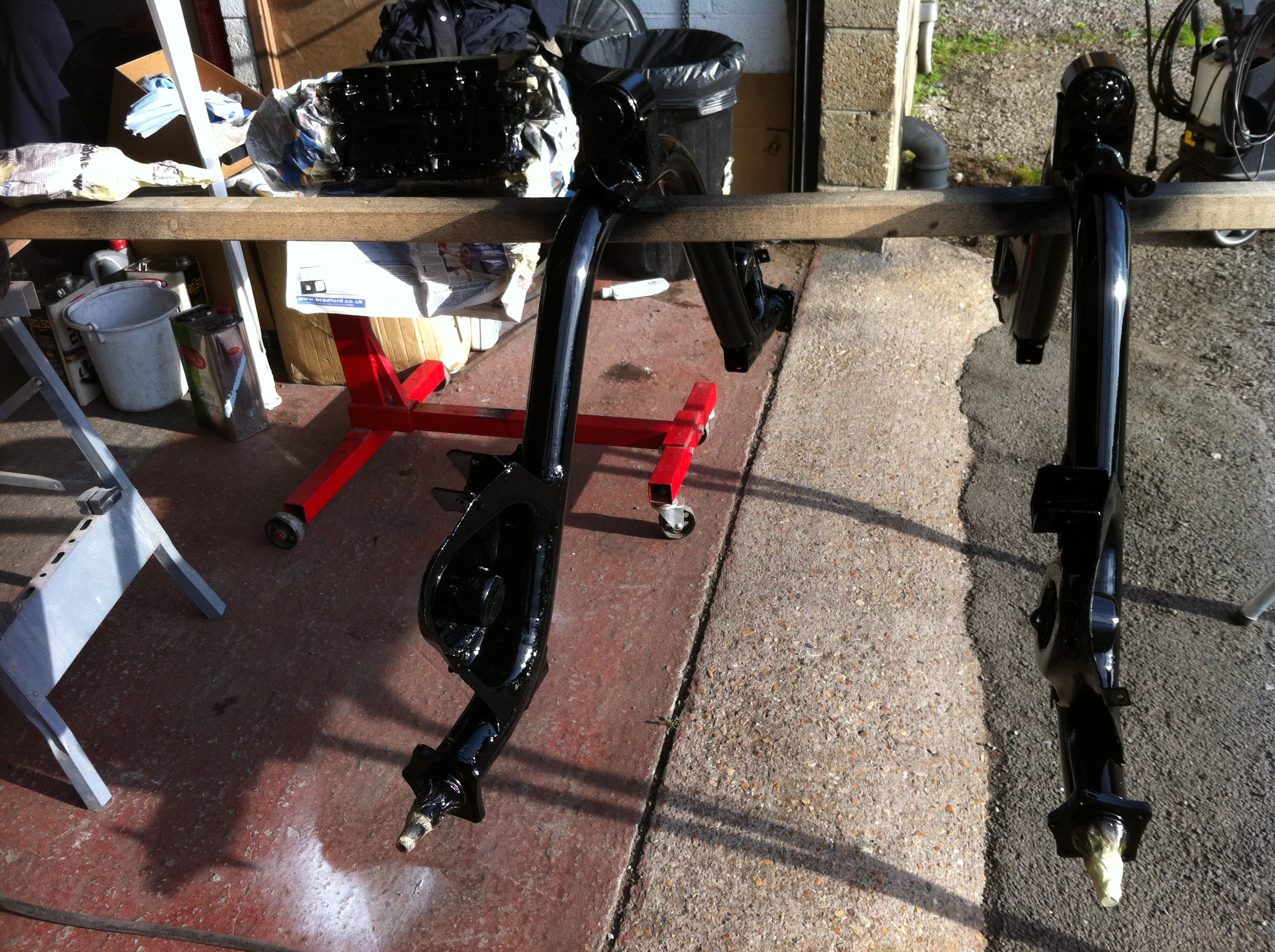

Well the last couple of days have been very musical due to various Panda parts hanging from a wooden pole and acting like some weird giant wind chime. They were actually drying after being painted in epoxy black to make them a little more hard wearing and resistant to rust......
No we're not doubling up on the axles, the other one is destined for Kev's Bianca but it's getting the same treatment.
You can also see behind the axles the engine block sprayed in the same paint.

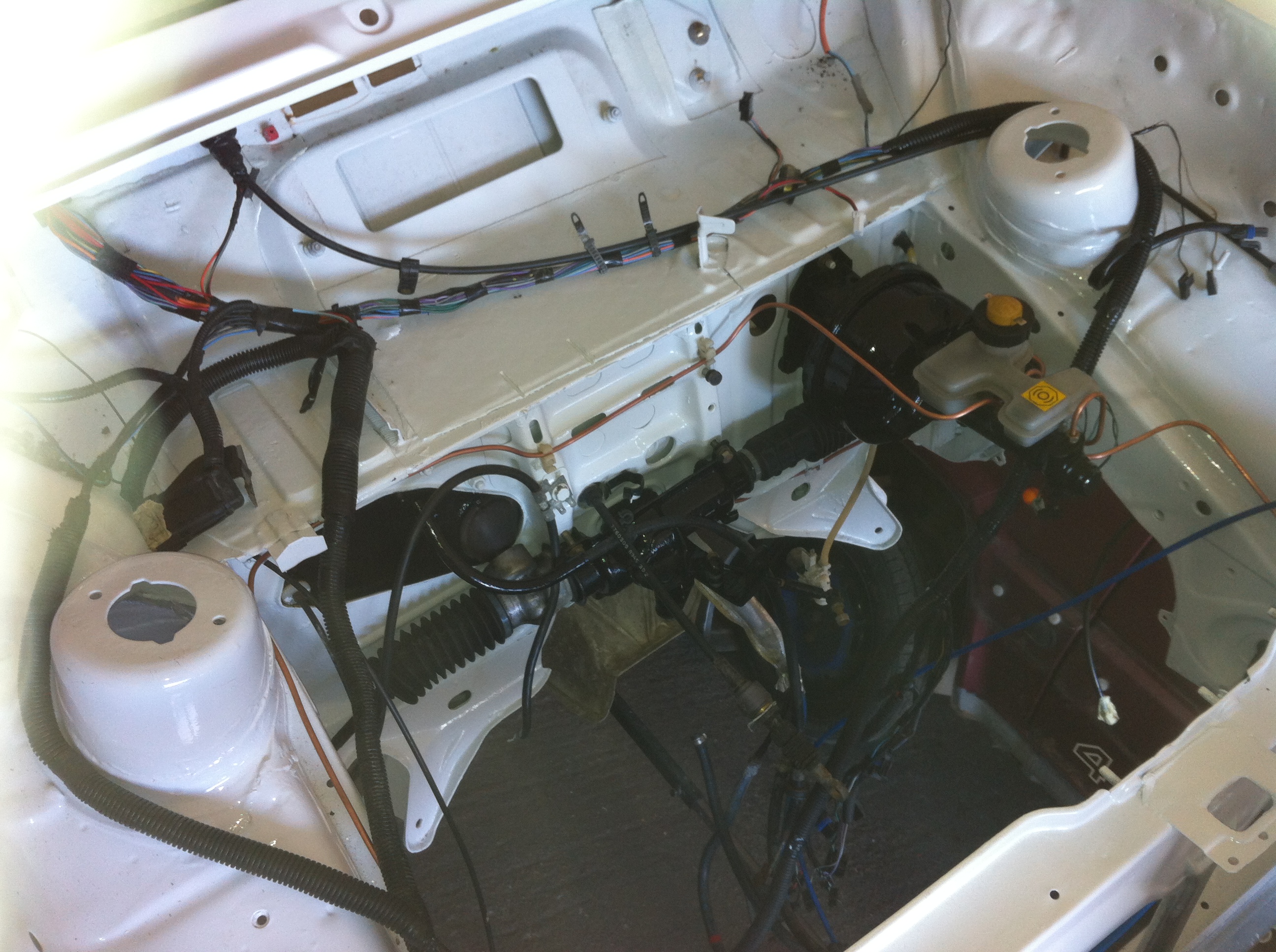

Few more pics of progress..........
And still we're finding more parts for painting!
Some of them have found their way back on to the car.

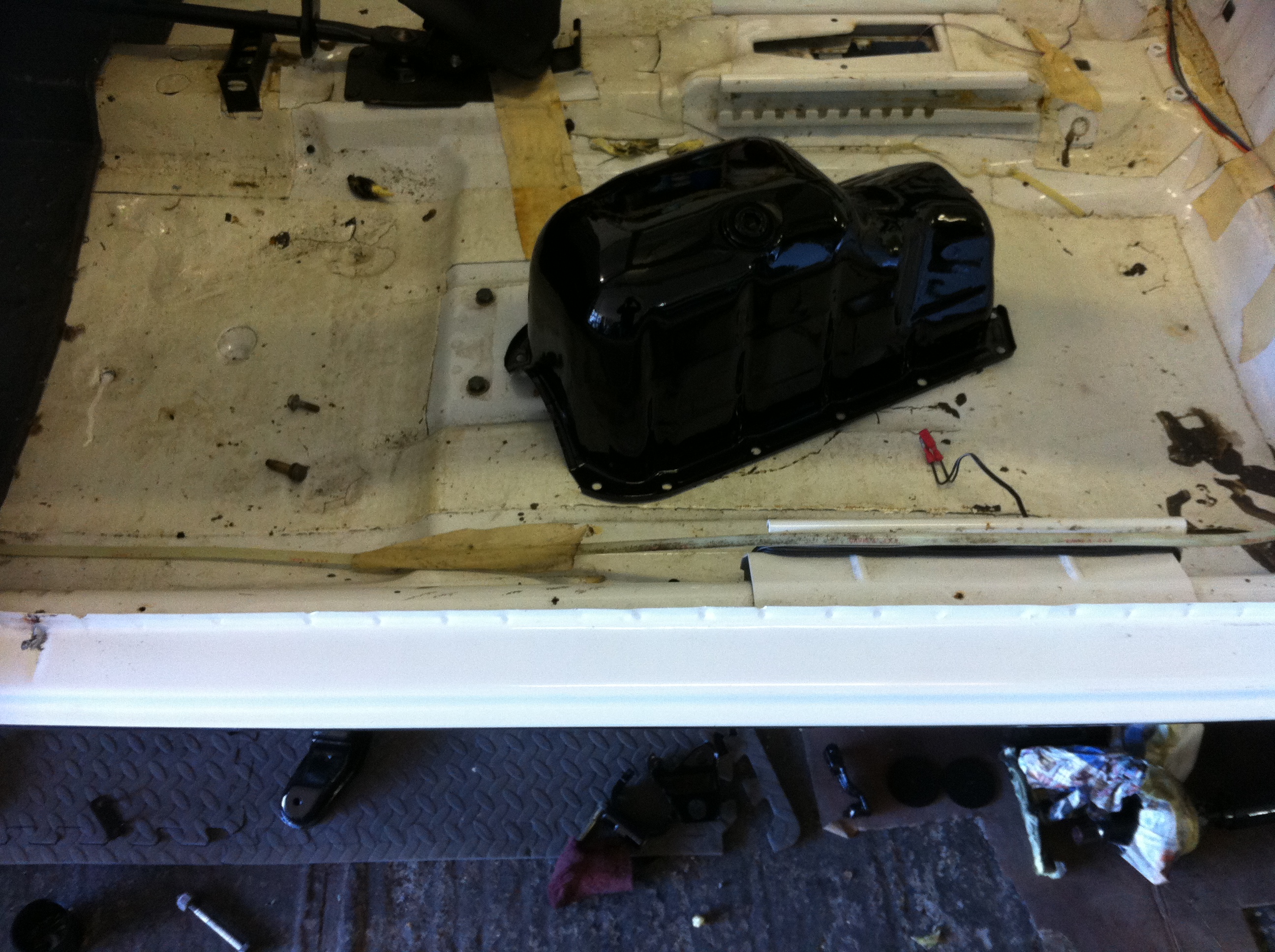

The sump was very rusty, as they tend to be on Punto's so a new one is being fitted, after having a coat of black epoxy too. The picture also shows the newly painted door steps. They had a few rust spots and scratches so needed a good tidy up.

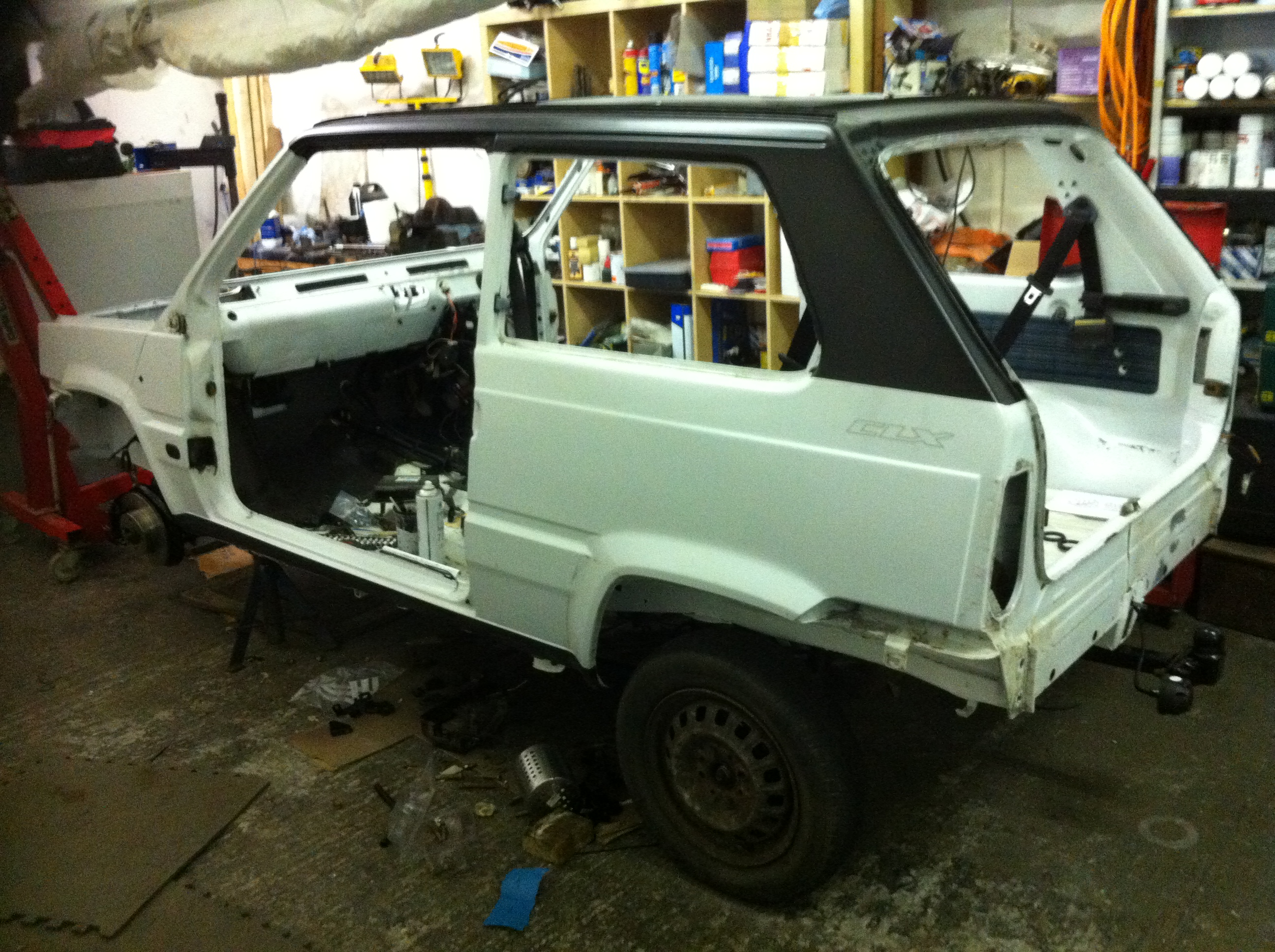

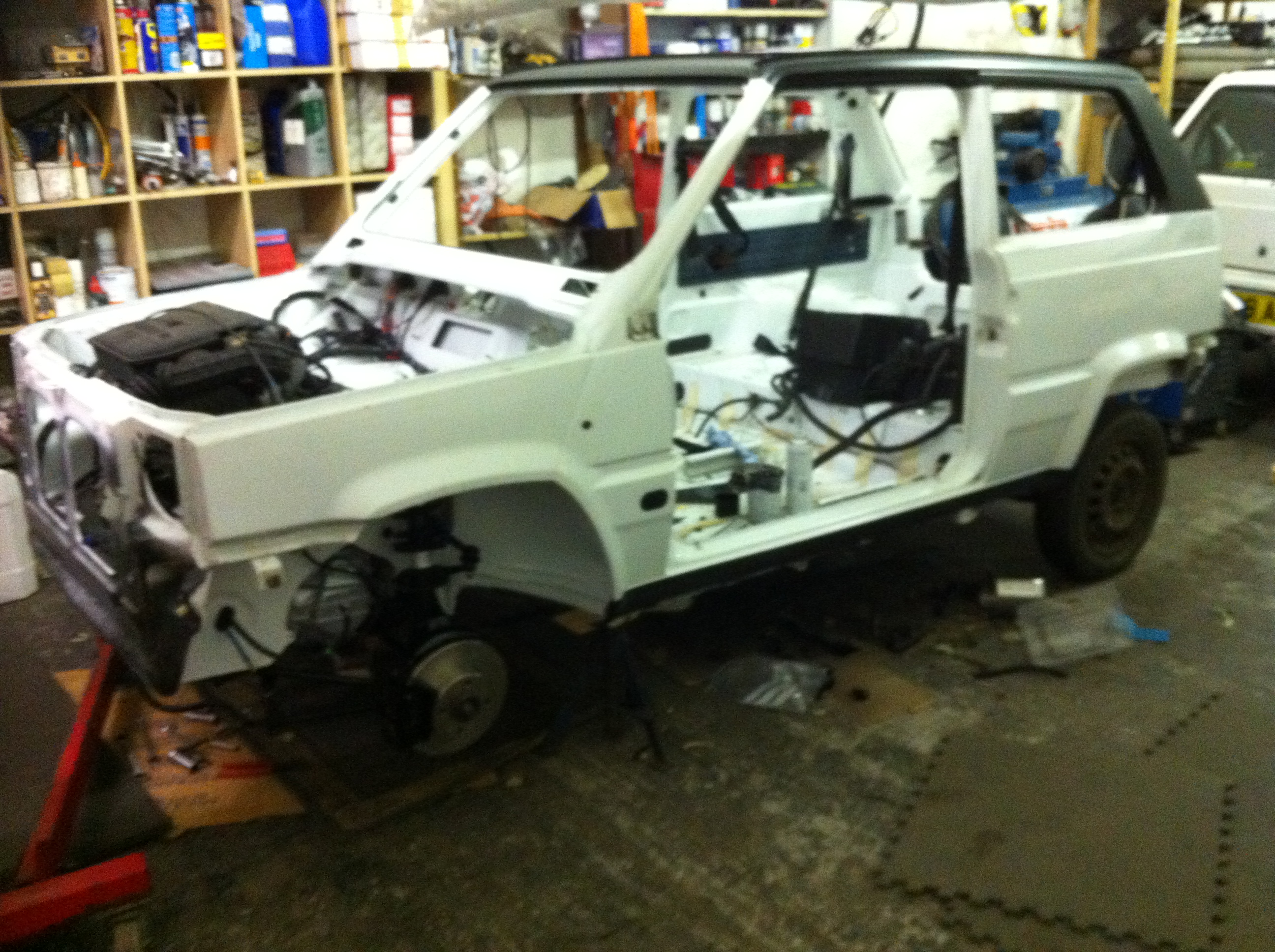

The black scuttle has now turned white. I had left it black in my original design but felt it was an area of black that wouldn't really fit, fortunately Gavin agreed when he visited recently.
The rest of the shell had pretty good panels, just a ripply tailgate and a shopping trolley dent in the o/s/r wing. I really wanted to avoid painting these areas so called on the services of a paintless dent repair specialist :worship:. It's amazing how these Guys can remove dents without a trace for a fraction of the cost of a bodyshop, shall definately be calling on them again.

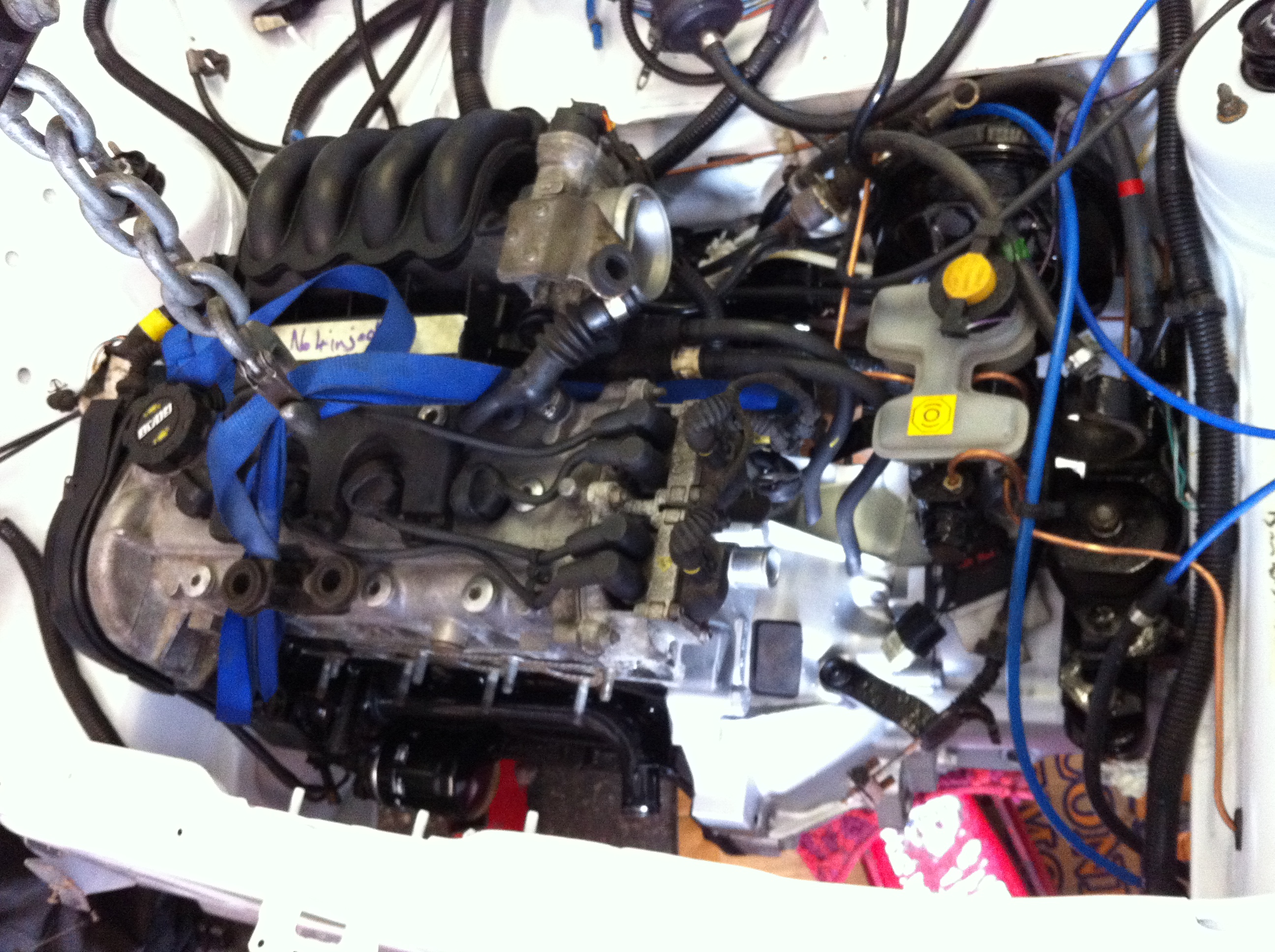

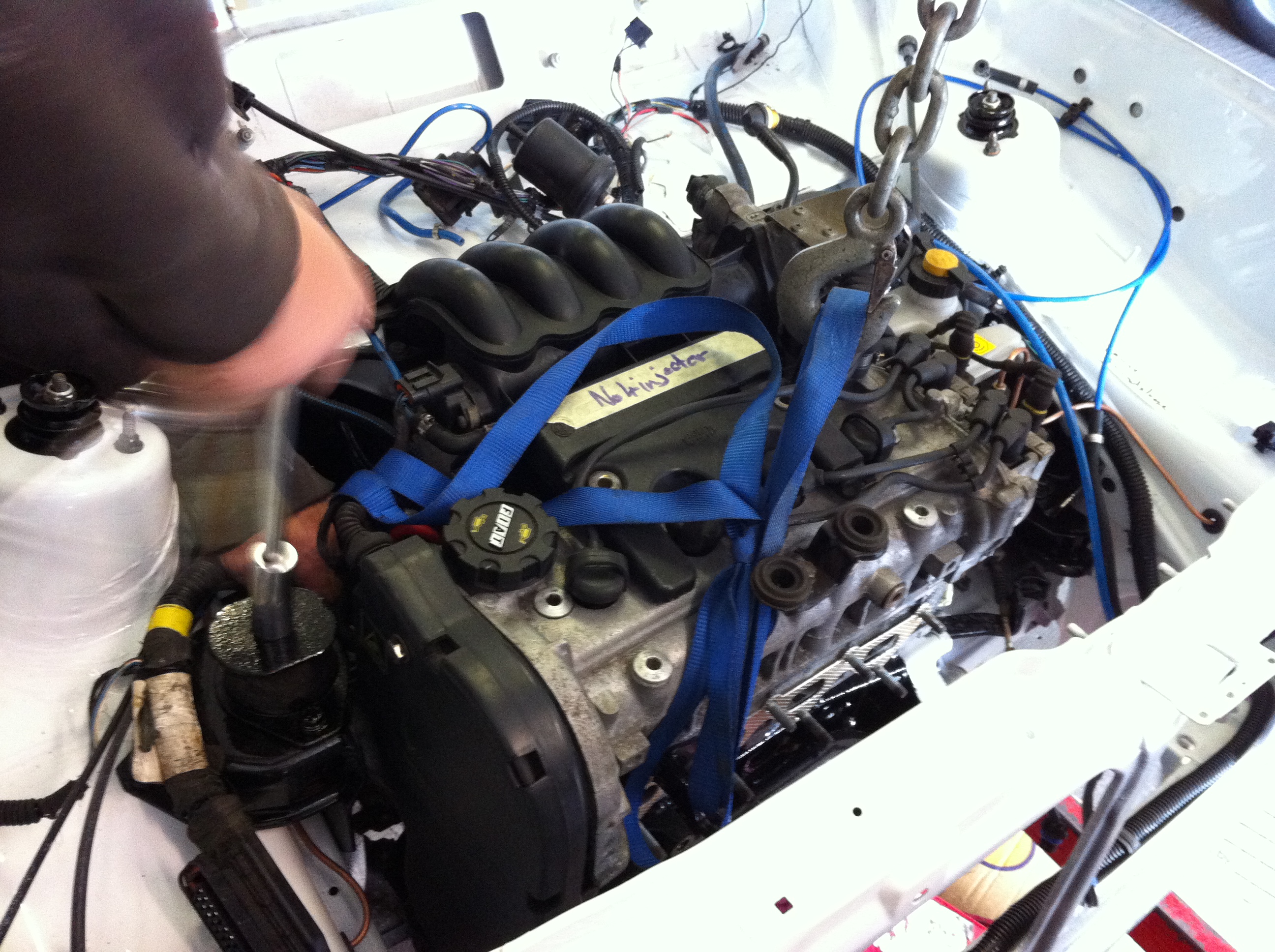

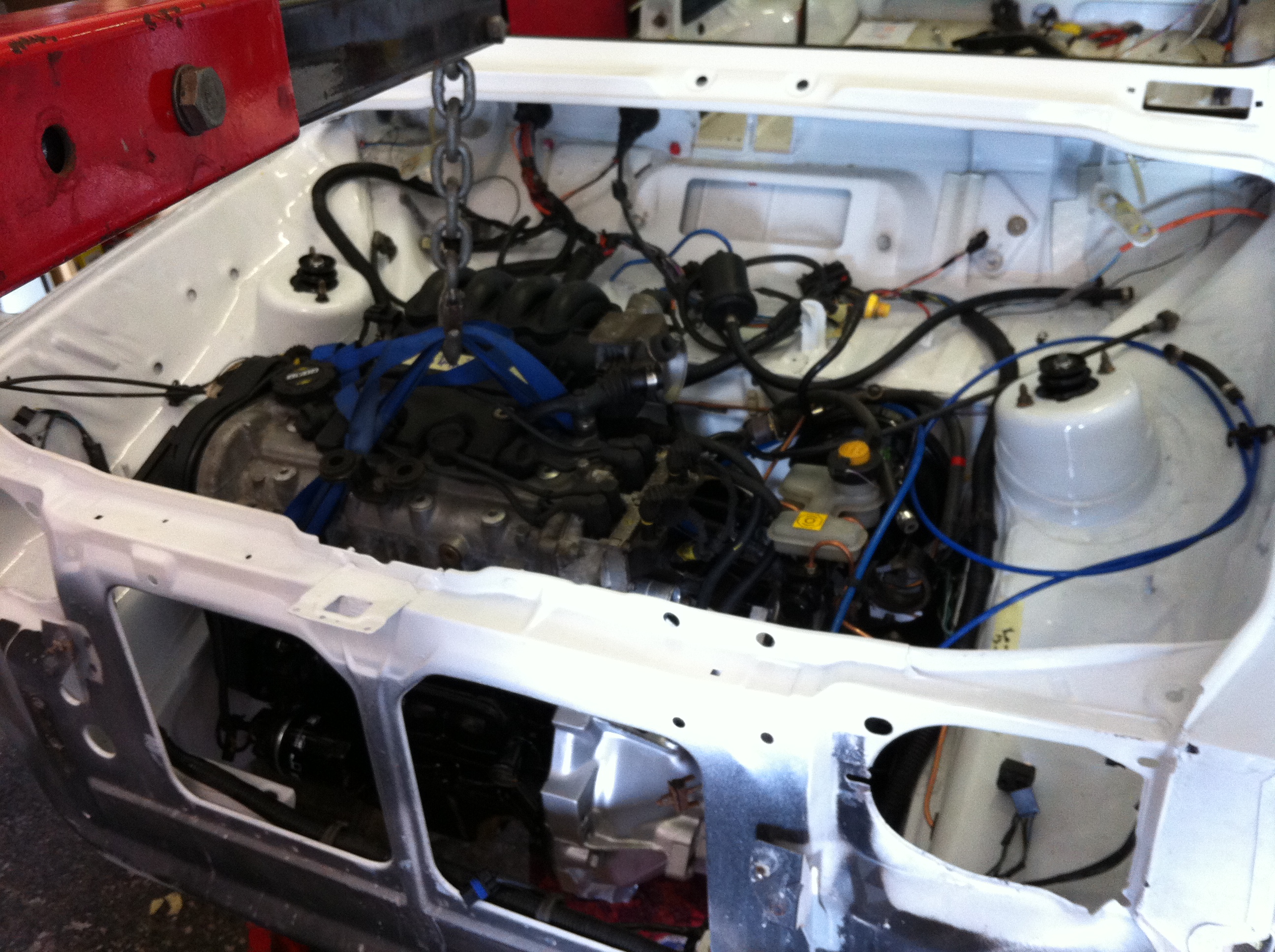

Ok, here's some pics of todays state of play............

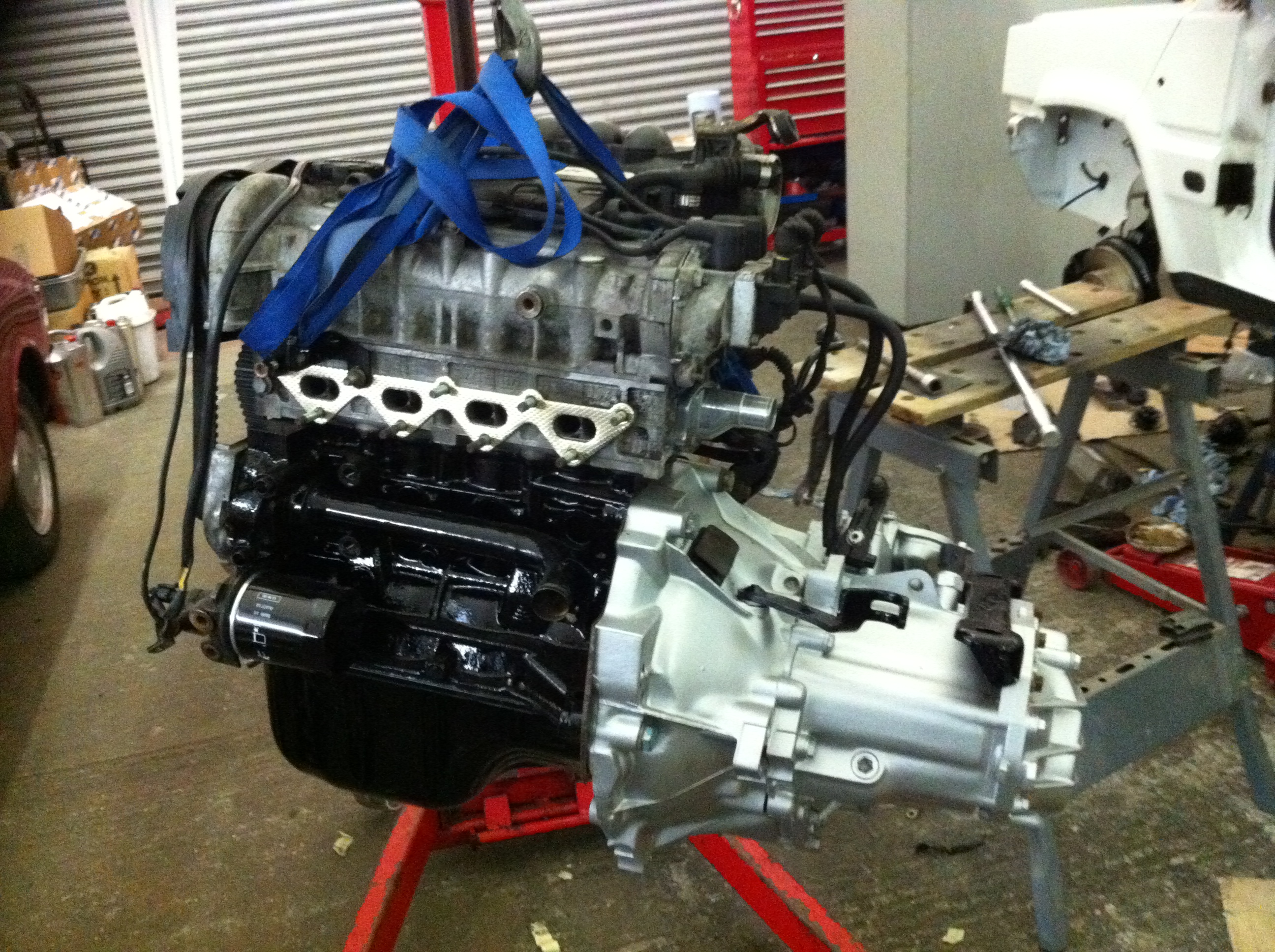

Engine and gearbox now mounted.

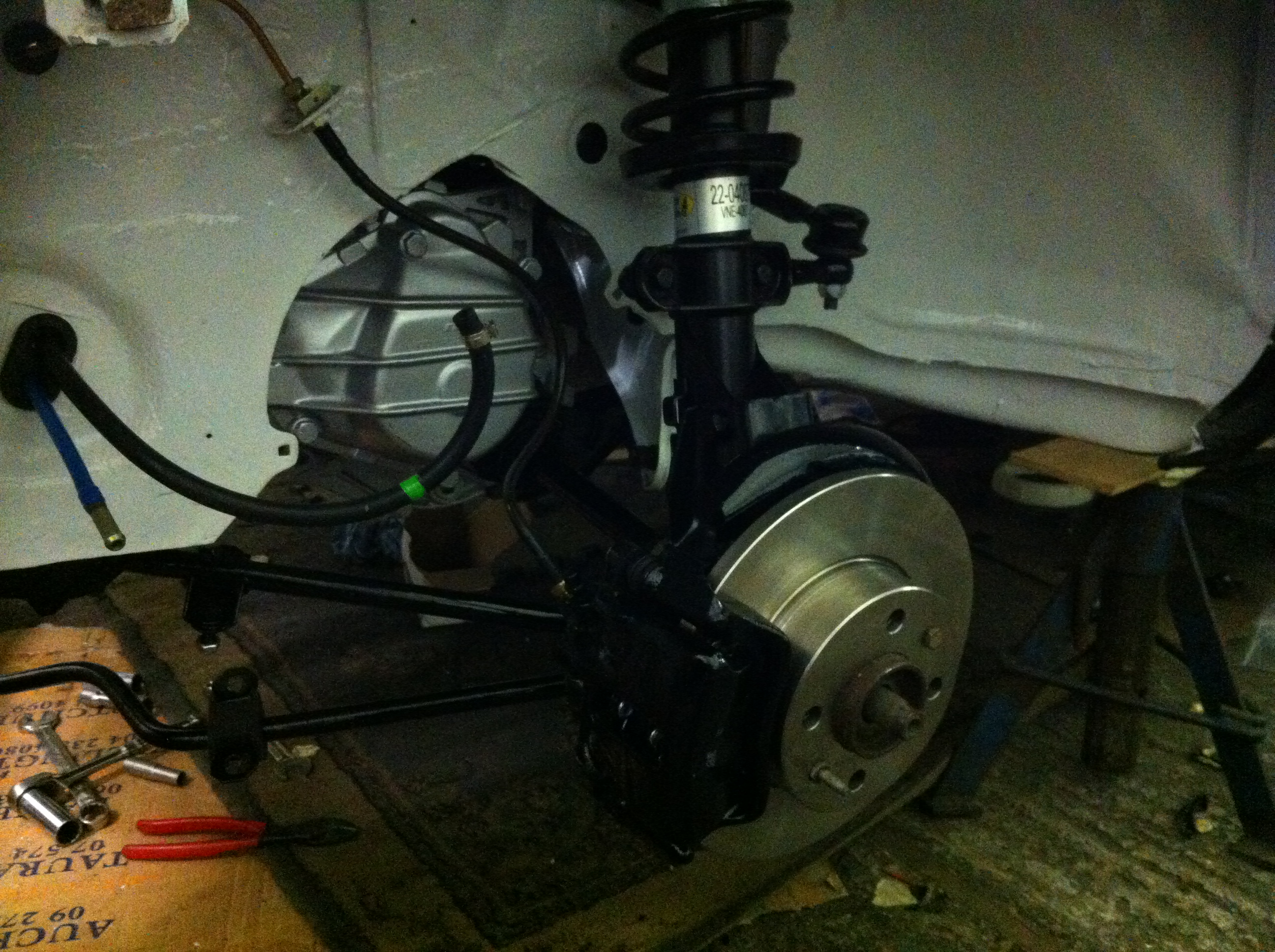

Suspension and brakes coming together. We've used spax springs all round, painted black to be more in keeping with the theme. Shocks are Bilsteins. Gavin has also supplied a Y10 anti rollbar. Not sure how this combination will perform, there is a possibility that this combination will give too much understeer, but we'll fit it all for starters and see what Gavin thinks.
Front brakes are selecta discs and calipers as they are slightly larger than standard.
As you can see there is still a lot to do. :eek: Ahhhh
