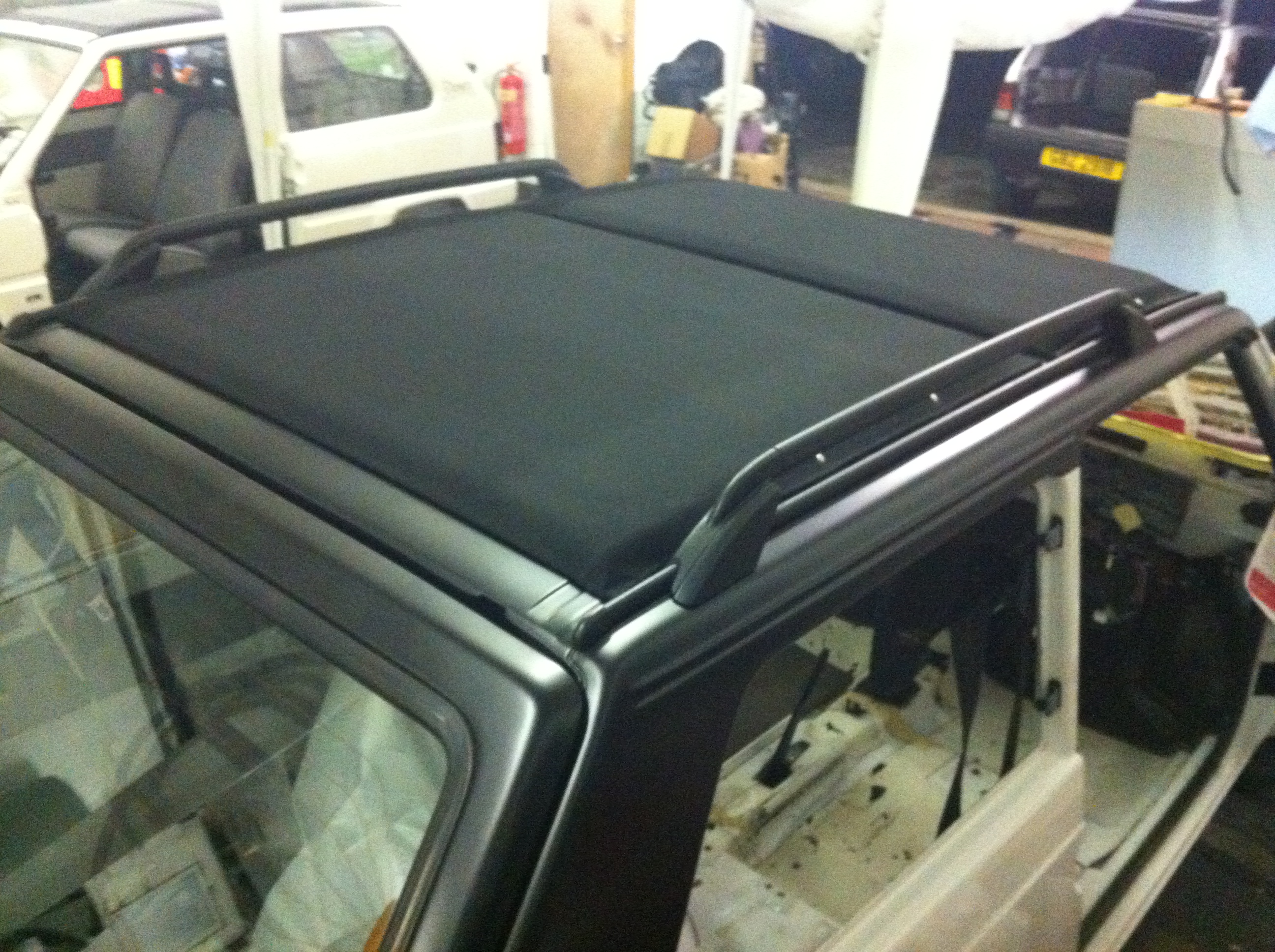

As Homeward went to the trouble of bringing down the new roof bars from Gavin it would have been rude not to fit them.
For those that might be wondering how these are fitted, above are the covers that hide the bolt at each end and the captive nuts that sit inside the box section which runs down either side of the roof.
These are the slots that the captive nuts fit in to to give the bars the correct positioning on the roof. You need to drill the holes so that the bits that stick through the slots end up central in the slot, this allows you maximum adjustment in case you don't drill the holes in quite the right place.
This is where I drilled the back holes, seemed to allow everything to line up nicely...........
Job done.
Gavin, who'd have thought six months ago when you were getting nowhere finding a second hand set that you'd end up with new ones! :)

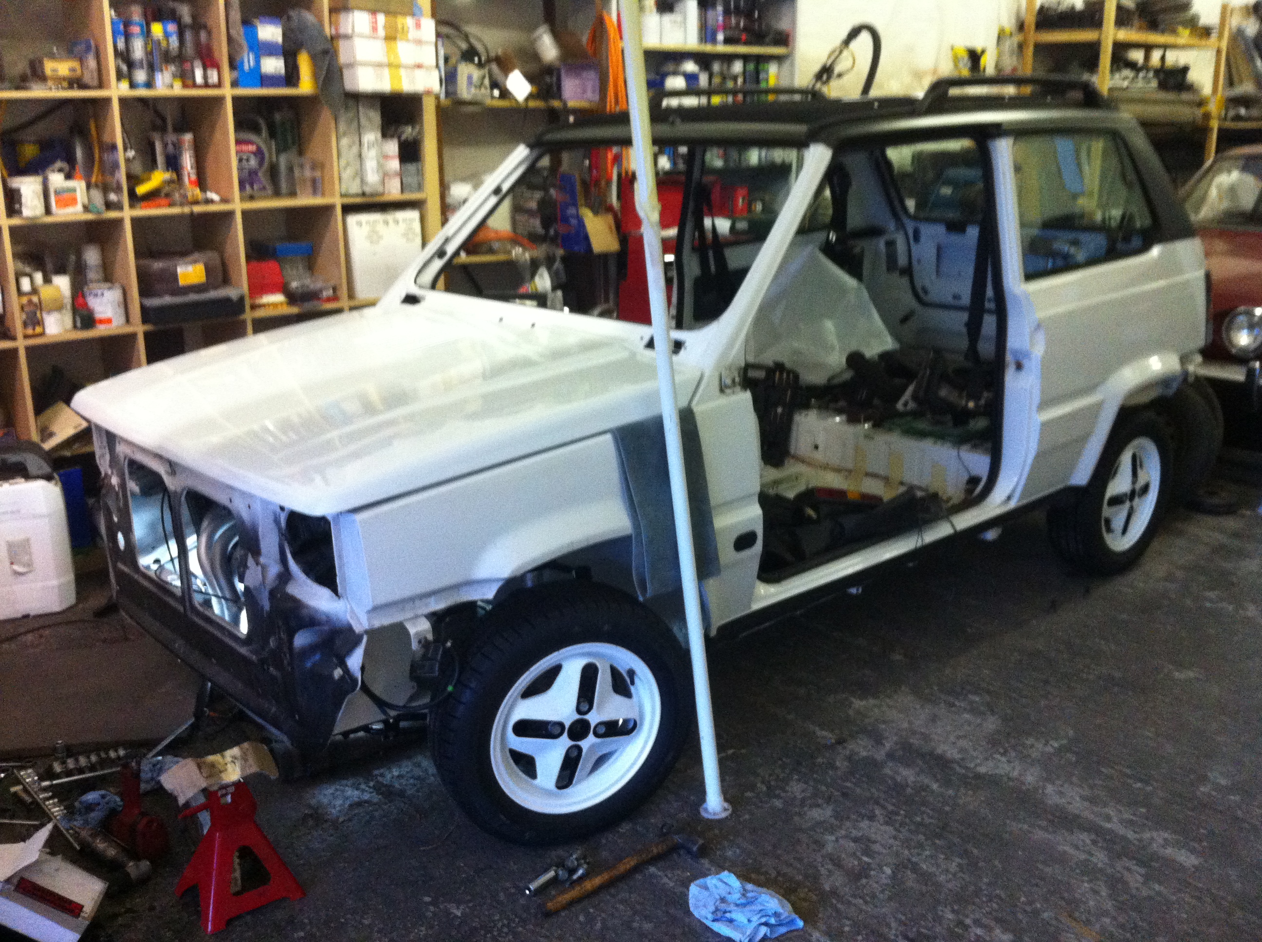

Well I finally got to the workshop today after being out with flu this week, proper flu! not just man flu you know :p :(.
I now have the modified bonnet back from the painters, heater box has been modified to clear the inlet manifold, crank pulley has had the outer of the two machined off to allow it to clear the inner wing, and the mohair sunroofs are now fitted...........
I managed the whole day so I must be over the worst of it, that means I will have a very busy weekend to try and catch up. :rolleyes:

Managed to get back to Panto today. We're trying to move it along as much as possible now, fully aware that it won't be finished for the NEC, but even as a work in progress display I think it will be of interest.
We had it running today despite an initial problem with the crank sensor, fortunately the one on my Punto 75 engine was the same.
Here is how he's looking now...........
