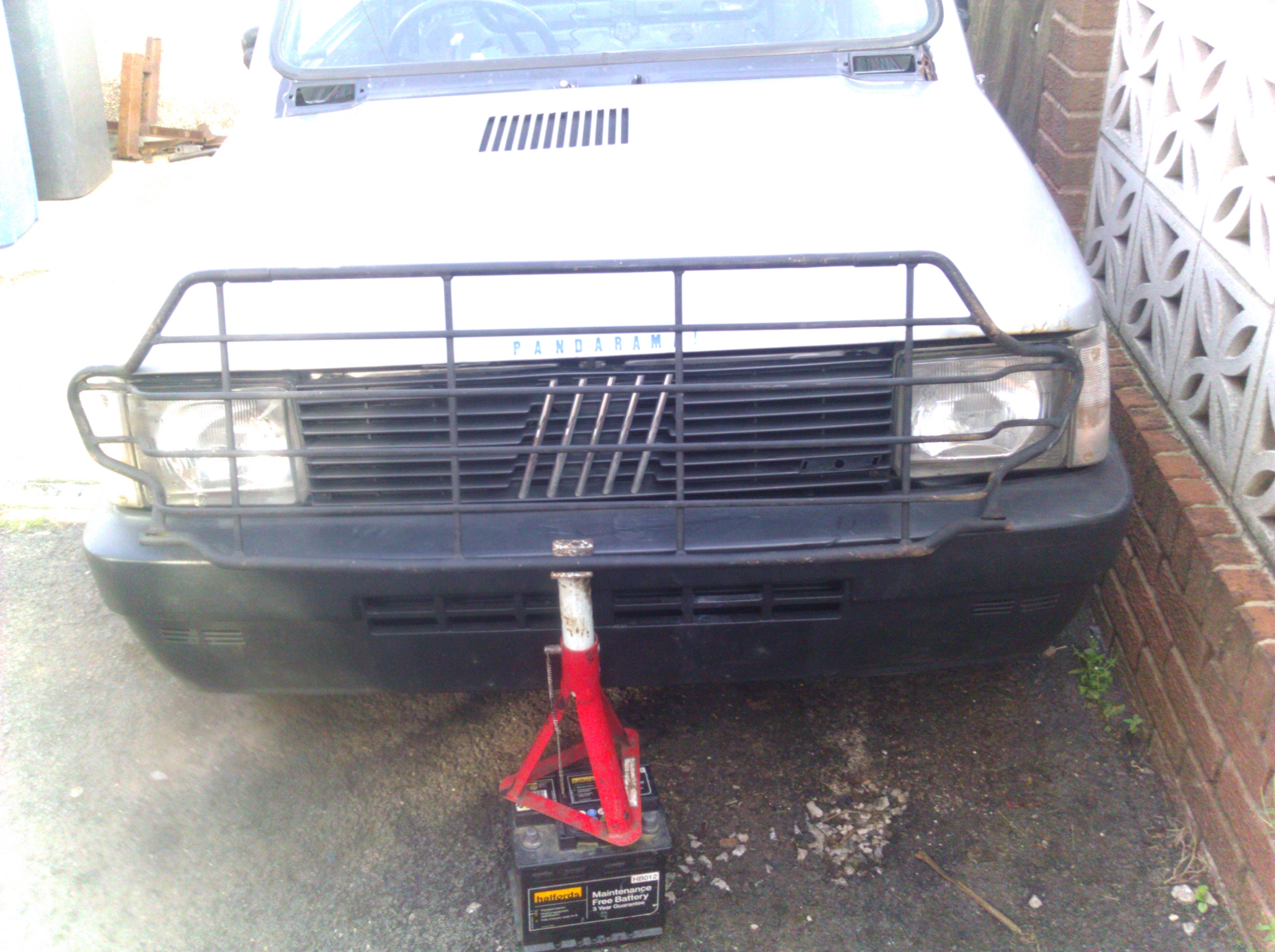

I like the look of that, but I would like it if the top was on a locking hinge so you could make the top rest over the top of the bonnet, look it in position, but be able to pivot it back so that you could open the bonnet. In the post apocolyptic future folks would be trying to steal engine parts for their own cars or to build weaponry, or to disable your car so you were unable to reach distant food supplies (so more for them)
