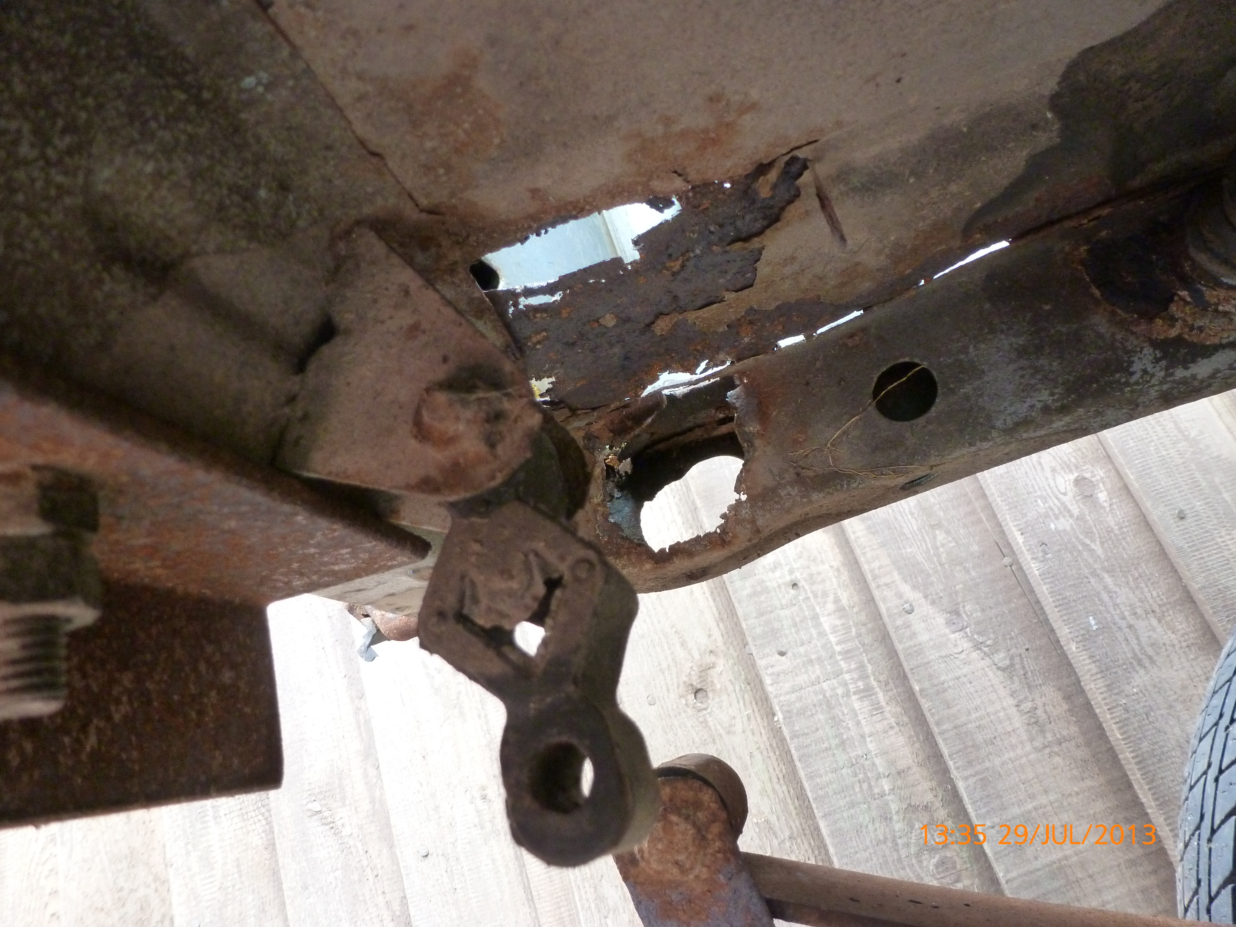

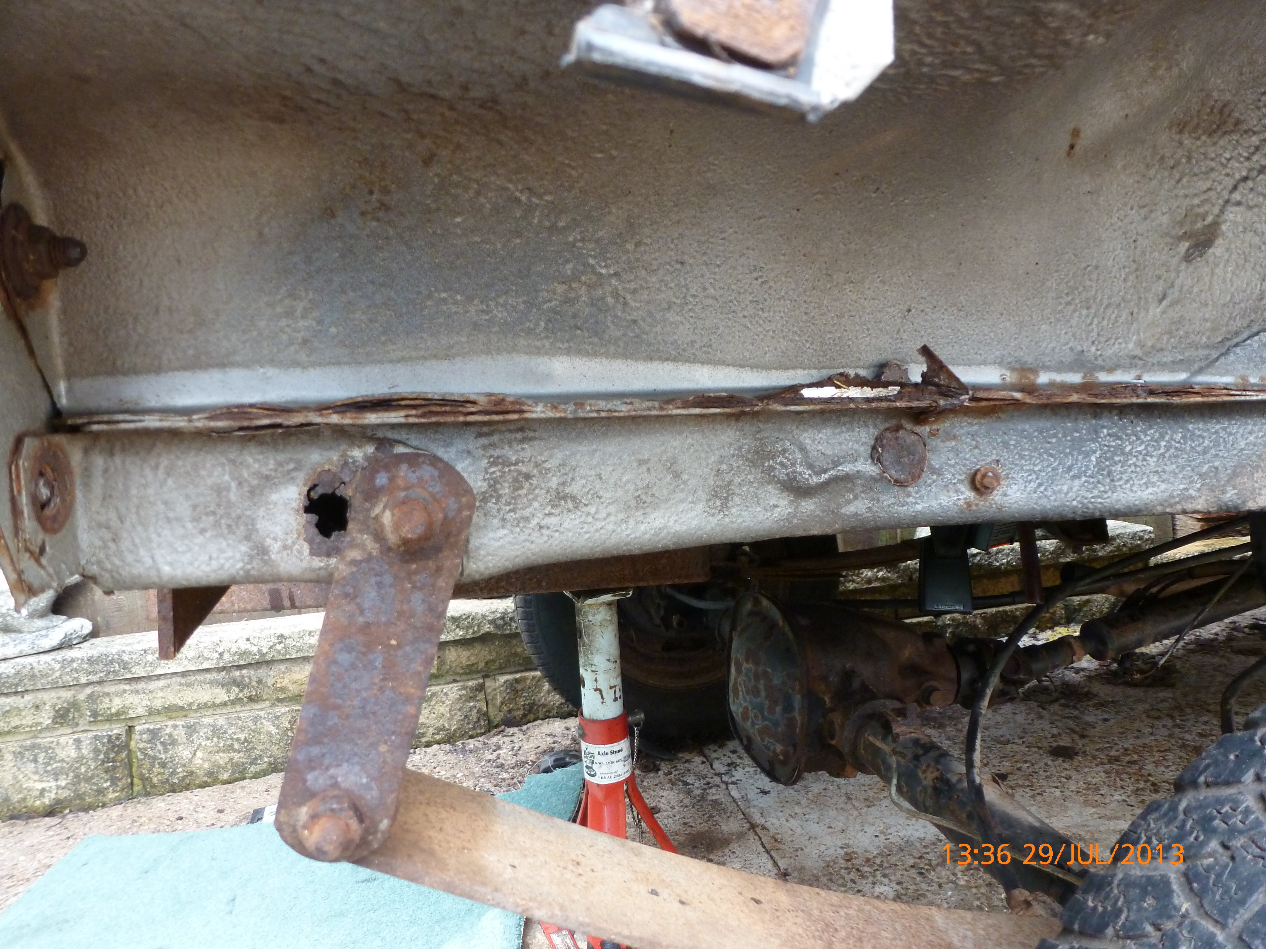

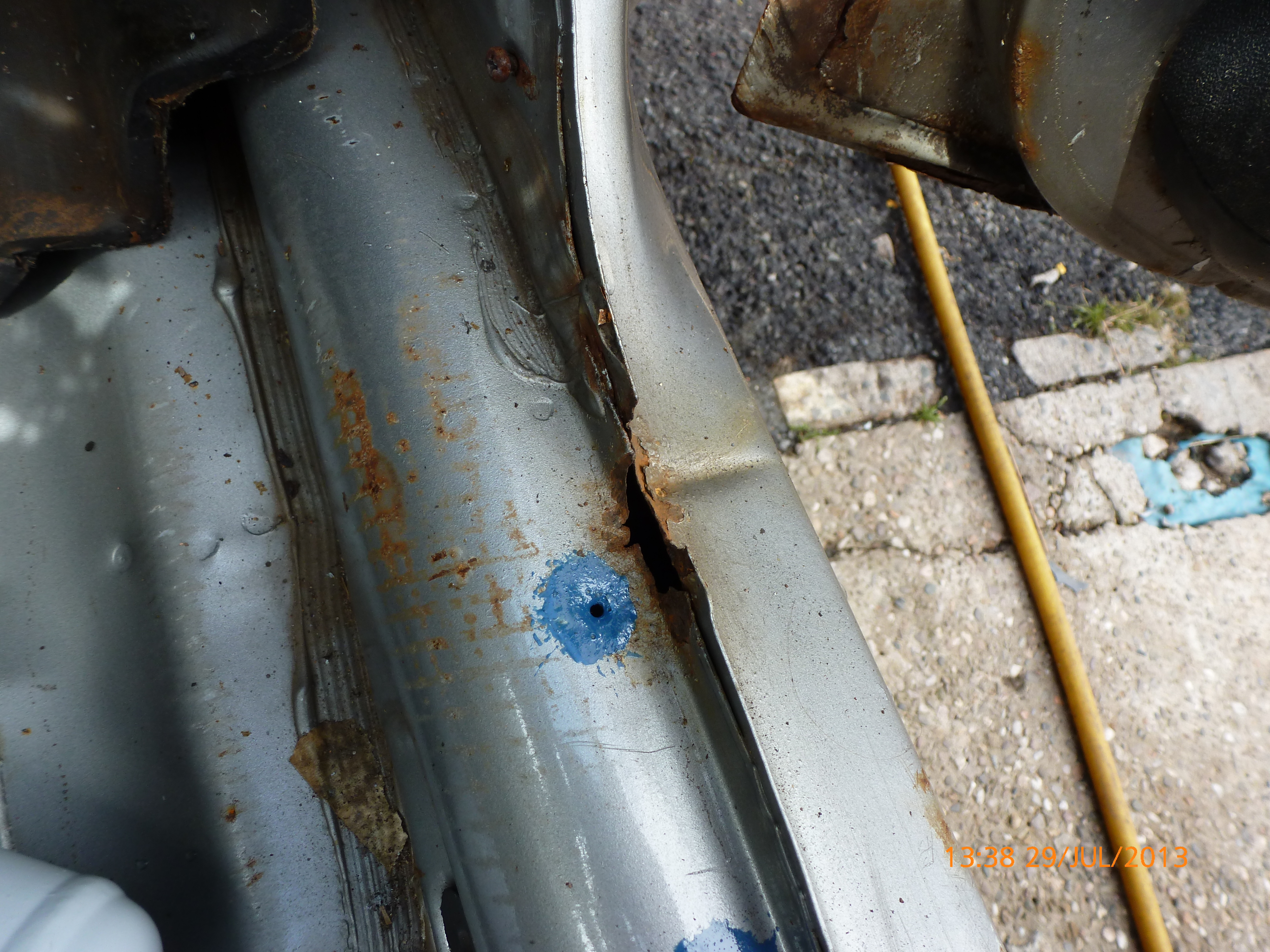

hey guys, heres some pictures:

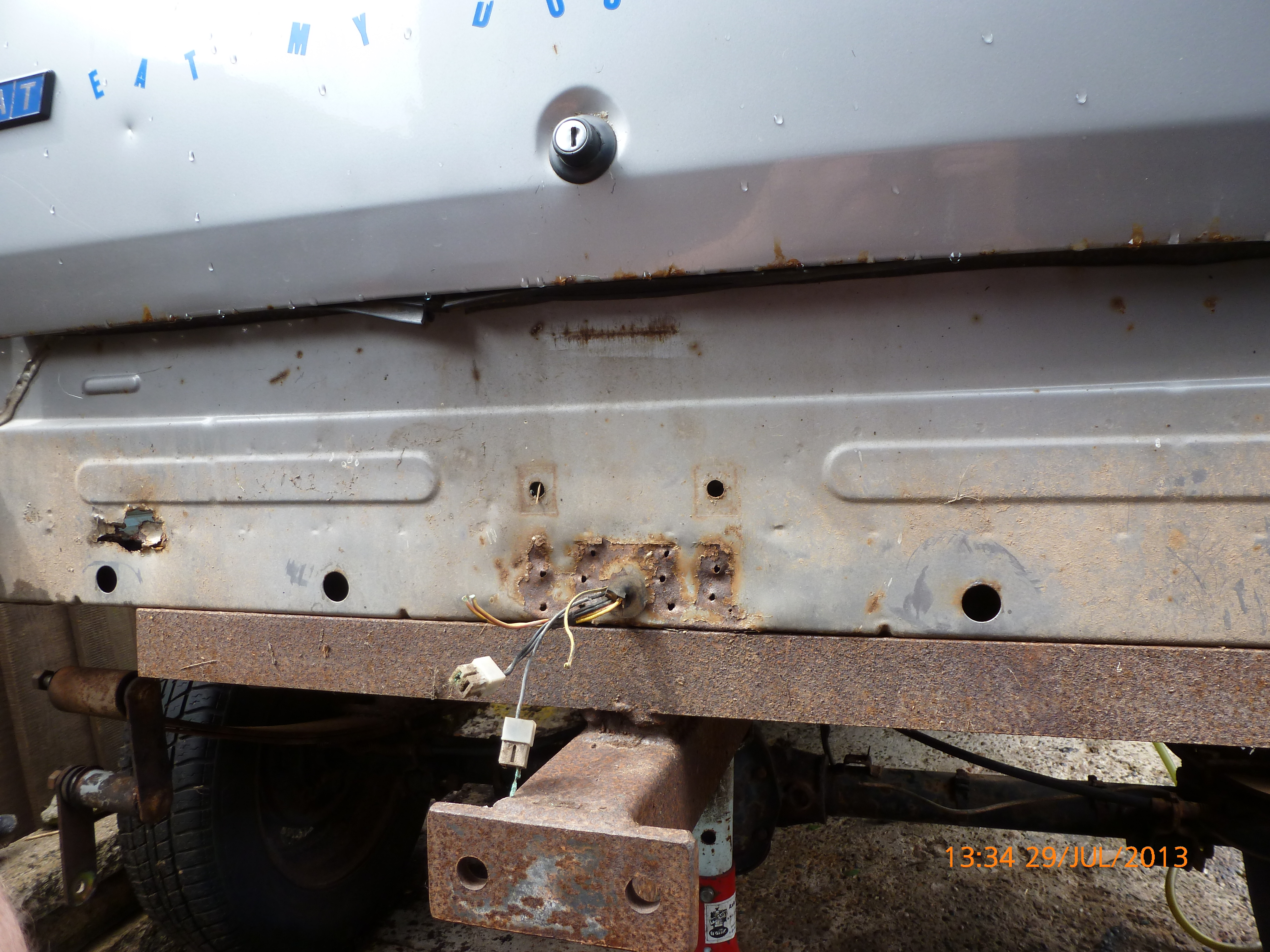

not much rust on the back slam panel, just one hole.
oh.. dear.. well theres your problem.
and of the same side:
this is now fixed, no pictures though only just got in from doing it! (1:30AM)

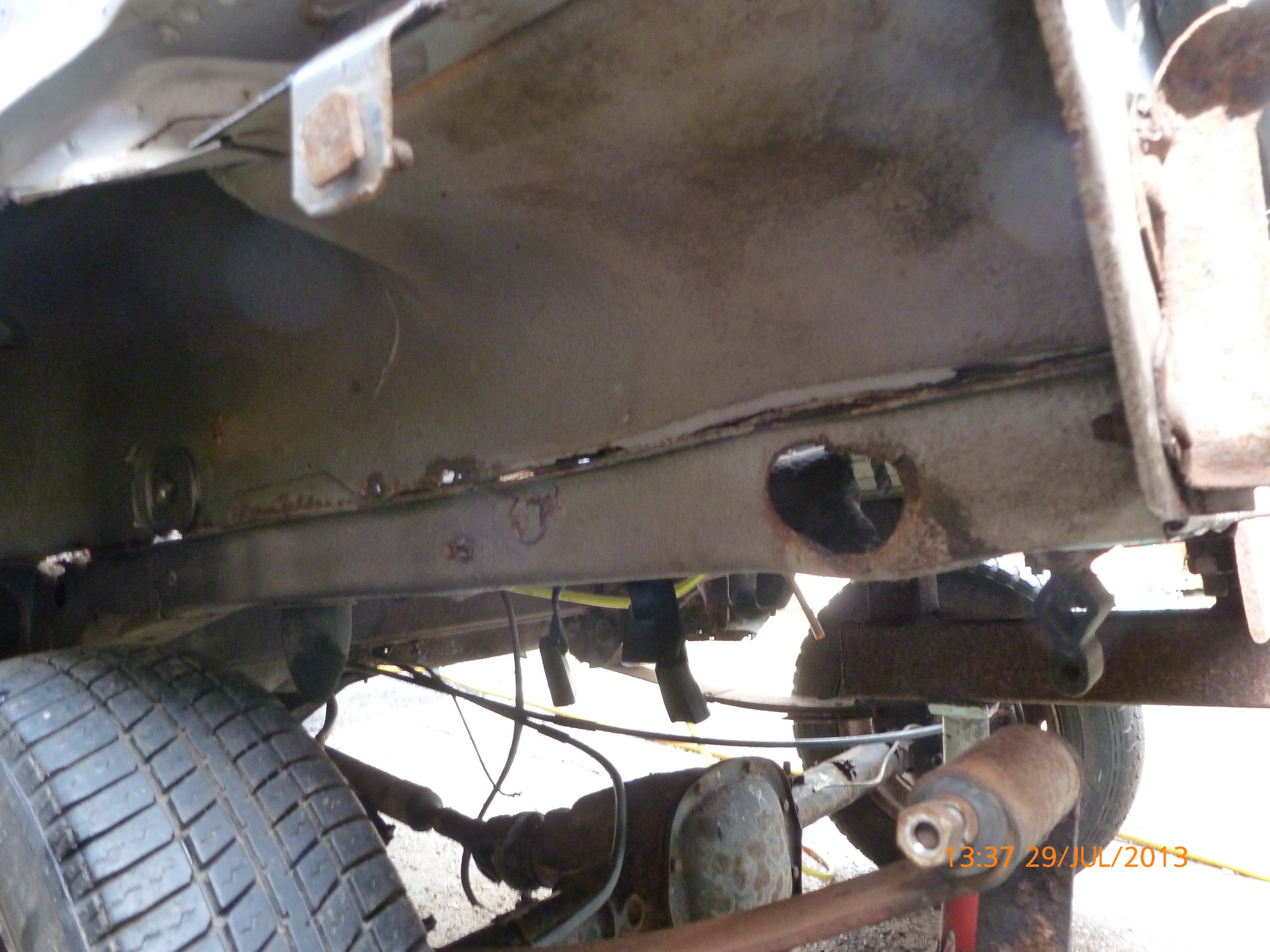

the other side is almost the same :/
and another of the same side as you can see it was starting to go:
drivers door sill lip was starting to go:

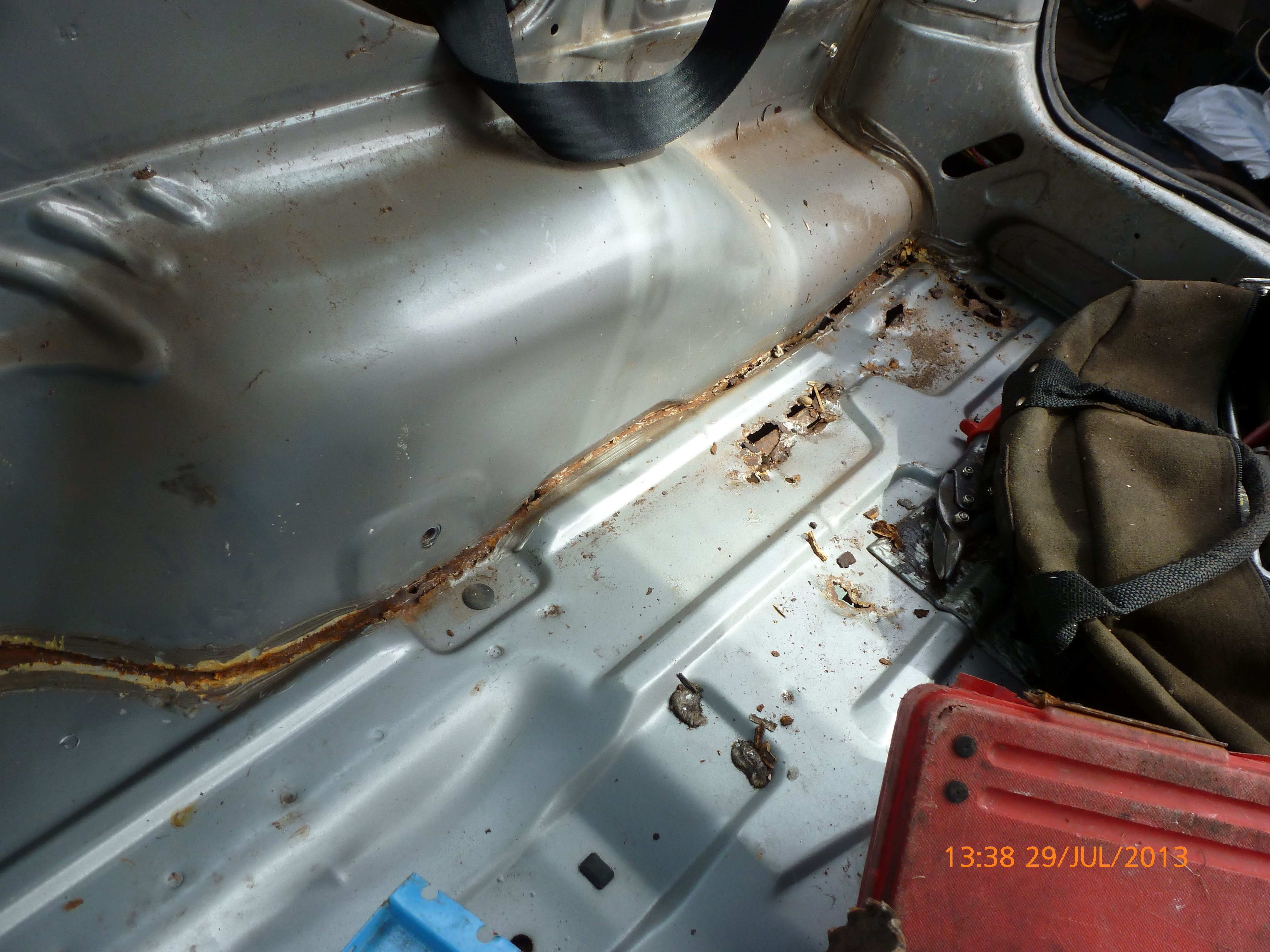

heres one of the drivers side rear boot seam
and one of the passenger side:

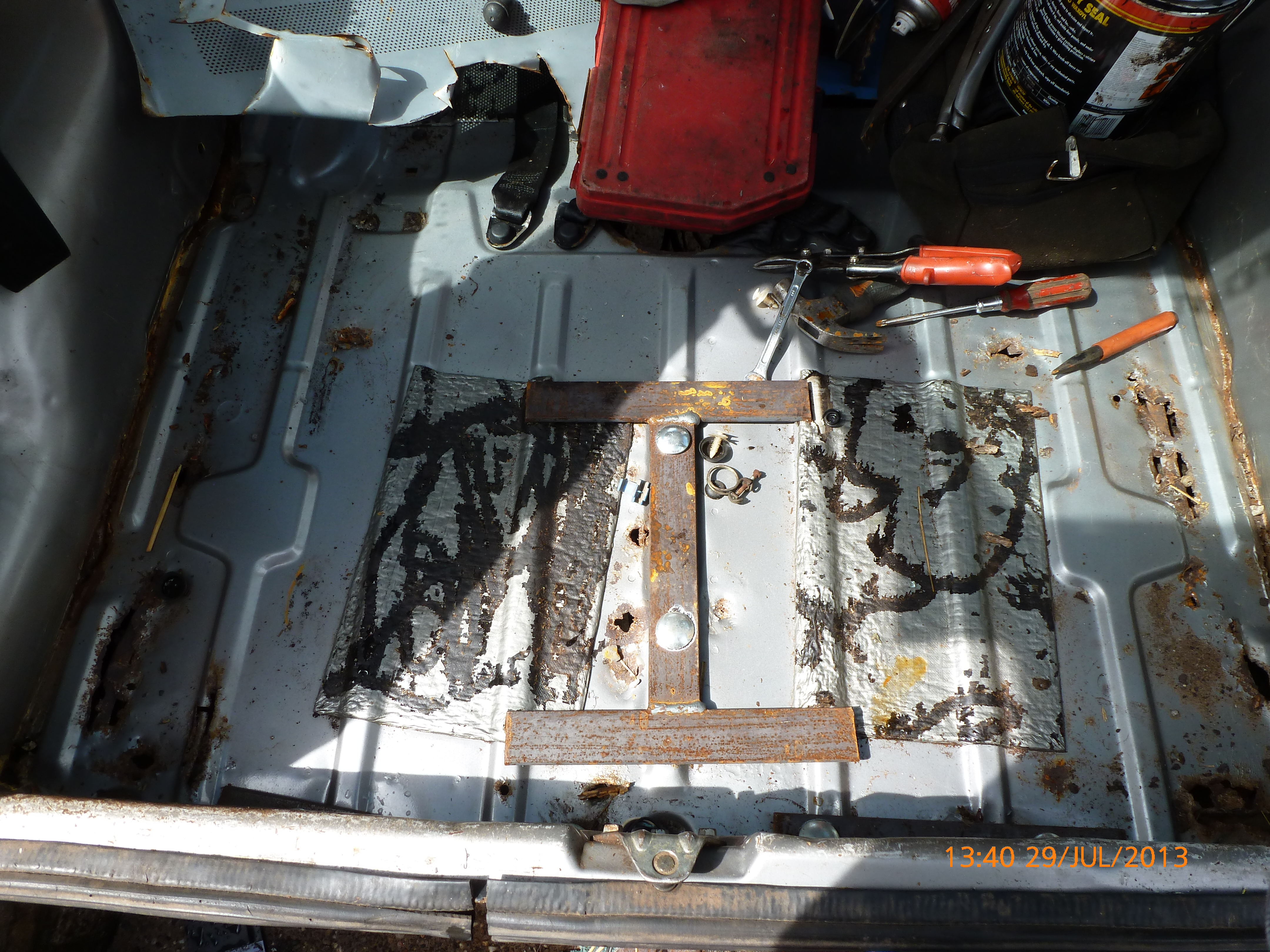

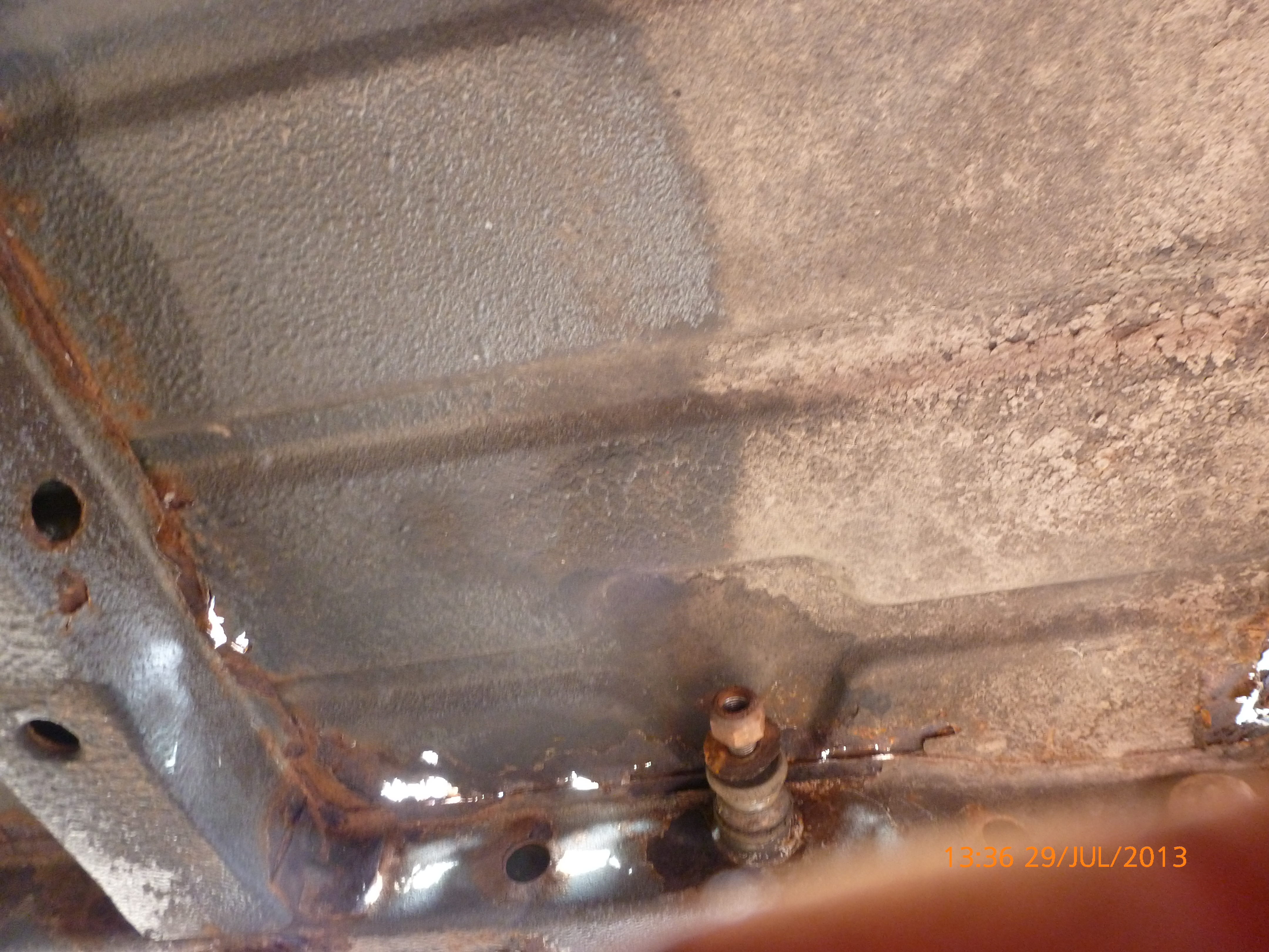

here is one of the well ventilated boot floor:
could not find any rust converter, but have loads of blue hammerite and thankfully it has the stuff built in so i used that. gonna be a pain to weld to though but i will deal with that when the time comes. once i have done this i will start work on the inside of the boot floor.

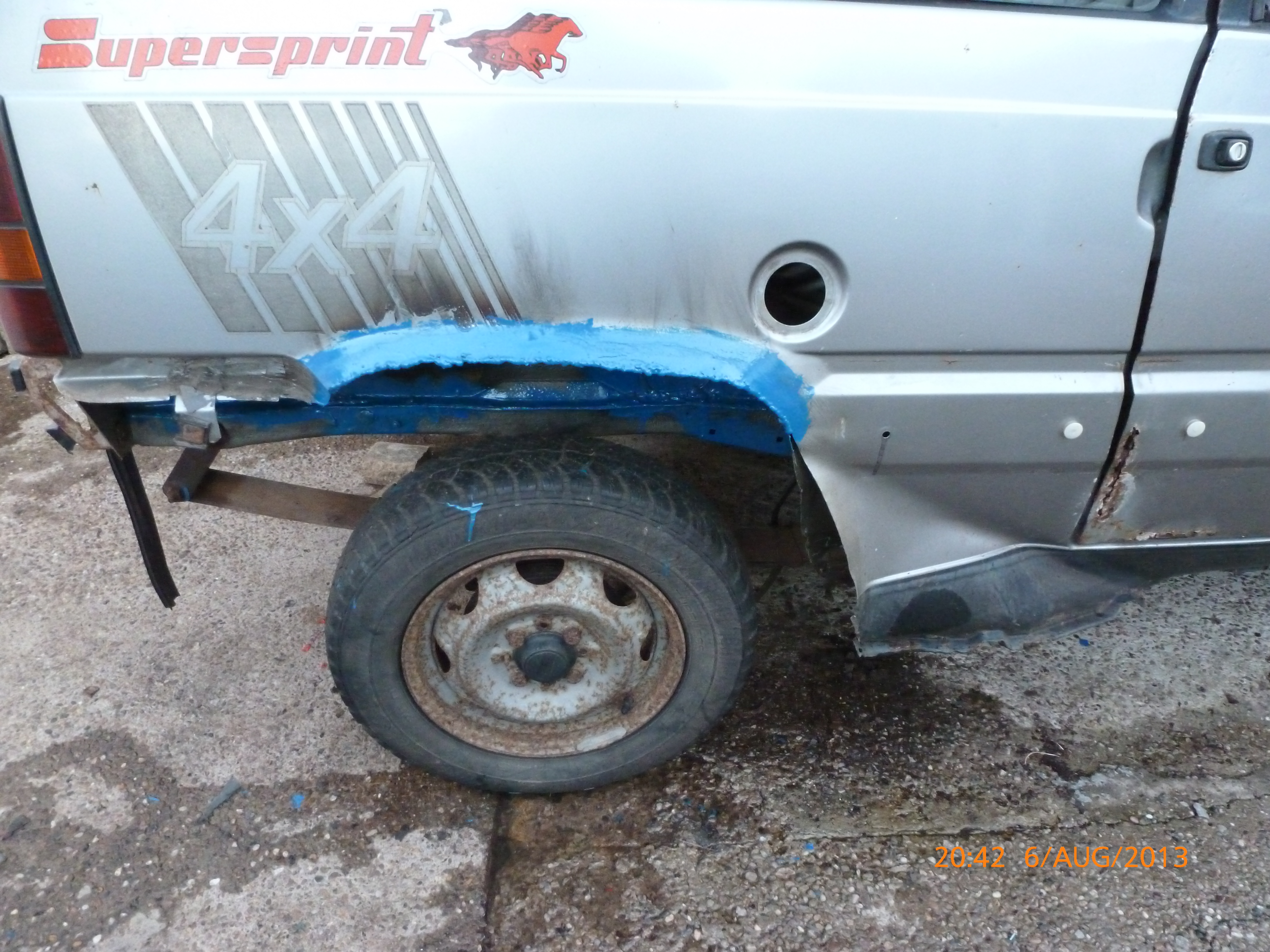

the wheel arch has been widened and (in the scruffiest way i can) welded.
the seam in the wheel arch has been split, cleaned up and welded together.

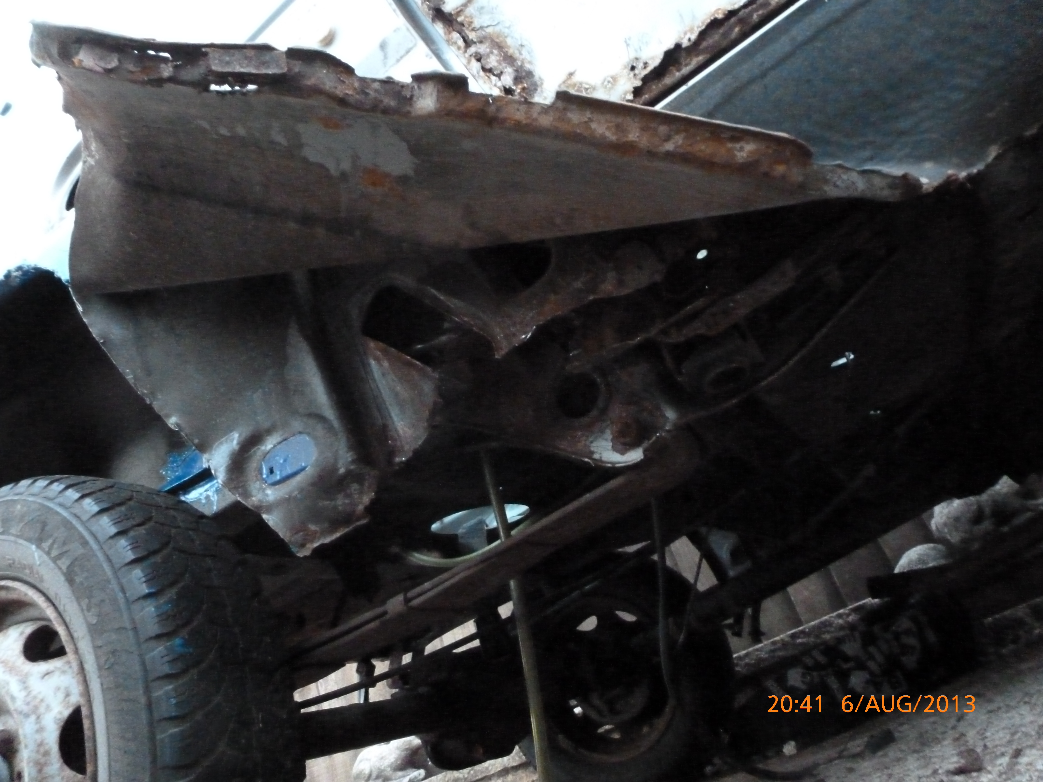

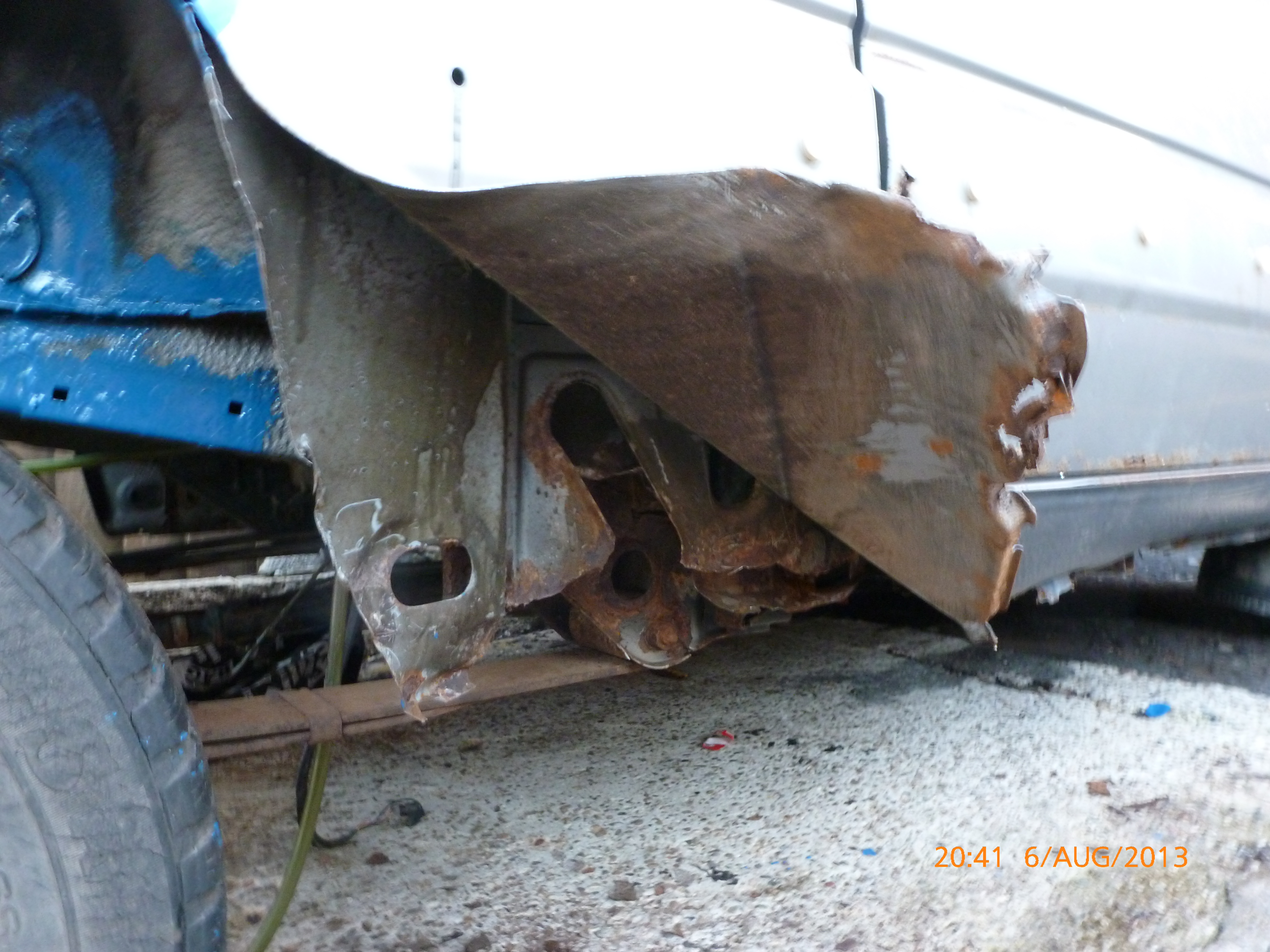

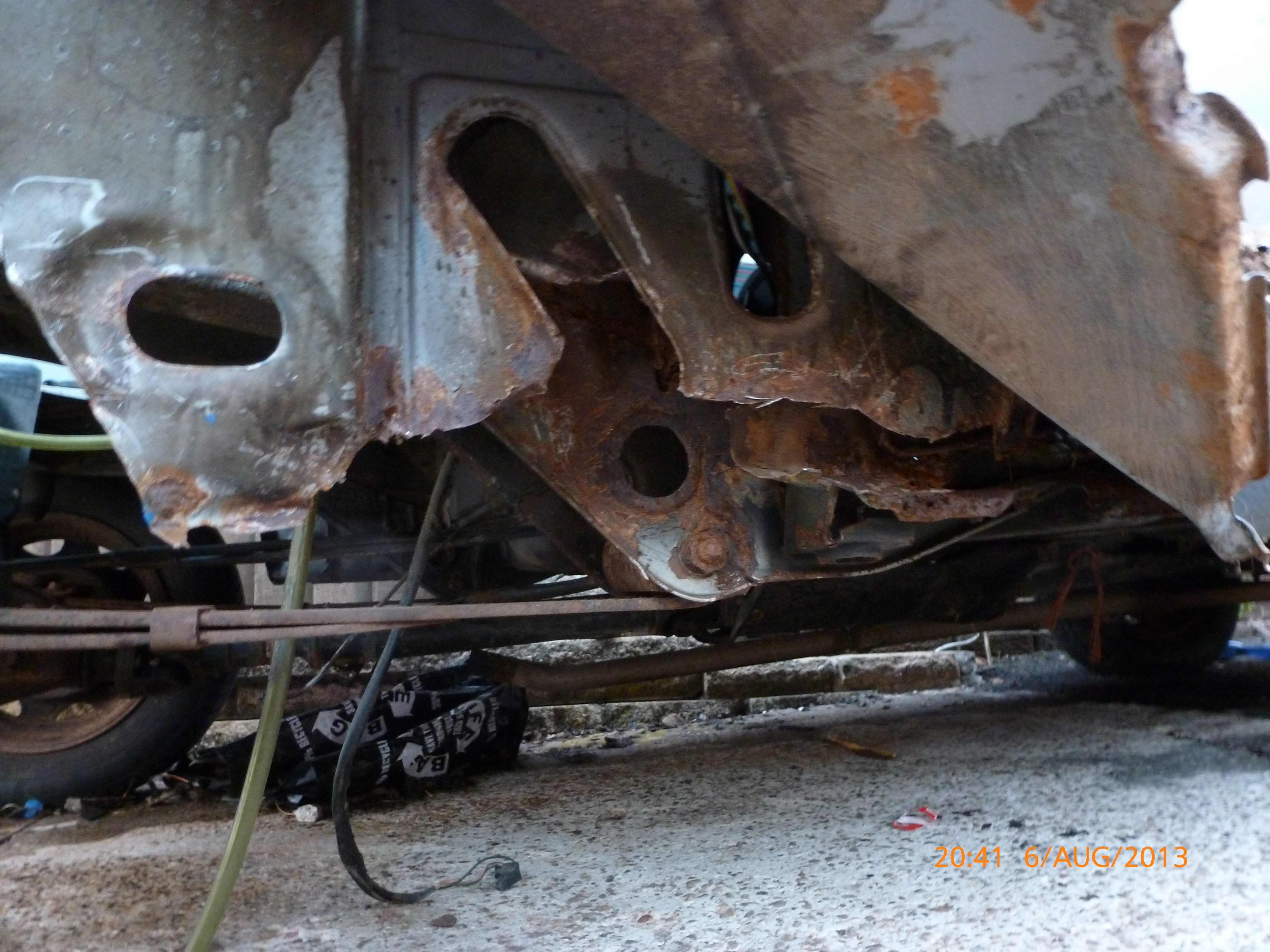

you want pictures?
well be warned.. this is what farm life does to a panda. all the animal pee seems to have been very corrosive.
i decided to bend the sill skin back rather than cut it off. i know it will keep the dent... but it all goes in with the theme. mind you, i think i will be able to push it out.
