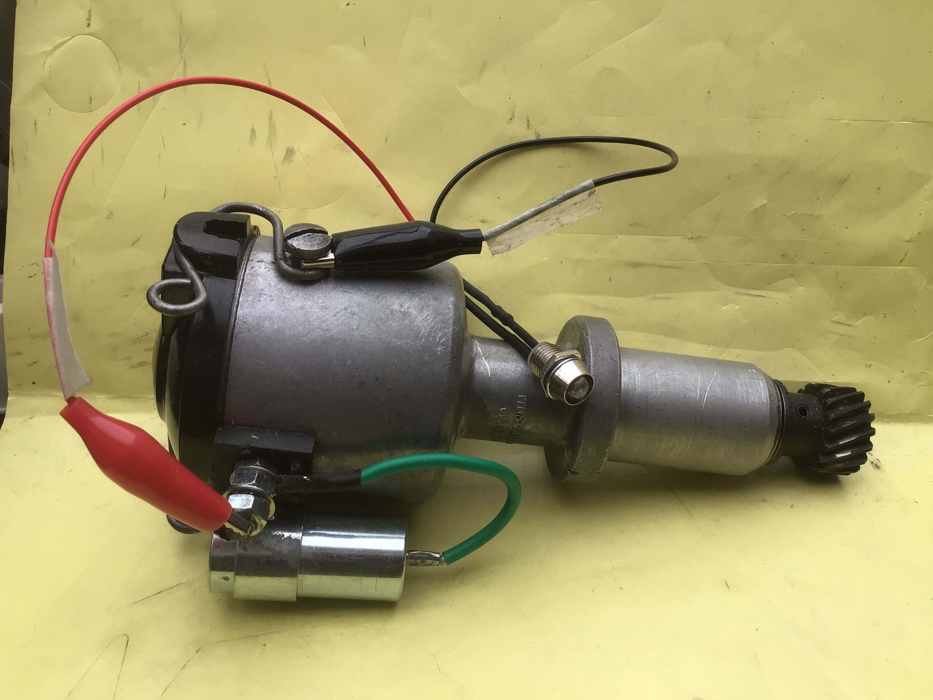

In response to a request from an owner on another forum I put together a small number of static LED timing lights. I have two left if anyone is interested. They don’t take up any room but do the job. £11 posted in the UK. Red crocodile clip goes to the low tension feed, same as the condenser and black goes to any earth, simple as that.

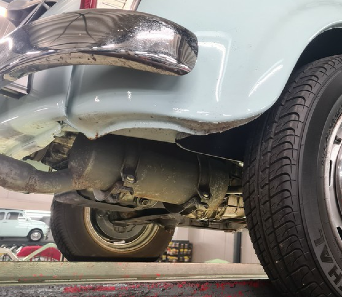

Major discovery today! So i met a follow 500 owner. I parked next to him, had my car idling and asked if he could turn the engine on so i could hear it. It was on he said. Wait...? Why is it so silent? Oh no, its not he said. It backfires because my i had my exhaust off and didnt screw it tight. Here, listen...he revs his engine i hear little cute pops.
He took me for a little spin round the block and we could actually talk and hear what was said.
Than i took him for a spin in my car. It sounded like a nascar compared to his car. Low resonating rumble and lots and lots of noise. He asked if i had 250hp in the engine compartment.
I quickly came aware that the sport exhaust i have on mine (bought it that way) is way way way to loud.
I explained to him that my popping and backfires were a real problem since i mainly drive small roads with lots of elderly People on bicycles on them. Each time i let go of the gas the cautiously pass them the car goes poppoppop BANG sending the old folks straight into the ditch.
So next thing to do...order a stock exhaust.

I went from the noisy bang from a sporty exhaust to the same with a standard exhaust. Do have a check of your timing. I don't have another set of spare gaskets to go back to the boomy one to do an A/B between the two....
From the moment I got the car (a year ago) it was loud on the outside and inside. I just thought that was due to poor isolation in such an old car. I checked and reset the timing multiple times, and that ain't the problem. From the moment I got the car it popped, the banging came later. The car makes such a loud noise that when working on it and revving the engine I feel sorry the neighbours. It is really really loud and has a deep rumble in it, like the tuned Civics and Astra's young men in their twenties have. I'm almost 50 :)
I did wonder why on youtube video's the 500's did sound a lot more like little cars but actually never really thought about it because I didn't now better. So today i'm ordering a stock exhaust. They are cheap so why not, and hopefully with the new manifolds from the other day and a new exhaust I hope the popping/backfire also dissapear. If not, and they are like the 500 I saw and heard yesterday...who cares, that's peanuts compared to how it is now.
