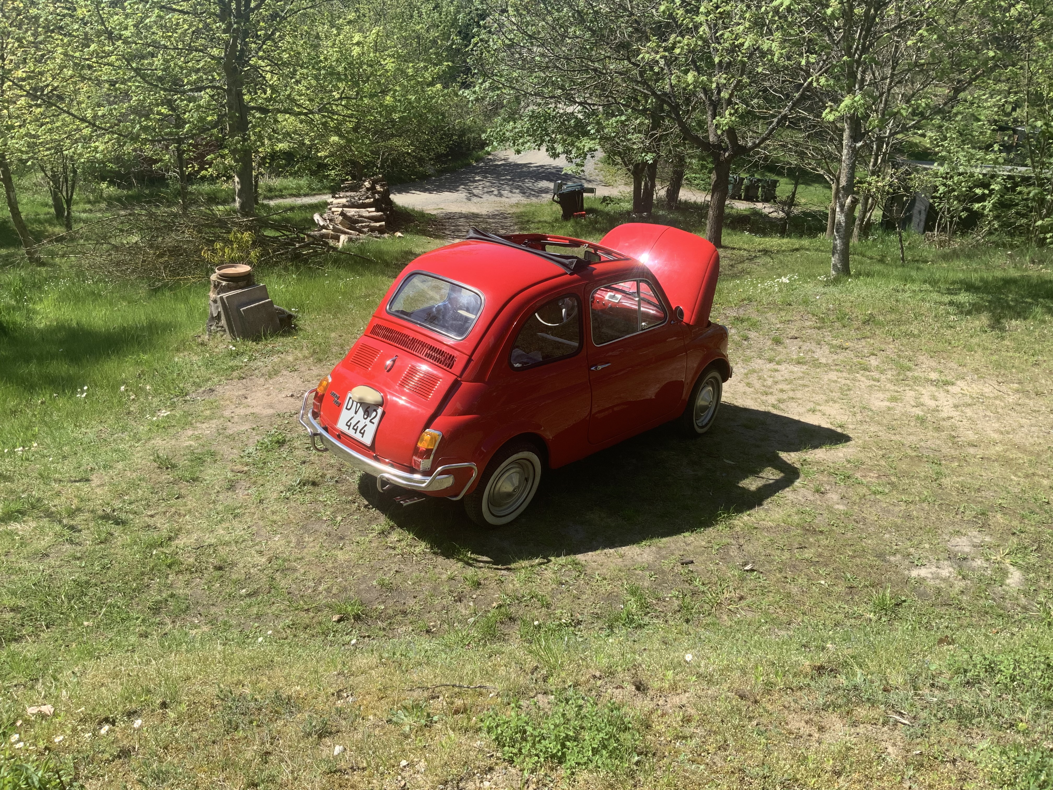

Hello forum. I have 67. Today, while enjoying a drive, the car popped out of 1st a few times. And there was subsequently som weird ‘clunks’. I stopped and looked under the car…nothing unusual. The suspension is ll new and good.
Any ideas appreciated. Thanks.
