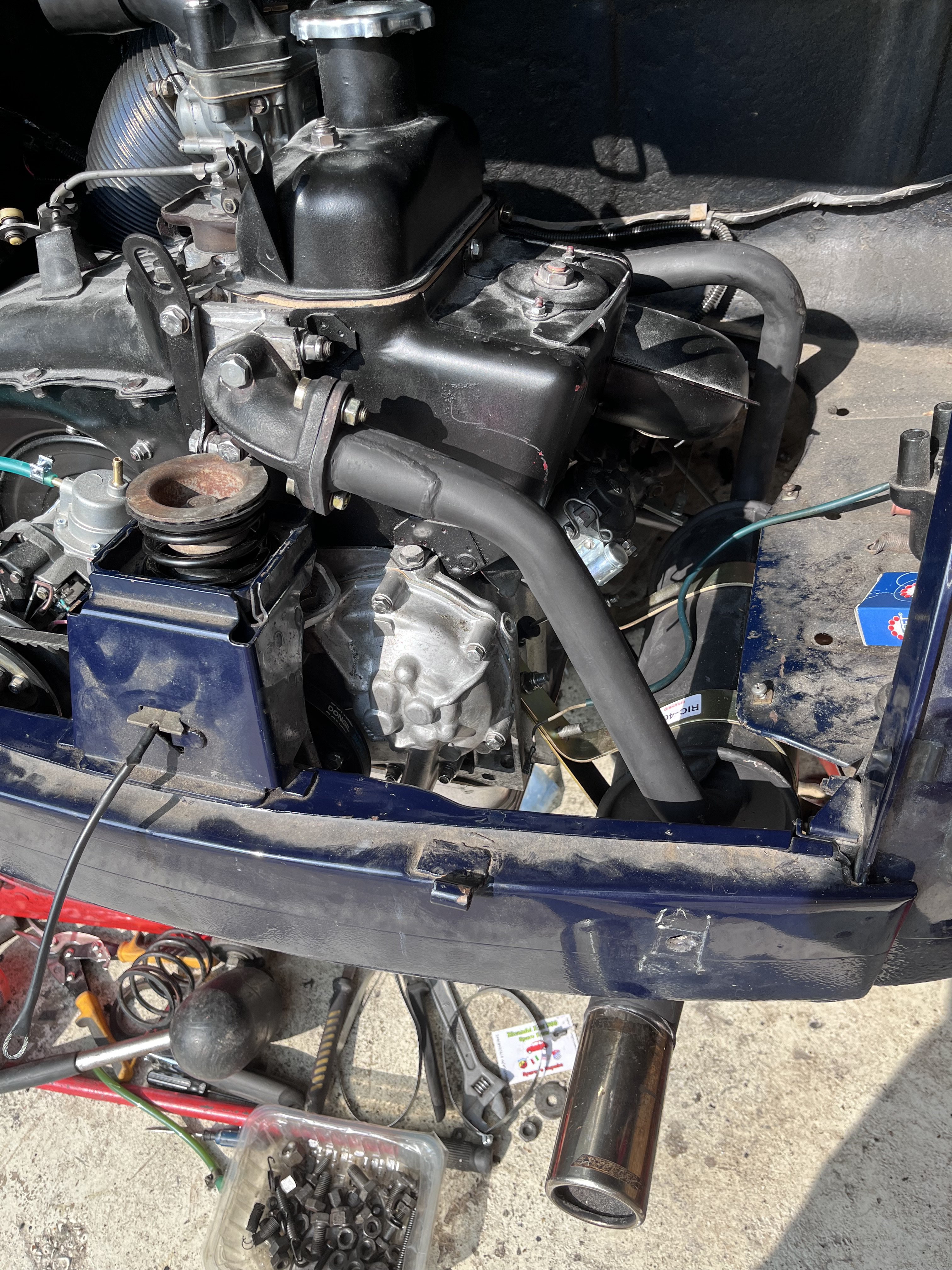

I’ve fitted the spacer but now the top of the engine mount interferes with the exhaust elbow. I can fit the elbow but it’s pushing against the mount
What a pain. I wonder if you would get better clearance or be able to achieve it with the early 500 engine mounting?
It could look quite stylish if you did have a cut and weld job to create a cutaway for the exhaust That wouldn't be too difficult to achieve for someone half-decent with a welding-gun.
I would stay with original engine mount and either warm up and bend the exhaust to fit or get an exhaust system from a better supplier, personally I think the wrap around mounting look pretty flimsy, but I suppose there is not many suppliers in the market for what you need.:(
You're right about the mounting; original Fiat exhaust brackets not only positively locate the silencer from any rotation, they are made from heavy gauge, U-section steel. Despite that the brackets can rust away surprisingly quickly. So, a simple steel band is not likely to be adequate for the job.
If the brackets are as weak as they look it's possible that the weight of the exhaust will put a strain on the manifold elbows and their fixings. It's a shame that manufacturers make and distribute such poorly designed components.
