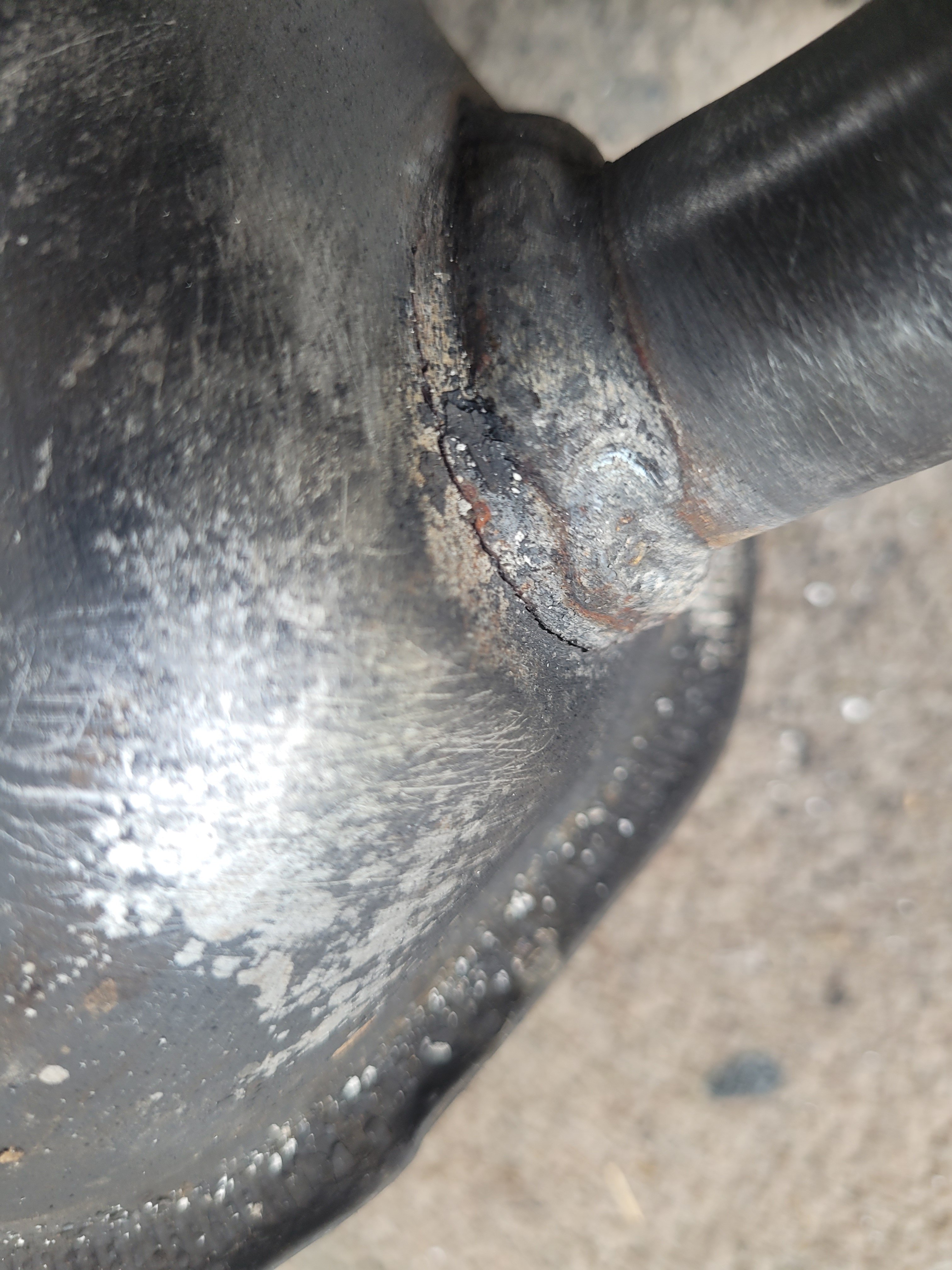

Technical Exhaust split from flange - repair or replace?

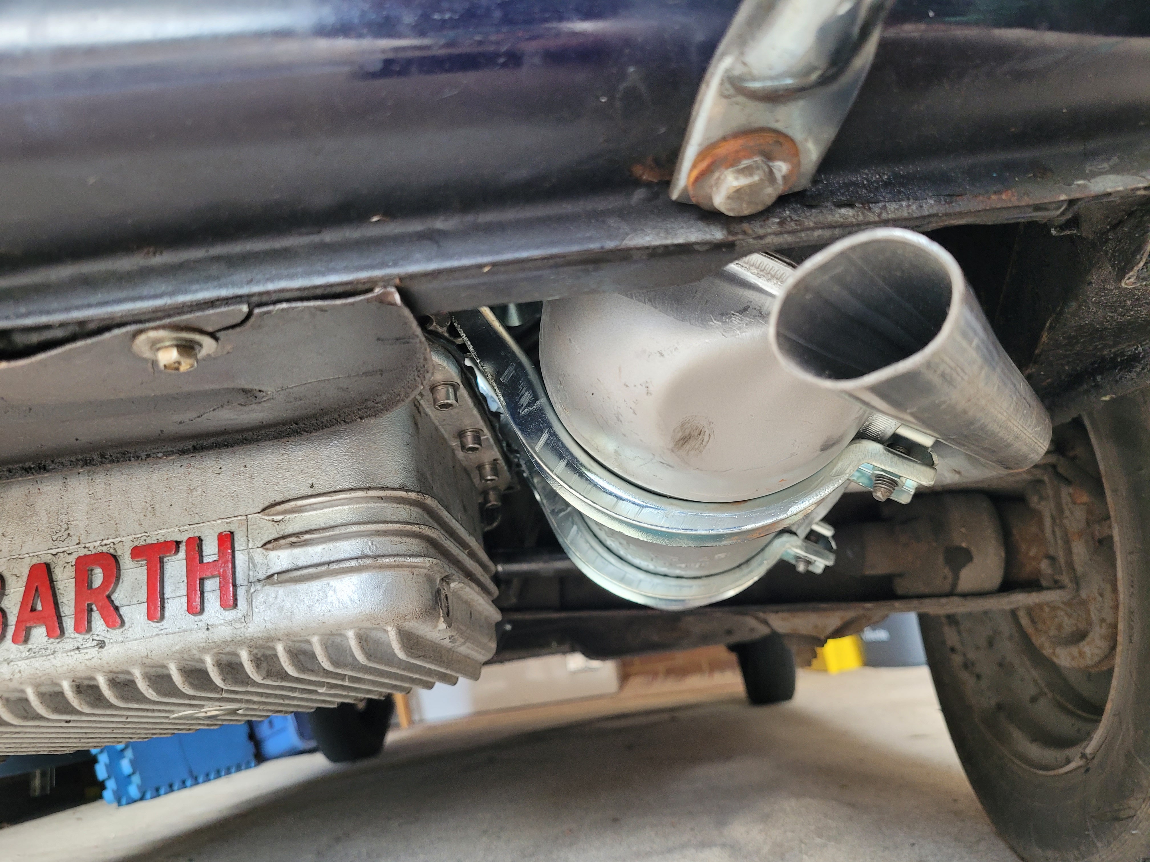

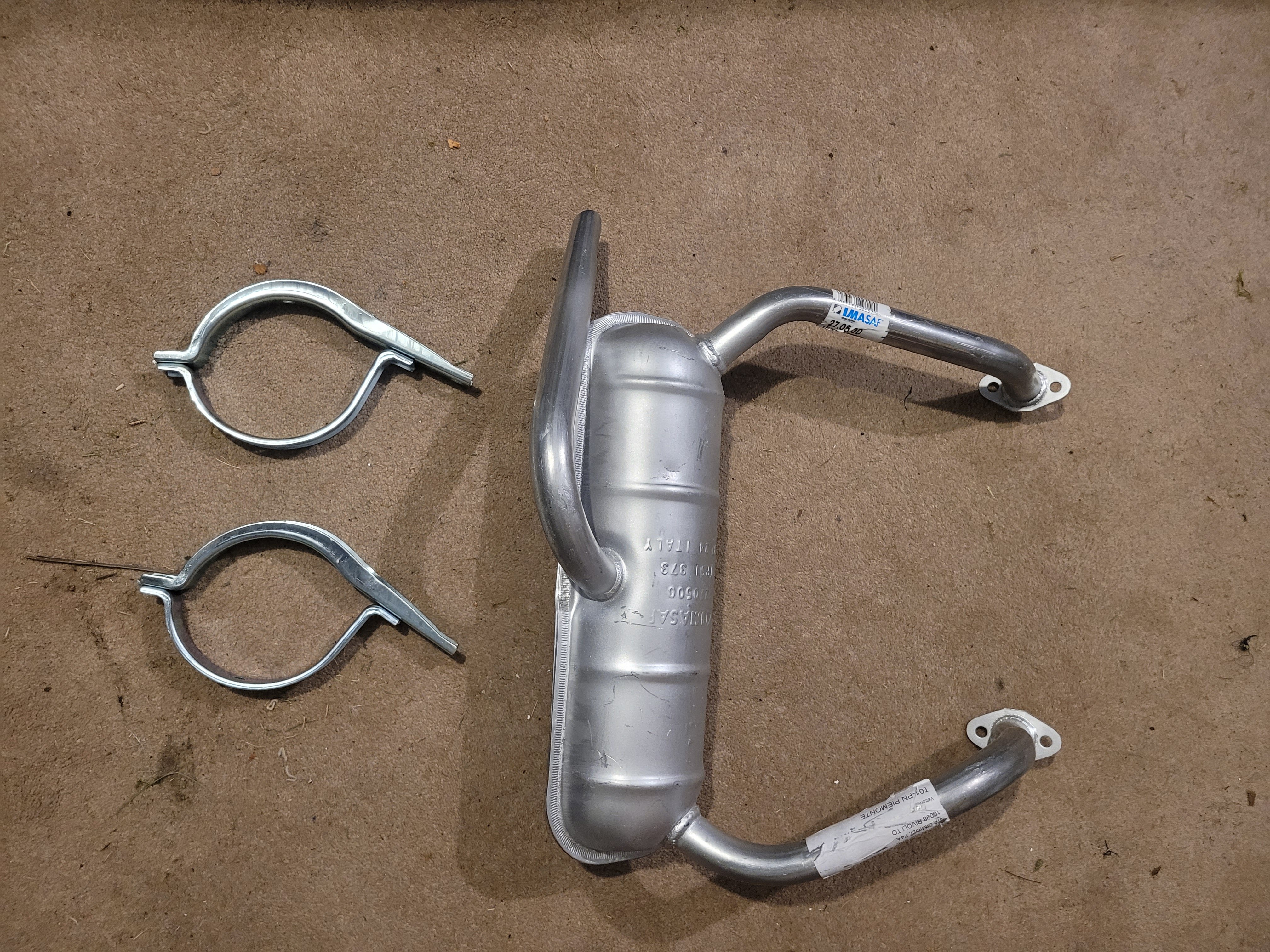

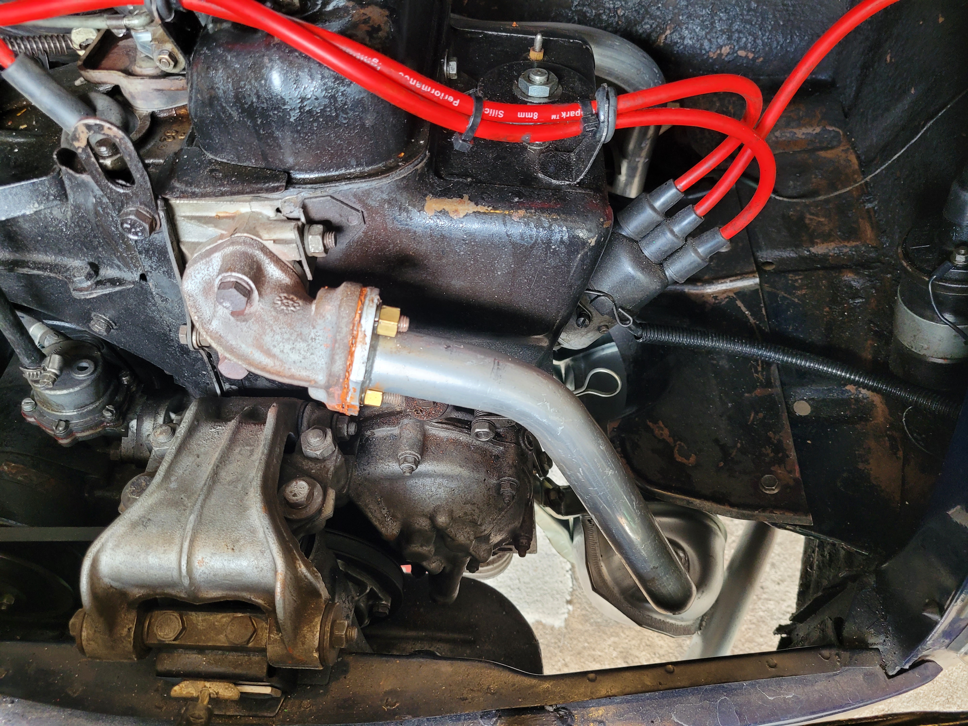

All fitted and tightened up in the right order (though it was a hell of a job to get the top halves of the brackets on...) A quick run out to check and all seems good 🤞. I'll leave it to cool down and check the nuts/bolts (new deep brass ones for the exhaust to elbow joints).

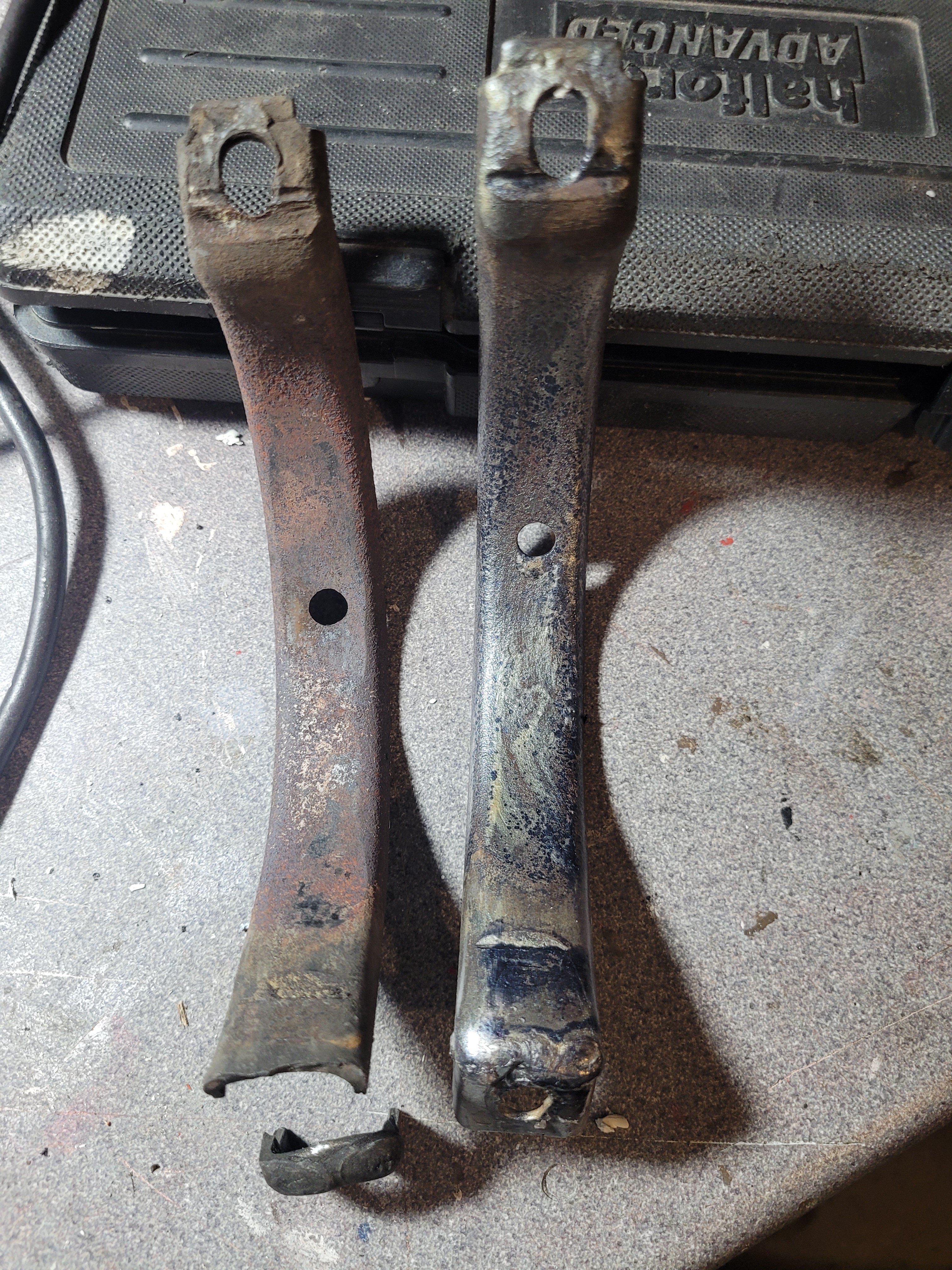

btw, looking closely at the broken bracket, I could see that it had been welded previously... also the non-broken bracket had a weld on it, so I replaced both with new ones. It looks like the old ones had both given way at some time in the past, so well worth the peace of mind to replace them!

But you know that the exhaust pipes have to be stress-relieved? (I don't know the exact term in English - in German it's called: spannunfrei glühen)
Do it with both pipes.
If not, you will quickly get the same result as with your old exhaust.

Yes, but then the pipes are under a lot of tension and the exhaust breaks just like your old one.
You can see that the material is still good. Why would it be broken?
Try it out!
Hi Roger - I've never heard of that for exhausts before. I did tighten everything up bit by bit...
