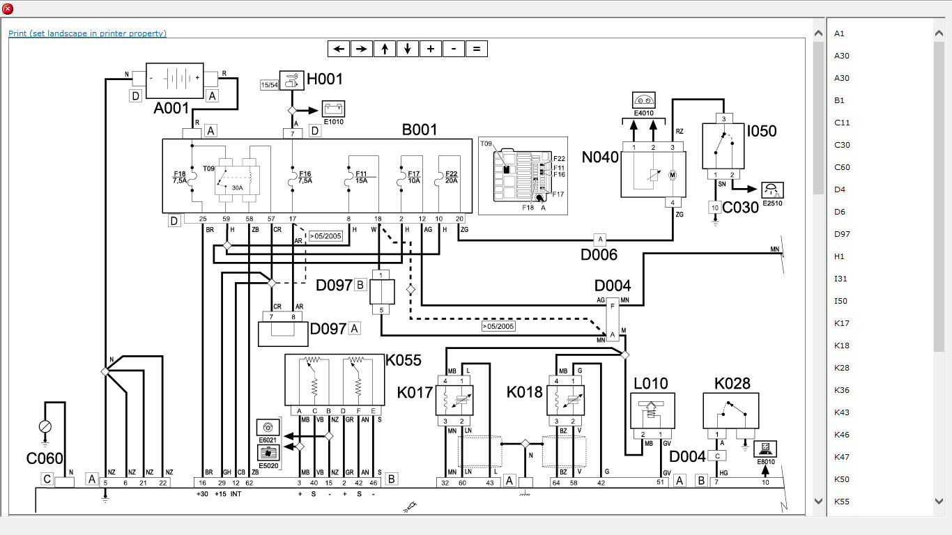

Actually, I would still presume the fault is the actual pedal assembly - the ecu would be my last suspect, by a long way.
The wiring is a possibility, but ... if the pedal has malfunctioned both tracks could be damaged - anyway, here is the connector, and here is the diagram, so with a reasonable multimeter you can test the pedal...
It also gives you the pins on the ecu to do a continuity check of the wiring IF the pedal tests ok - .
I would, at this stage, go for pedal check first - its an easy one to do .
You should have the same resistance across the main pot terminals A and B
and also D and E, then you should have the wiper value varying with pot movement on pin C for Pot A/B and also on F for pot D/E
measure reisistance from A to B and then from D to E first, that is the pot value and should be equal - not sure of the value - probably 1 to 20k ?? - and fixed.
then resistance from A to C AND from B to C is the wiper, and should vary as the pedal is moved - apart from being in the reverse direction, the resistance should vary across the range from BOTH A to C and B to C.
the same test for the second Pot D-E with wiper F
this can be done of the car.
There is a resistor shown in the wiper circuits, but I expect it is small, it is to stop the output being connected directly to source or sink.

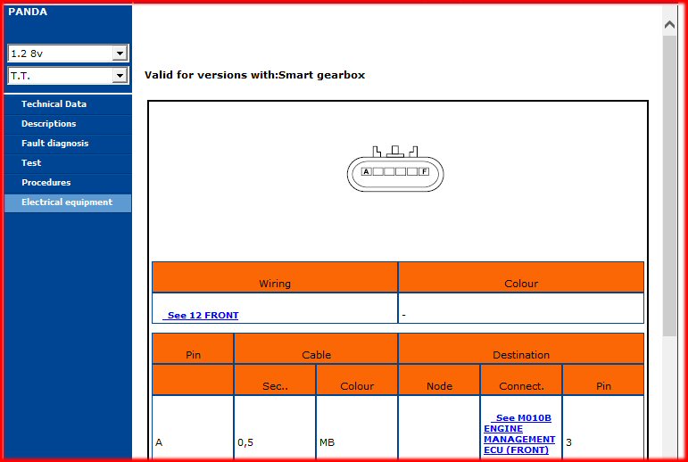

On the car - test for power at pins A and D of the throttle loom connector, and ground on B and E
refer to schematic. EDIT - Throttle is location K055 !! - the two potentiometers can clearly be seen.
hope that helps.
Cap.
