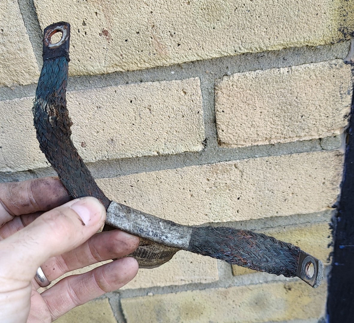

So, that was a great suggestion...I have more or less full battery voltage at the block, both with ign on, and cranking. all the warning lights (apart from immob) do come on, but go out again. Intermittently it's showing a high coolant temp warning, but the engine is cold so that must be spurious (and wasn't happening yesterday or when the issue occurred).
I'll check the Battery-Chassis earth. I have loads of spare cables anyway as i've been setting up leisure battery + solar in the van recently.
Earth strap...looks tatty but not falling apart. Kicking myself for not just shorting it with a jump lead before pulling it all out to check, but can't see the point in reinstalling it in this state.
Anyone know the CSA on the factory one so I sort out a replacement? I have some 25mm2 cables I can try for the time being and replace with a braided strap later.
I'm till very confused what could have happened mid journey to cause this.

Just hooked up a 35mm2 Battery cable in place of the earth strap, put battery in loose and it fired straight up (albeit with a engine check light)!. Hopefully that'll clear once i've bolted it all back up properly and done a few cycles.
Thanks all! I'll order a 25mm2 Braided strap to replace the old one, hopefully that's sufficient.

Jump as in battery jump leads are very hit and miss on getting a good enough connection to carry over 100 amps, which is why it's not a good diagnostic test, but great for getting you home, I have tried the lifting eye and failed, probably the paint. The gear selector bracket works

You have the main large earth from the battery to the chassis rail
Then the chassis rail to the gearbox
All the other earths are much smaller and rarely give any problem, normal gauge wire usally plugged into a little black box bolted to the body,
The only other that gives trouble is the power steering bolted directly to the top of the battery negative post, it doesn't ever need replacing but the ends sometimes news cleaning up with a scotchbrite pad or similar.
Cause of the failure when the car was stalled was probably the sudden movement of the engine and gearbox due to torque reaction as the clutch came up breaking the remaining connection of the lead.
Taking the lead out to clean the braid is a waste of effort. If it starting to look frayed just fit an new one.

OK.. I will post this IN CASE it is useful
I am 90 % certain that Braid isn't factory..
So am left to summise your factory Black cable. BATTERY CHASSIS G. Box is probably useless.. and the braid was added as a Stop. Gap🤔
The factory black cables get moisture in and the Copper innards turn to green mush.. 😕
Fiat keep changing the design
My 2011 is braided
My 2005 and 2006 had black leads sealed at the end so they could never give a problem
Earlier punto were a black cable with open ends, water entered the cable and they rotted from the inside, this type gave a lot of trouble, I don't know if they were ever fitted to the early pandas
So fiat had a problem, fixed the problem and now back to problem to be fair the braided normally look bad but still work well past 10 years,
My 2011 is braided too. It looked rough but was in decent enough condition when inspected. I have cleaned it and greased it and expect it will do a long time yet. The gearboxend fixing bolt and the lug to which bolted however was in bad state and required more attention to make good.
