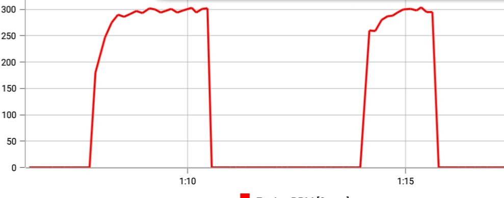

Does your panda have a rev counter
Do you have a scan tool of your own
Hi, yes the scantool just reports errors with the cam and crank sensors, but both have been replaced and timing checked..
