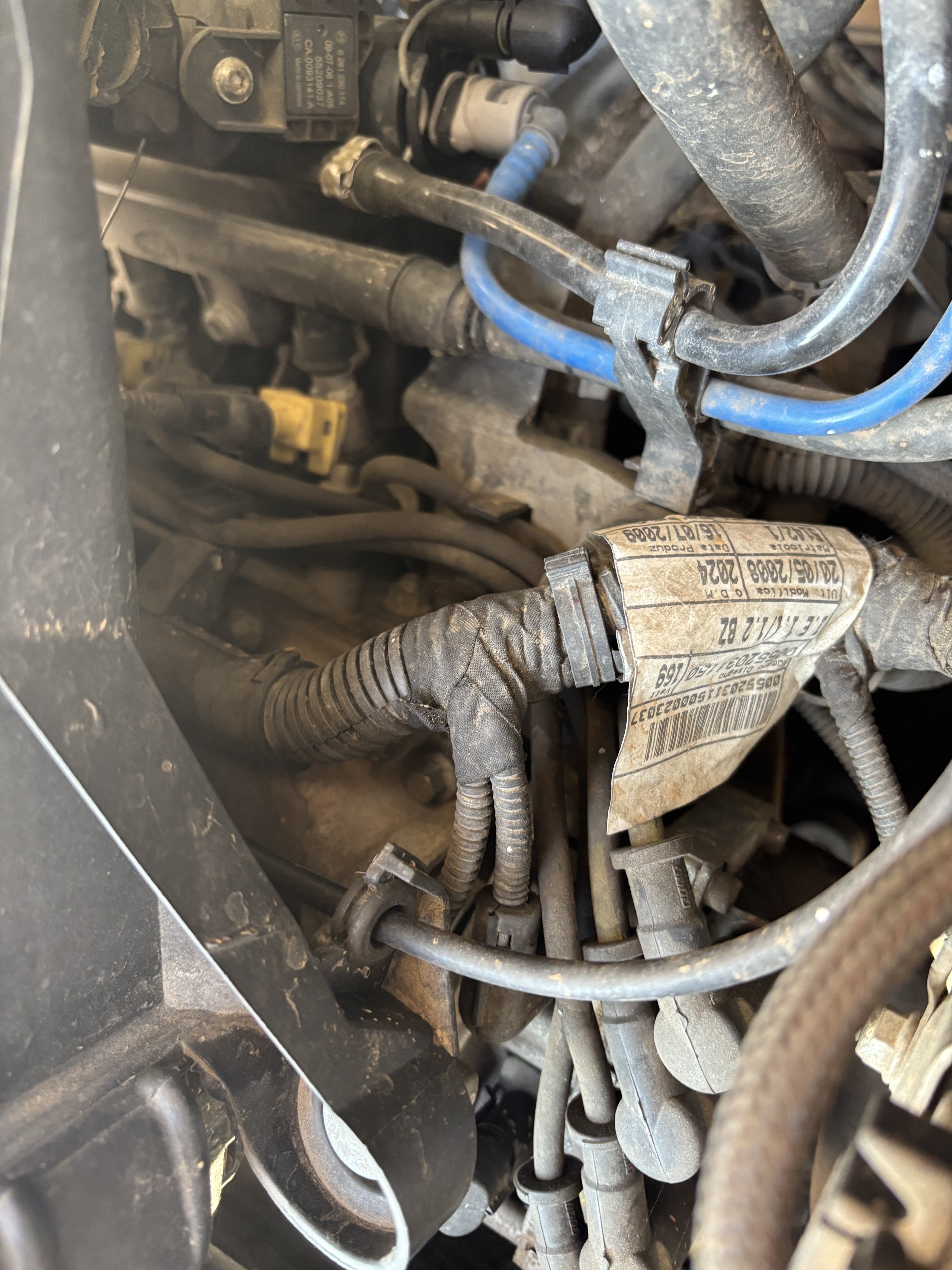

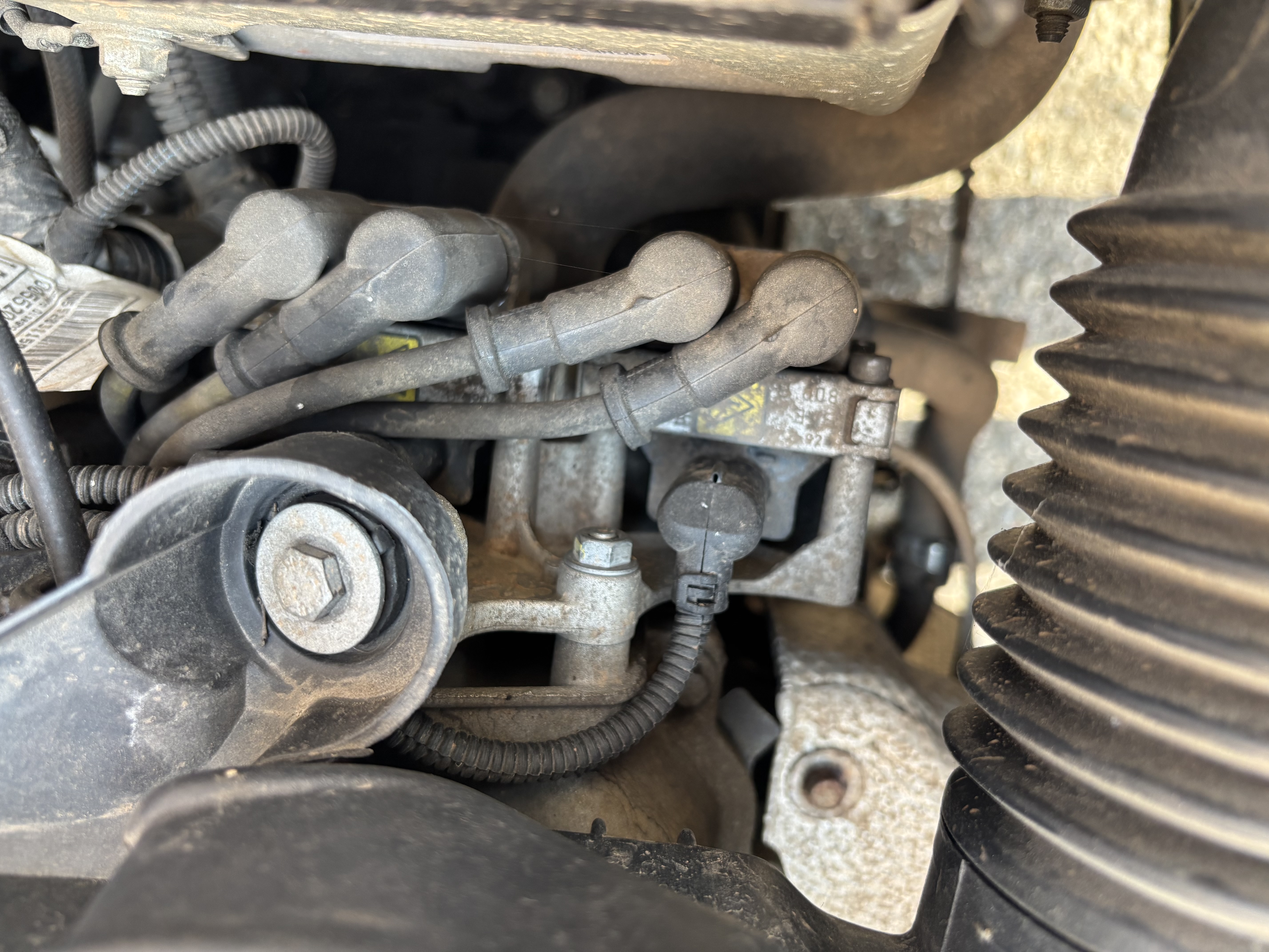

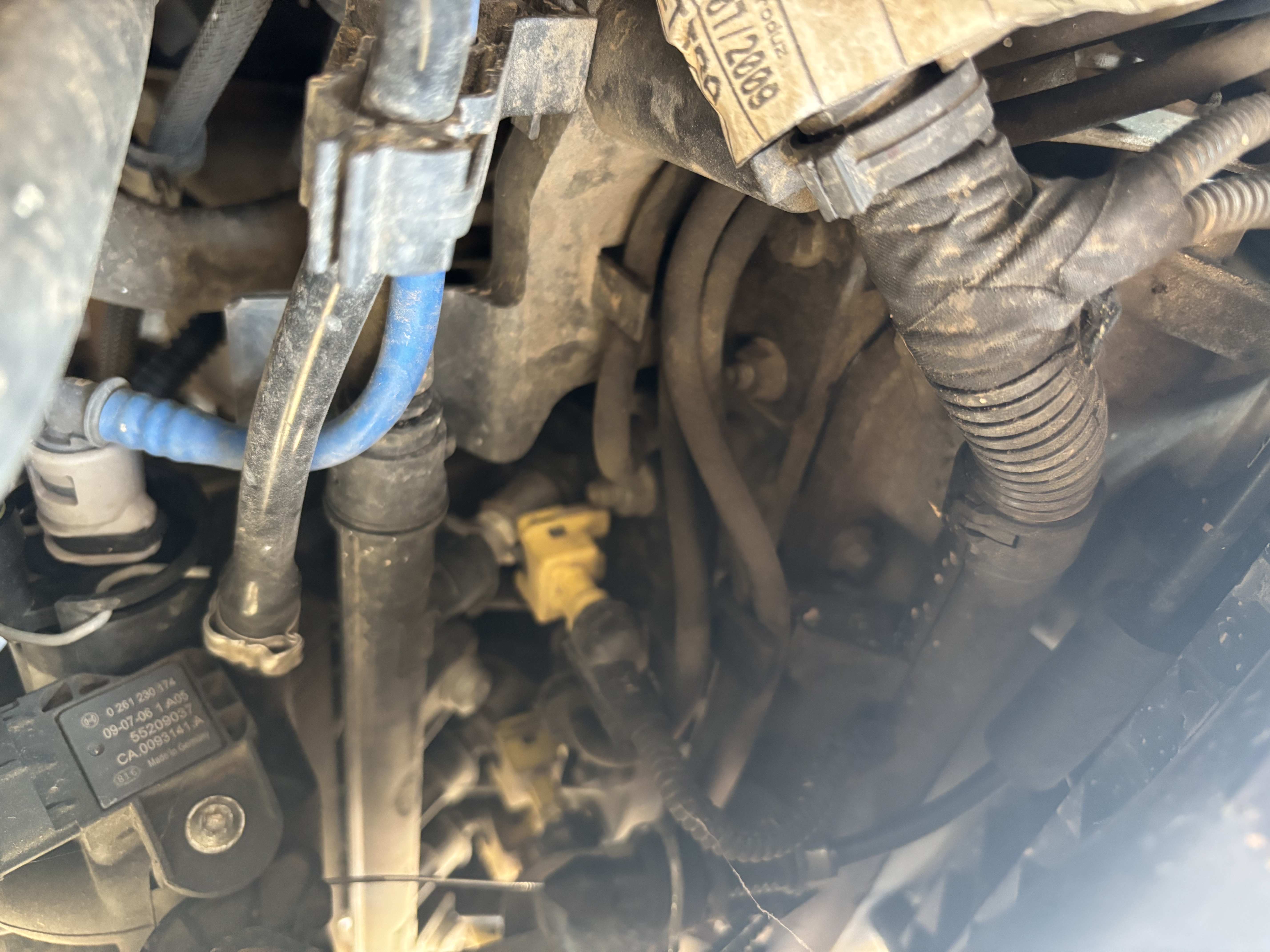

If you can take the air box off and post a picture,but makes a big difference to how we go about the issue
Hi, thank you for your help! I didn’t manage to take off the air filter, but I took some photos around it, hope it helps just a bit:

I have inspected the cable bundle leading to the engine compartment fuse/relay box, however I didn’t find any signs of external damage to cables, but I still used the insulation tape (just because I didn’t think having cables in the engine compartment without any protection is a good idea :D ) I have also disconnected the battery and cleaned the pins + cleaned the earth. I have also inspected the engine compartment and didn’t find any loose cables/connections (but I’m not saying my judgement is 100% correct).
would also start the engine and open the bonnet. Then move along the harnessing and wiggle it as you go (including around connectors).
Tried that with the bundle leading to the engine fuse box, engine was working properly and didn’t stall
