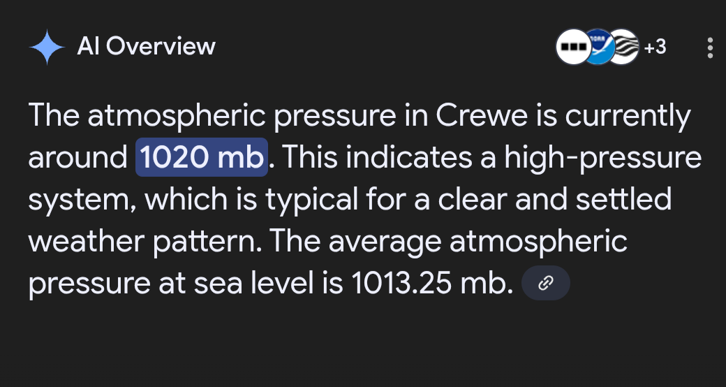

the miss fire or juddering is intermittent some times at tick over sometimes under load no pattern to it, have noticed that the inlet manifold preasure sensor reads 100KPA without the engine running?
Correct
That's what atmosphic pressure is at roughly sea level
So 102 kpa here now
