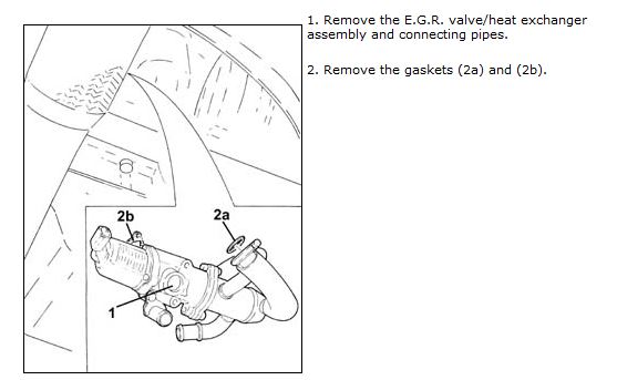

Hmm there seems to be 2 coolers... one between the turbo and the inlet manifold (after cooler)
and the EGR cooler.
both streams feed into the inlet manifold and difused (mixed) after that point. So the EGR cooler would be between the exhaust manifold and the inlet manifold.
The after cooler could be full of blowby oil from the breather circuit, the EGR cooler full of whatever come out of the engine and blocks the EGR.
Don't think you can get clean air into the inlet manifold by taking a pipe off the turbo as only the air filter is before the turbo, and would have no impact on either cooler.
Before all that the code reader would probabley be a good start point as I could be a mile off... could be a something totley different like the map sensor for example. diagnostics is always better than swapnostics.
Hi all, thanks for the replies, I have scanned it, no codes stored..... I am leaning towards the egr gas cooler being blocked...am going to attempt to extract it tomorrow.
I pressurised the intercooler and associated pipe work with compressed air and couldn't find any leaks.
I will take the gas cooler off first then go from there, thanks all again!

PS sorry I didn't manage a pic of the EGR gas cooler as I only removed it far enough to get the compressed air through to blow the soot out . ... but the method was compressed air down the pipe that goes to the inlet manifold..... lots of soot came out!
