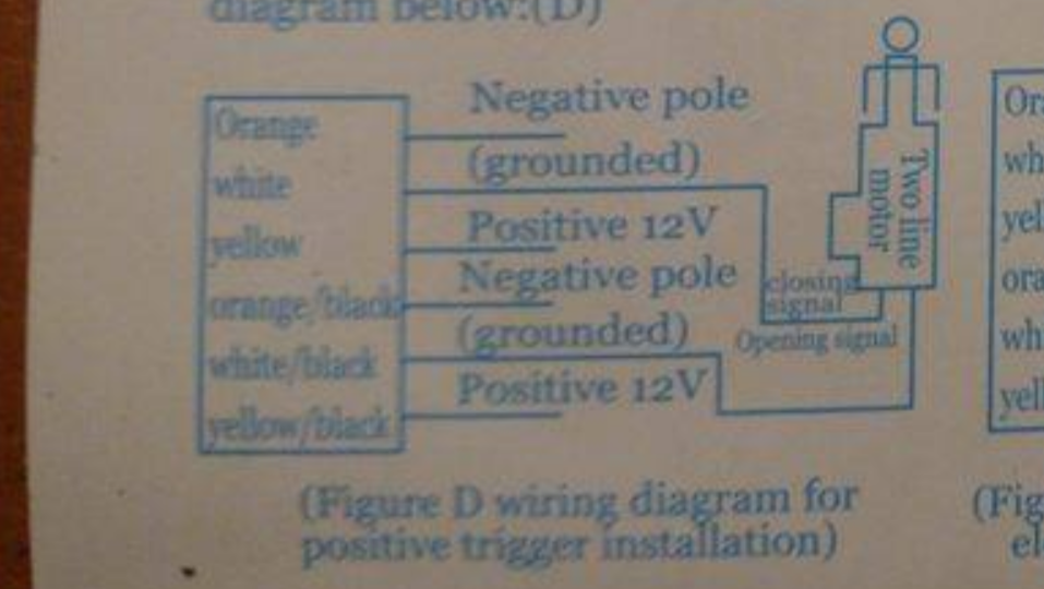

Assuming the remote locking kit is similar to this one
You can control it directly a without bothering with anything else
Thank you koalar, actually had already wired it in this manner and it works a treat. Now the real test is how do we get the tailgate to work???????????????my kit dose have the extra button and trunk wire,thanks for your time koalar much appreciated.
