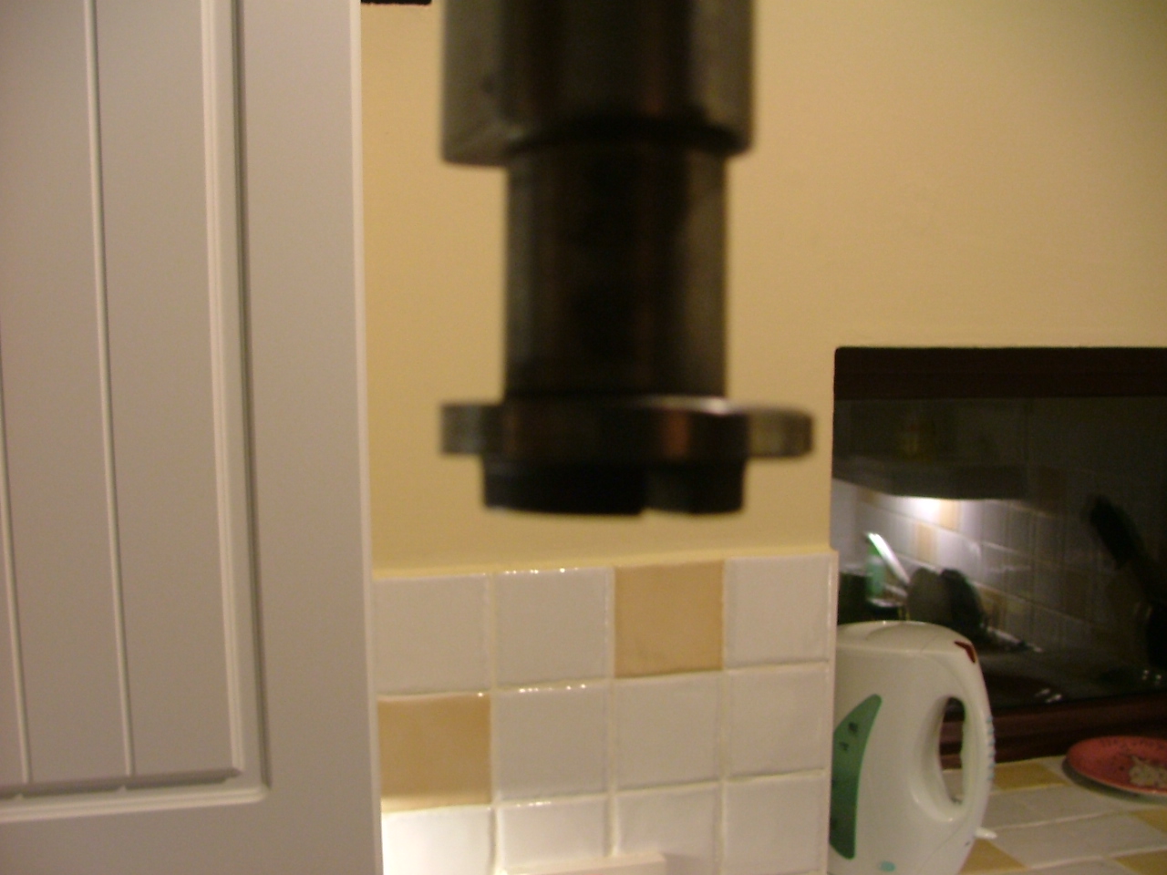

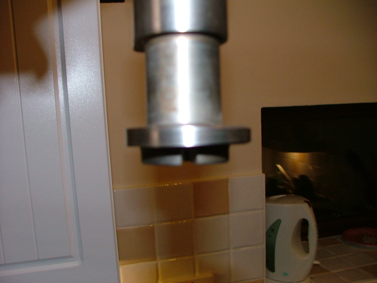

Good! we want a nice clear close up of the lobe.
I'm still tying to figure out:
1. Why is there a lobe at all when the engine shouldn't need one?
2. Should the lobe be 'egg' shaped or round and just offset?
No socks:D !!!!
Think it should be round and offset, not egg shaped
Sorry for keeping you waiting, dad still not unpacked his bags so had to go rooting
It still looks round in the pics - no socks but slippers :p
compliments on the footwear, and yup it's not got the fuel pump offset on it at all... you'd need a suitable electric driven one... preferably with a built in pressure regulator.

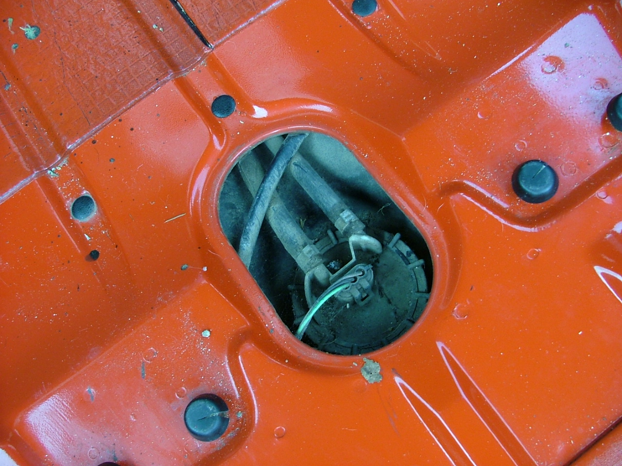

Under the sound insulation under the rear seat.... there is a plastic cover with access to the fuel tank connection hoses and fuel guage sender.
Why not bolt it on inside the car and make a cover for it?:idea:
Here:
and here:
