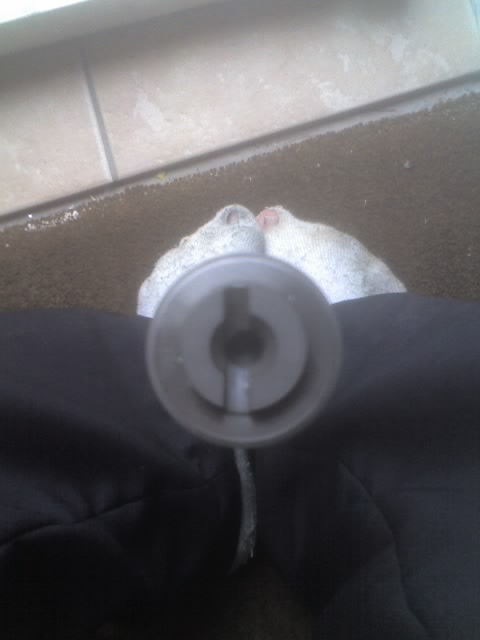

Can you tell on this pic if it got the petrol pump lobe?

i thought the slot across the bar powered the distributer... that thin rail presses the pump rod (phnarr!) against the diaphram in the fuel pump... i didn't think it touched the distributor at all...

I mean it's what the Oil seal sit's against. But after Gaz post we know it's not for the fuel pump.
Gaz just one question to confirm. You say it's round but does it sit exactly in the middle of the cam or is it slightly off to one side?
gaz_wrexham said:
that bit at the end aint a lobe, it round :(
it only moves the rod a small amount... you'll really only be able to see it if you are looking for it from end along the length... you'll notice if you look hard it's not central if it's the fuel pump thing
It looks round. I noticed that there is an off centre line, what is all that about.
See pic , ignore my holy socks ;)
hard to ignore when they're the bit in focus... should have bought some socks not the cam (y)
Gaz as for the socks PMSL :D :D :D I'm sure my lad has a wardrobe full like that, when he stayed here they kept finding their way to my wardrobe :mad:
On topic, no that will not work a mechanical fuel pump. The off centre slot is for the dizzy so it can't be put on 180 deg out.
