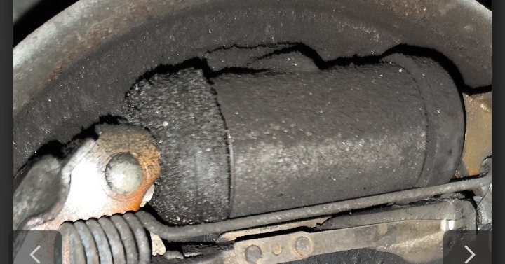

Normal
Weeping
When they start weeping. They can carry on for ages like this, if left undisturbed. But they normally start leaking properly within a few months of having the new shoes fitted. Covering the new shoes in brake fluid
In my opinion you are better changing the cylinders now

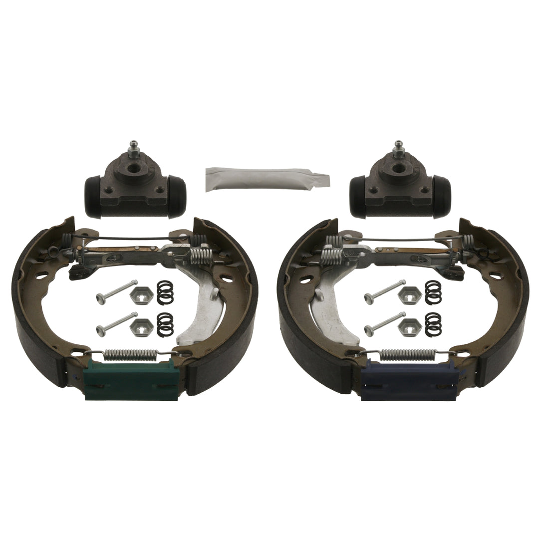

It appears you have the correct shoes.
You need new correct adjusters and replacement spring/s for any broken springs plus at least one wheel cylinder.
Look at the photo of new parts, note the shoe lever position - this is the correct position with the hand brake released . On your car someone has tightened the hand brake cable far to much(probably because of broken adjusters)
That type of adjuster is fiddly to fit without removing the hub......as you have already removed a hub assemble adjusters to shoes then fit to car then fit hub.
