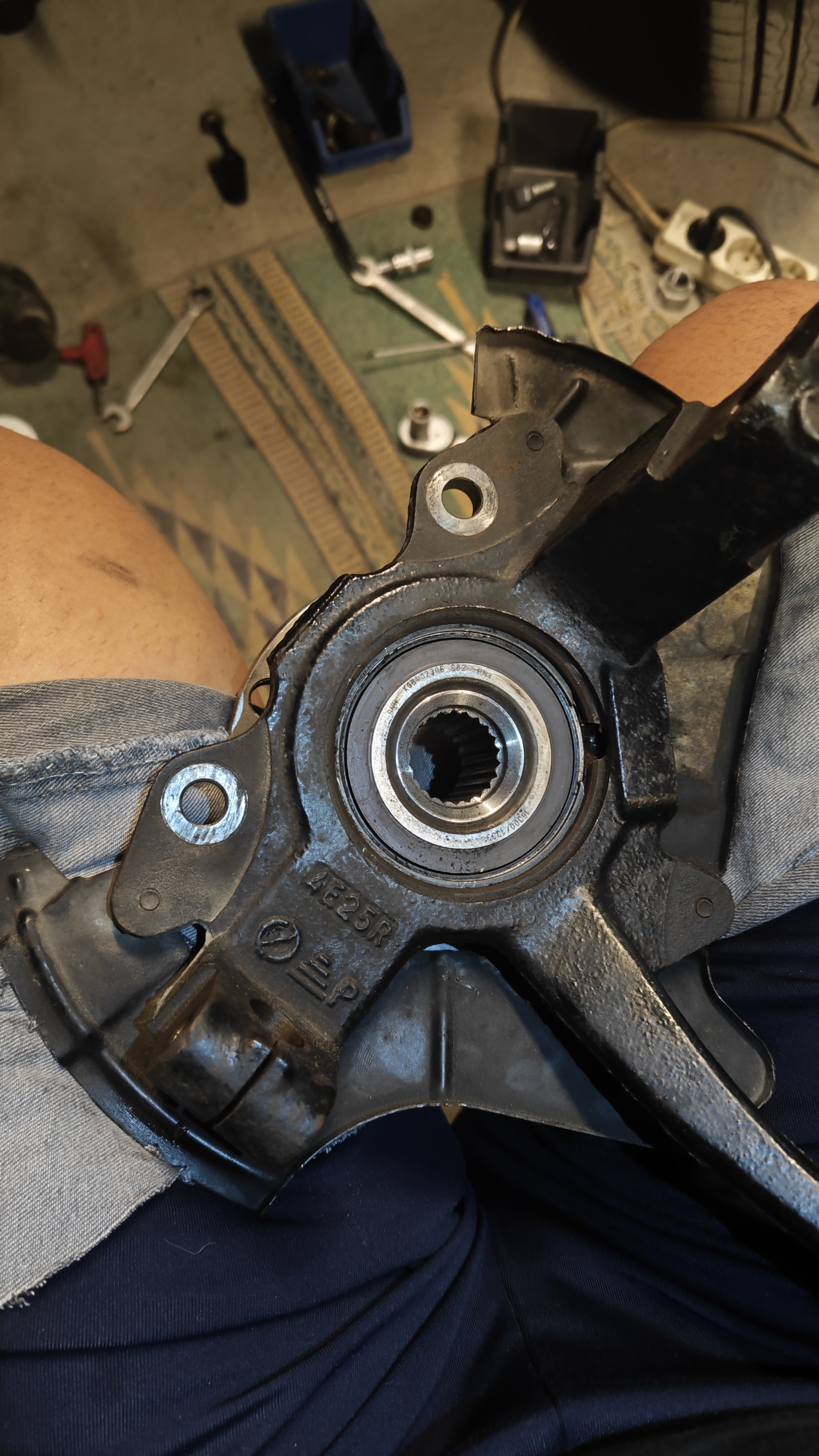

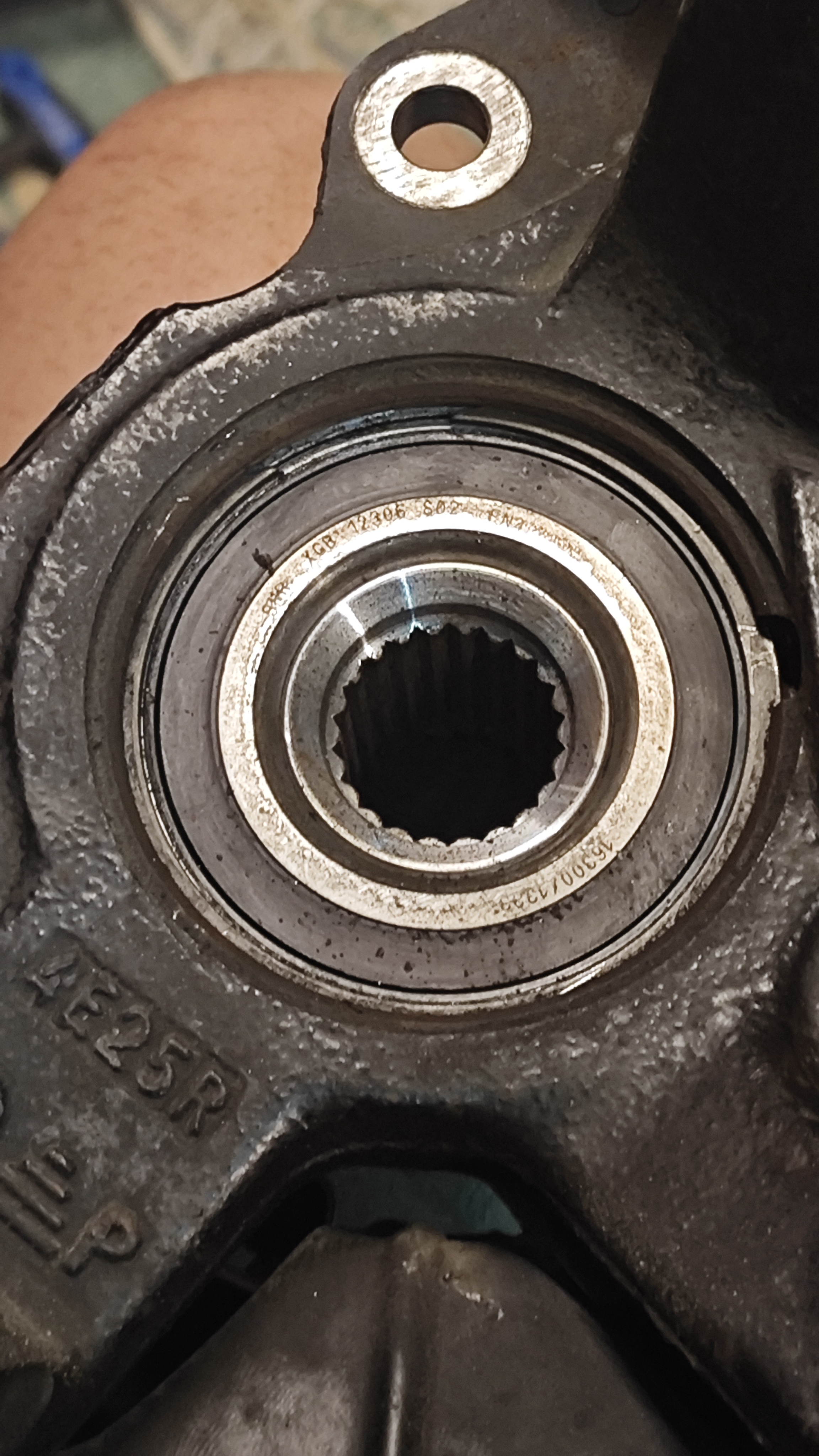

After replacing the hub, the ABS light started to turn on at a certain speed. Also, at low speeds, the brake was constantly beating as if the tire was locking (until the ABS was disabled).
I noticed that the ABS speed sensor was not reading so I removed it again.
The master who installed the ring on the press.
He didn't pay attention to his direction.
When I took it apart and fixed it, the ABS started working fine again.
So I assume as the mechanic had fitted the circlip ring in the wrong position it stopped the ABS sensor going all the way in to read the magnetic ring on the bearing.
Glad it is all sorted now.:)
