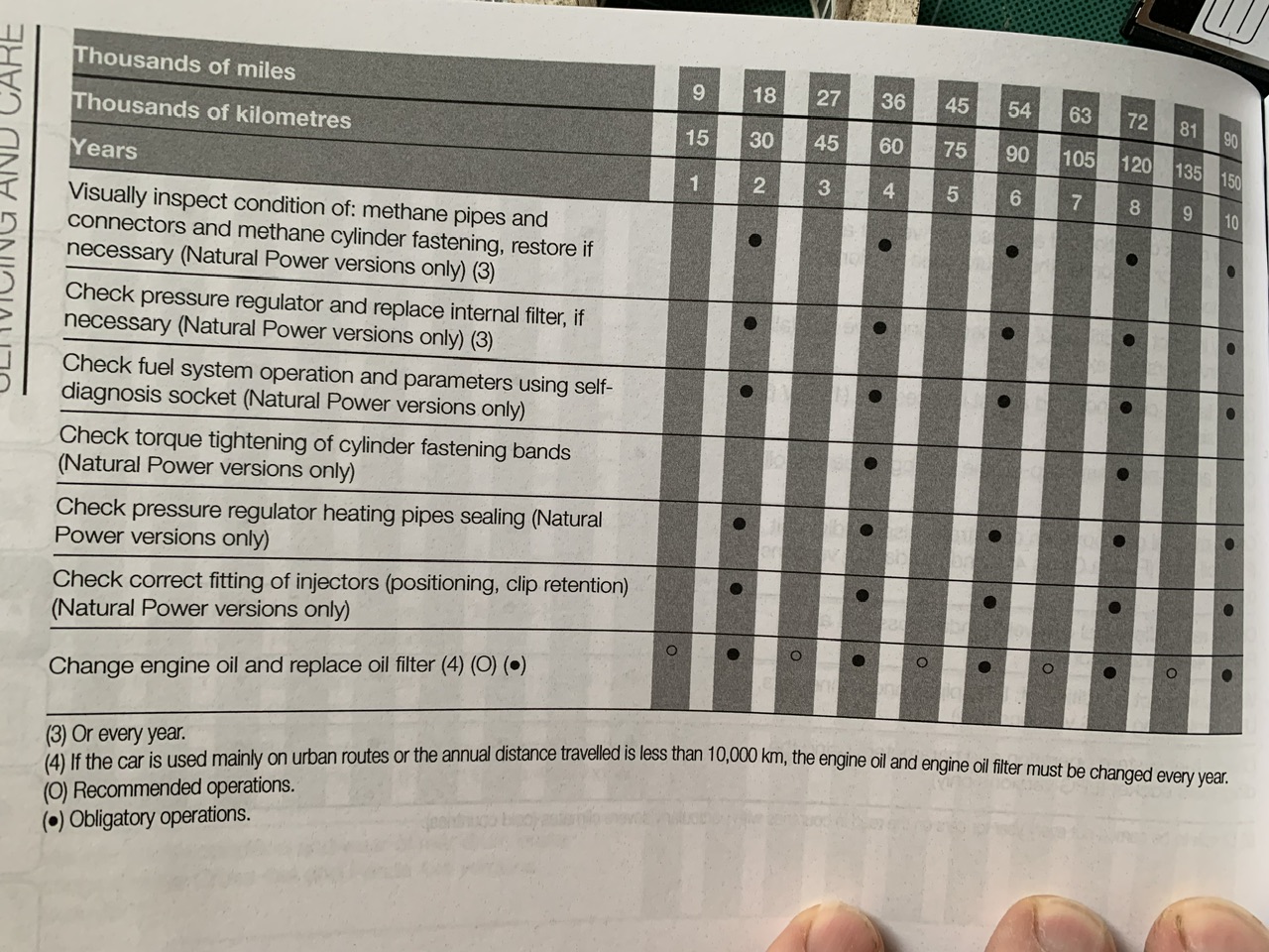

Technically Fiat changed the inspection interval from 18,000 to 9000 miles (or from two years to one on low mileage cars) ... the specified oil change interval is still 18,000miles for the TA, except on lower milage cars where they recommend an annual change. For cars travelling less than 10,000 kilometres (about 6000 miles) a year, or low mileages but mostly around town, they specify it must be changed annually.
Everything else listed at the newer 9000 mile intervals is just 'have a look' - nothing is changed at these intervening inspections (unless, for example, brakes are wearing thin). I call it the 'Paddington Service' - it's all just a hard stare! They changed it because in some cases cars were going two years or more between a service and that was leading to all sorts of issues.
That's said, especially with the TA needing to be well looked after, Id be changing my oil annually if I had one.

I do less than 4000 miles a year (a lot less) and insist on an annual oil and filter change.
My TA - new in June - has a Fiat service pack and service desk confirmed it gets an oil / filter change at every 9k service.
