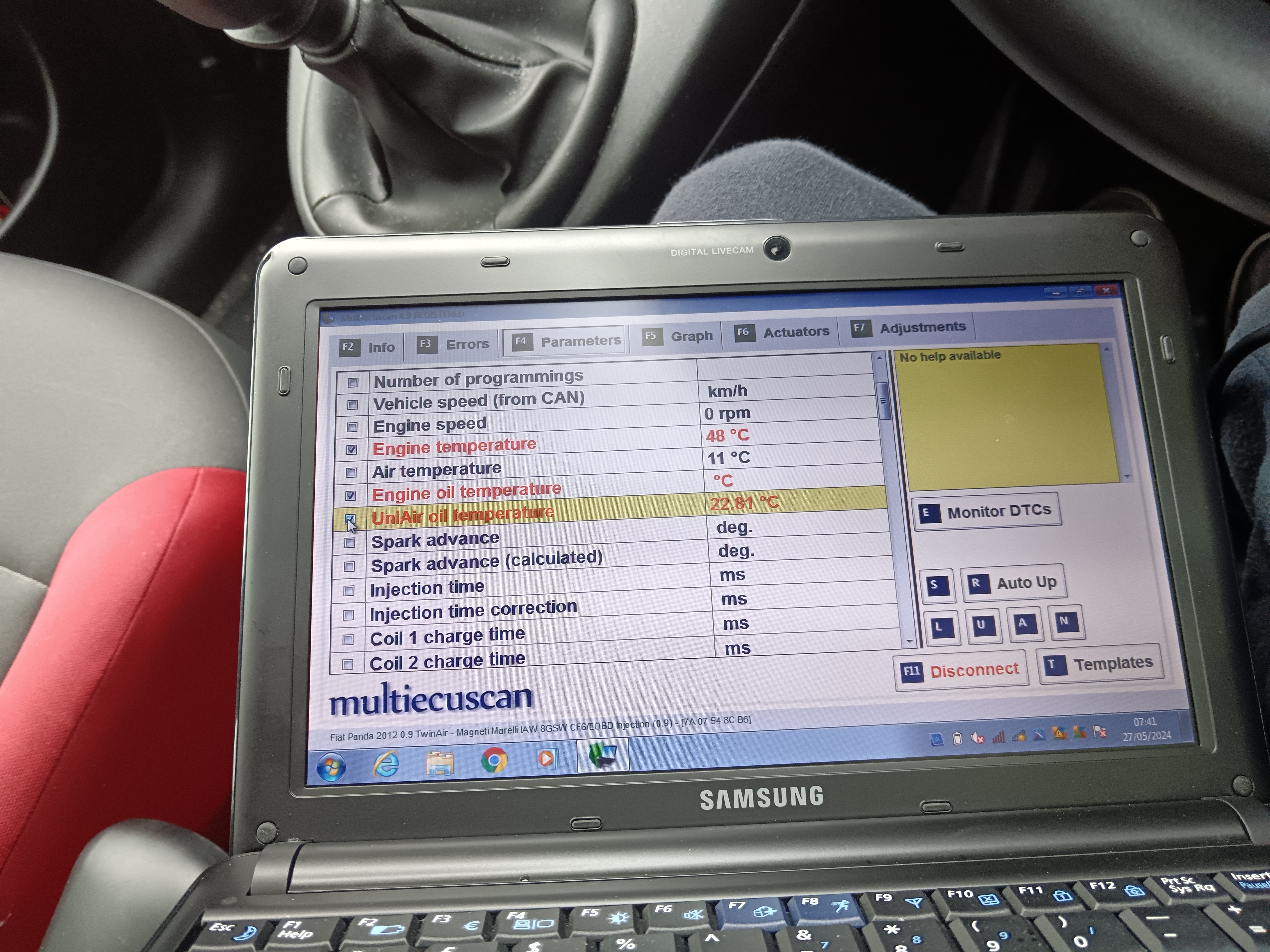

Have you actually had MES on when the problem happens to see the live temperature? Swapping the solenoid connectors and doing the "ticking" test only showed me anything on a stone cold engine. The engine sump is alloy with fins so it must also contribute to oil cooling . TBH I havn't thought /looked at the oil cooler below the main oil filter but presume it has engine cooling water through it. So an issue with the thermostat could be a factor.
No, not tested 'hot",
But today in Stone cold temps
I tried to activate both injectors.. All good
Checked temps.. All look sensible
Warmed motor from cold, again temps climbed in a controlled manner
Info : at point of failure while driving, stored errors were at a temp of 85'c, which sounds normal
I will plug into another TA this week to see if it "looks" any different
Maybe the different ECU's will display differently though..

Just read through the whole thread again. My 500 TA has Uniair oil temperature at 84 deg.C when up to temp. May be it was it 85 or 86 it was 5 mins after I stopped when I plugged MES in.
