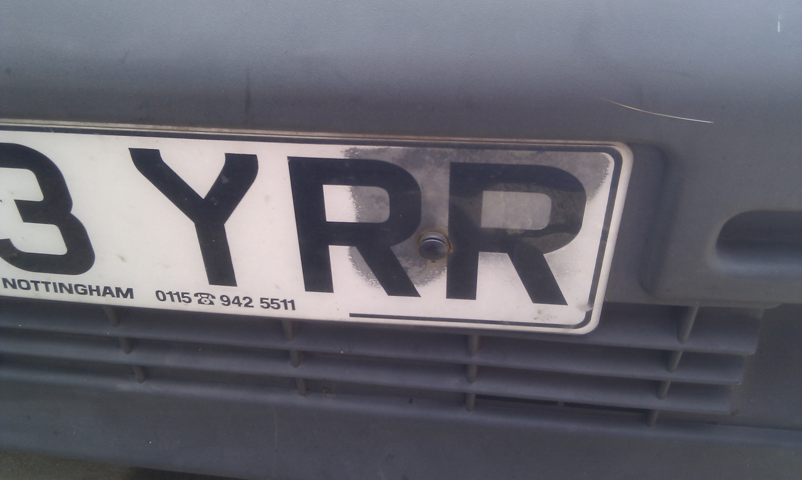

What about cloudiness/delamination, even though it's still legible?
And a black screw cover in the wrong place, even though it's clearly not trying to modify a character.

more likely to be failed becuase of the discolouration, i very much doubt anyone would even notice that black screw as like u said, its not modifiying the lettering etc also i think as long as your font is charles wright (i believ) then the police are not really going to notice or think anythings wrong with your plate. as theyd have to be stood bloody close to ur car to notice writing at the bottom etc. its when your numberplate is italic or something lol they notice,, i think most of the time its at the discretion of the police. Furthermore there are hundreds of german style plates, illegal fonts etc round near me and have seen the same plates like it for years, so either noone has noticed or they keep paying the fines lol....:D
I'm pretty sure the Fiat logo on the plates is illegal and also they're pesonalised on the bottom with a name which is illegal if the plates were made and fitted after 31st August 2002 even though the post code and BS number are in the corner!
On a more positive note, the border is ok though!(y)
