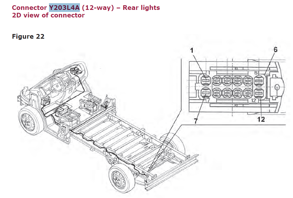

Y203 did not convey anthing to me. Did an internet search. Returned a mention of Converters & Upfitters Manual on this Forum. See Dowloads at top of page. OK it is for X290, but should help. See section 3.26 onwards at page 98.
However if weather allows look under the LH rear of your vehicle for a junction box? I remember reading of a similar problerm being traced to poorly made crimp connections half pushed into the chassis.

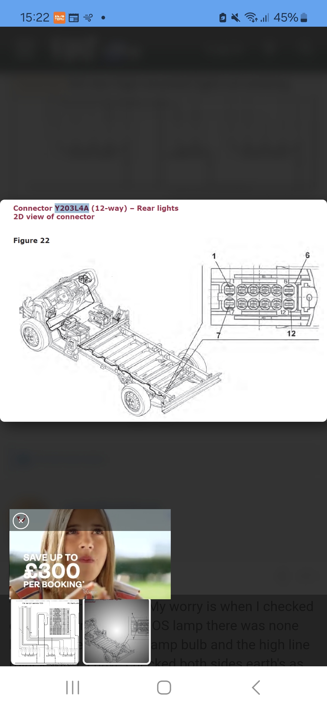

The Y203 (actually Y203L4A) Fiat connector is detailed on page 98 of the converters manual you've already been guided to. Whilst the year of the manual isn't relevant, it's very unlikely it has changed for this detail, and the connector is to the rear N/S of the chassis (diagram on the page above). This standard Fiat lighting connector is used to power the lights you have issues with - only the additional side markers (L16-23) are powered by the Sargent-provided electrics, and I suspect triggered from the converters socket (they'd be too much additional load for the standard Canbus).

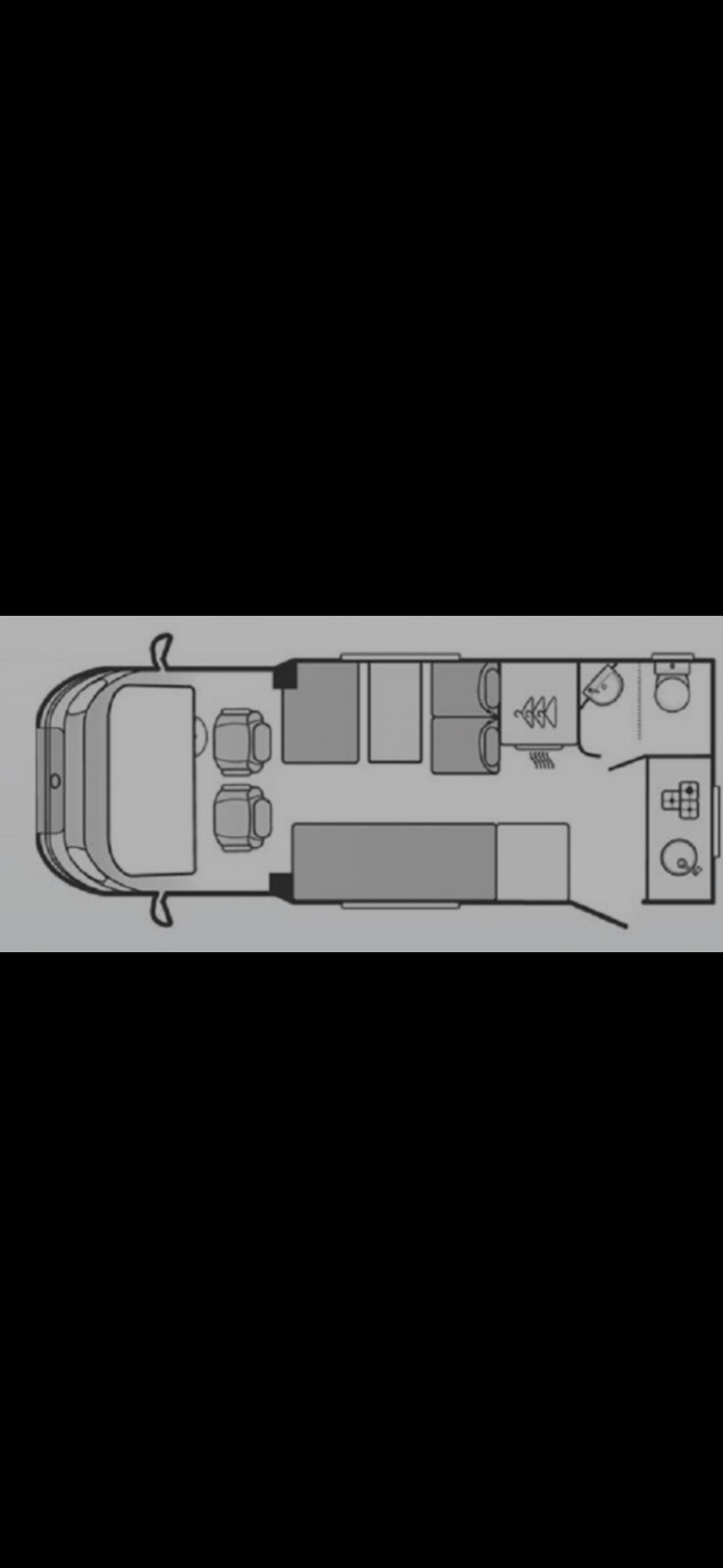

Are you able to mark the location of the 15 way connector on the attached drawing? Am having similar issues as you and I've had 2 garages look at the problem with no joy thus far! My L12 + L11 (n/s and o/s top rear maker light's), L4+L8 (both the tail light's), L9&L10 (number plate light's) are all intermittently working except L10, it's never worked since I got the MH. Am a bit clueless when it comes to electrics but am hoping some electrical contact spray does the trick or am faced with a 250 mile round trip to get it seen by a swift professional!
Any help would be much appreciated
