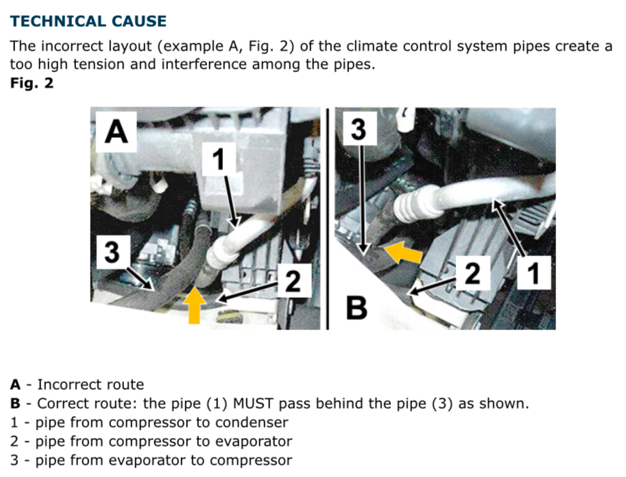

Besides a possible electrical issue, it seems that the compressor will not engage if the refrigerant leaked away.
There is a Fiat service news about possible breaking/chafing of the refrigerant pipes near the radiator when they are incorrectly routed under/over each other, on the 2006-2014 models.
Ok, thank you. I will check those pipes. I did have a mobile aircon guy come and re-gas my aircon recently. He said the gas was already quite full, and confirmed no leaks.
It's probably not that then, but here's the relevant info for reference:
