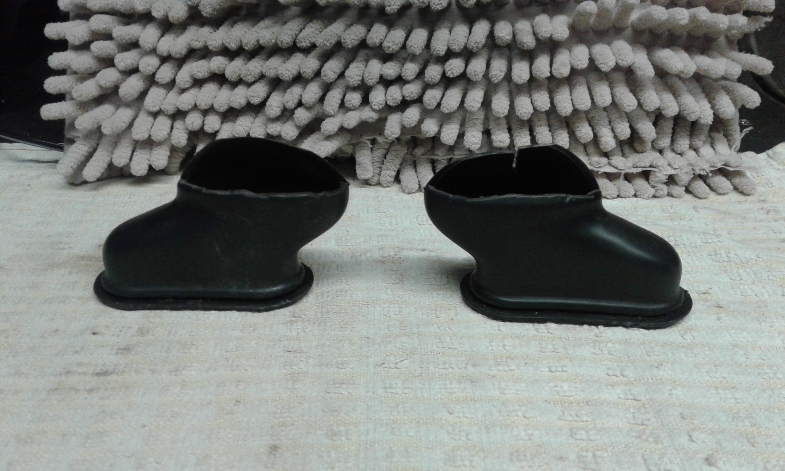

The weather is fine, dry and sunny here in Norfolk, so I thought it would be a good time to clear out the Panda's front scuttle drains. It was a good idea, because both drain inserts were completely clogged up with muddy debris, but are now squeaky clean. For anyone who has never looked underneath the front scuttle, do it before autumn!
Predictably, a few of the white nylon scuttle securing clips had disintegrated, so a new set of those are on their way from S4P. Someone had previously improvised a repair with some mastic to stick the plastic scuttle panel to the windscreen glass - probably a common practice.
Pesky duckbills blocked again even after I cut away a small portion of the plastic some months ago.

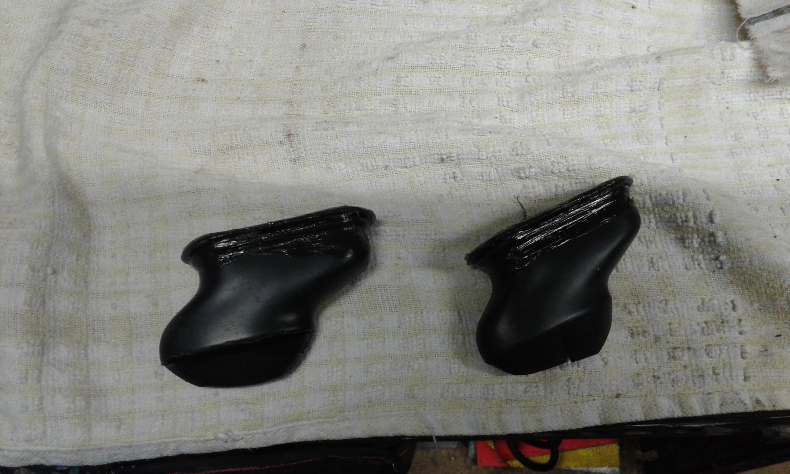

So I've been a bit more aggressive this time as I didn't want to not have them in place. The first pic shows how much I cut away and the second pic shows I smeared a bit of grease around them for ease of fitting. Hopefully this will cure the problem.
